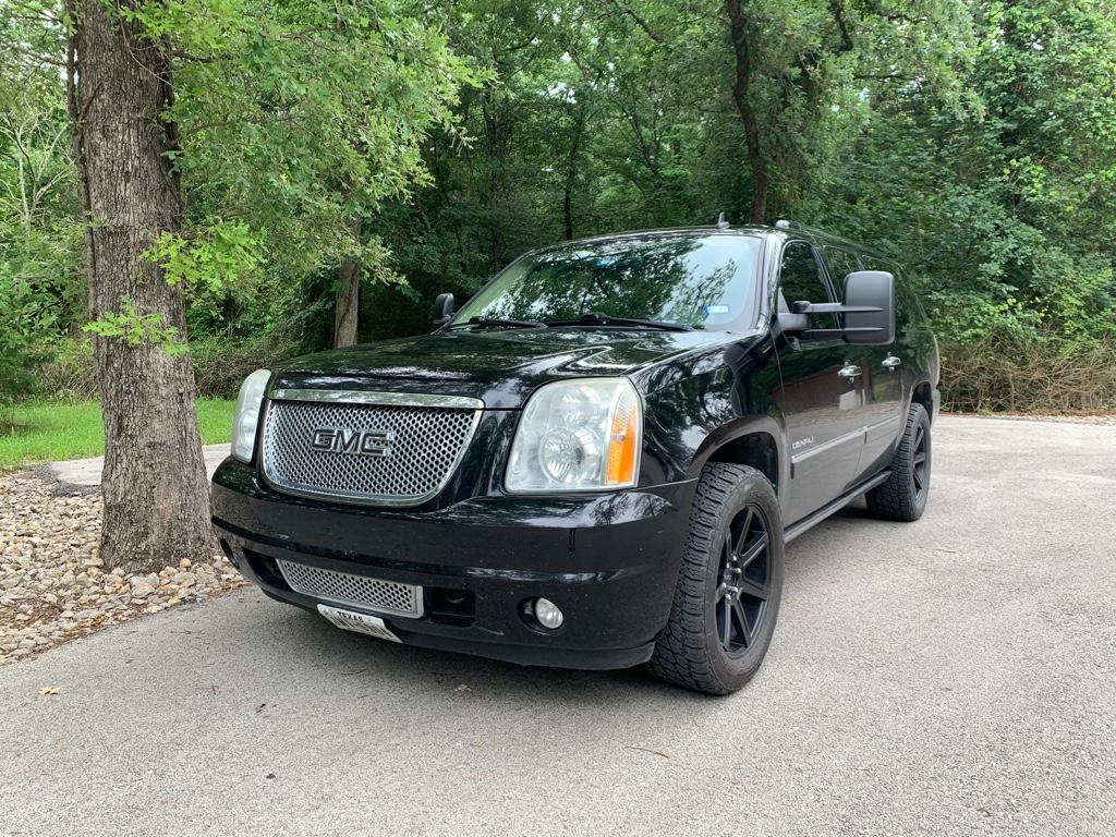

So it wasn’t, but I popped out the grille and cut the plastic backing out and then cut out the same area on the bumper. I knew the Denali’s lower grille would allow for airflow if I did that after doing some looking. The big trip starts in the 9th so I’ll let you know how it does! Right now I have constant 12v to the thermostat so I think I’m gunna run a wire for a switch inside so that way I can kill the fan if it’s still running after we stop and I shut the vehicle off.
Shouldn't need to worry about it. The longest mine has ever run after shutdown is about 60 seconds.

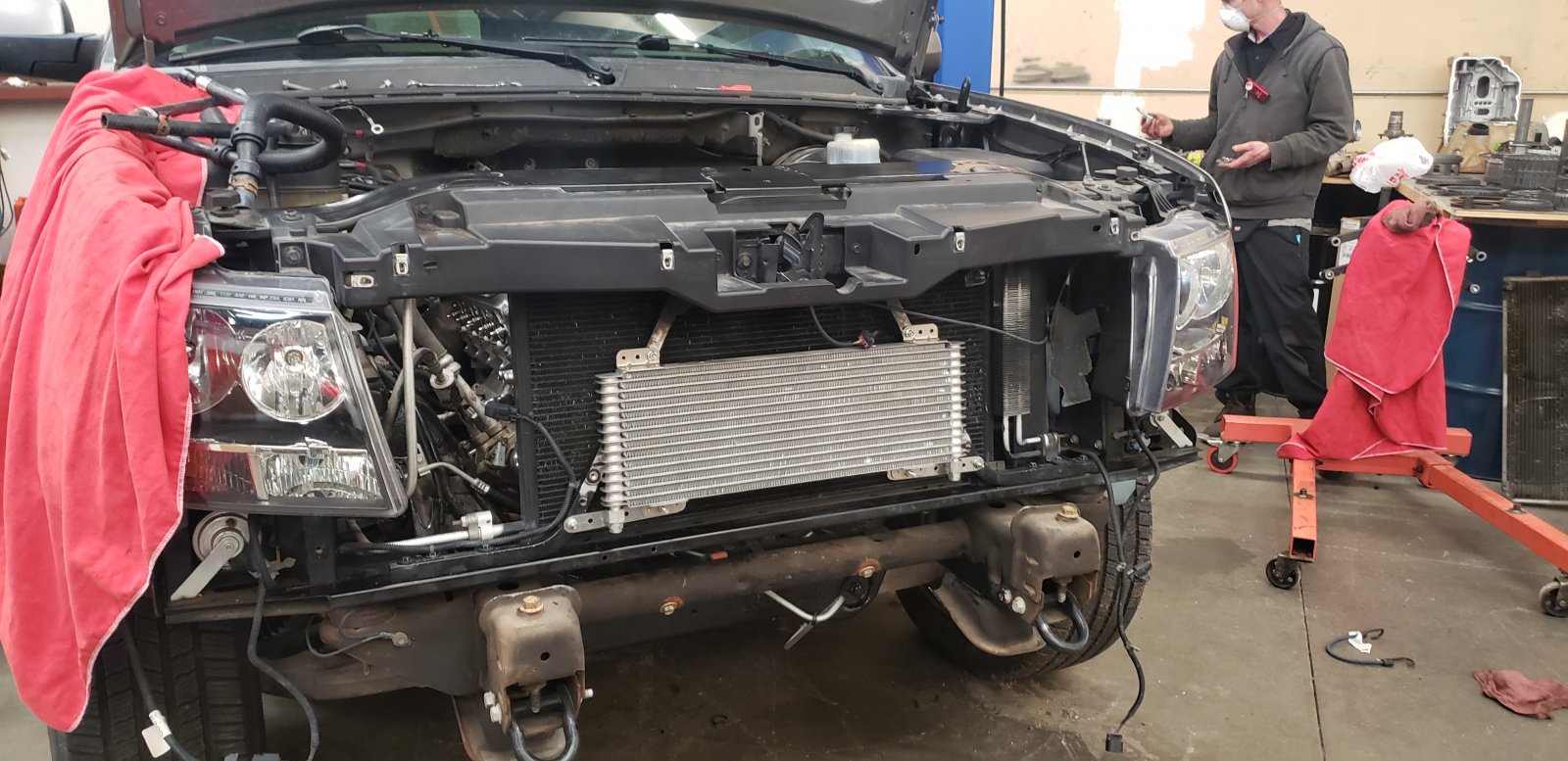

So far, with my set up, minus how the cooler lines look in this picture, I haven't seen trans temps go above 135 in 80 degrees.

I used to have a Trucool 40K mounted in the same spot and the transmission kept cool, but couldn't keep my coolant temps under control when towing in the summer heat. That's why I switched to the Derale mounted behind the license plate.

I have a Mishimoto radiator with mine and so far I haven't had any temps over 200. I live in the foot hills near Boulder, CO and the hottest day it's been is 85. I've only heard my fans go on HI twice so far. It's going to be a hot weekend, I'll take it up the mountains above 10k feet and report how it does. My set up is still pretty new too, I hope everything keeps it's cool. I do have a 4 corner steam kit on mine, maybe that helps a bit?

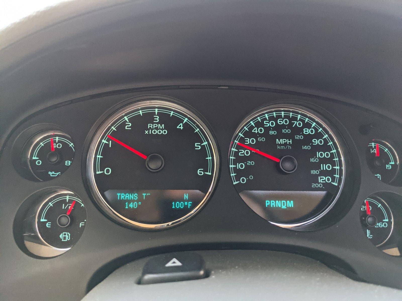

I got these pictures in stop and go traffic. I will go up the mountain tomorrow. Highest my trans got was 145 today and it was 97 degrees out. My fans did kick on to HI 2 or 3 times though. I also had the A/C blasting.
I didn't hook up my tech2 to check engine temp, but the dummy gauge stayed at the normal center spot it always is at
Awesome! Thanks for the data points.
We pulled the camper to the beach yesterday and the transmission temp never got above 203°, and only then after I had to floor it for a while to get on the highway in front of a truck. Coolant temp stayed at 195°. That 6.2 really hauls.
