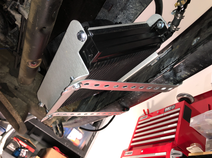

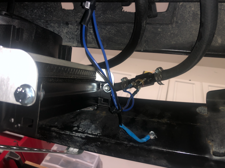

A couple more showing the mounting and wiring from the bottom. I have 2 more straps that will attach to the bolts that hold the skid plate on.
Cant explain the "no power" fuel pump fuse location but given that the fan will run for just a few minutes after shutdown as you have explained in another post id give your install an A+! That looks profesional and will add reliability to your vehicle. As i have commented previously, In order to see the true capabilities of the DERALE i think it should be used as a standalone and not use the factory radiator heater. Another member has installed the same cooler without the radiator so we will know soon enough what the difference would be. Great work!

Where did you tap power? Ign off fan off right? Those temps seem correct if you are still using the radiator "pre heater". How effective were you at getting the max ram air through the lower grill? The trans oil enters the bottom of the radiator "heater", Exit's the top "heated" and flows through the DERALE and back to the trans so temps will allways be influenced by radiator coolant. I have seen "stable" trans temps as low as 114 on 50 degree 70 mph freeway cruising, Which is "ram air" overcoming the radiator heater. My average temps on 80 degree oat are 155 degree's at 70 mph. Stop and go freeway traffic at 80 oat are same as yours approx 175 degrees once the fan comes on. Im going to eliminate the radiator from the circuit this summer and see how much of a difference it will make.
Thank you for the details on your numbers, John. I plumbed it so that coolant flows from the transmission directly to the Derale and then back to the transmission. I have a front license plate in the way of getting direct ram air on the cooler, so the next step will be to fabricate some deflectors from aluminum sheet to direct the ram air coming in on either side of the license plate through the cooler instead of beside it, and rivet them in place. The numbers I'm getting make sense to me though because the transmission temperature sensor sits in the valve body, so it's plausible that it would be 10-15º cooler by the time it gets to the thermal switch on the cooler's inlet port through 6' of mostly aluminum line. Thus, if the switch activates the fan at 180º it makes sense that at the valve body the temp would be 190º+ by the time the fan comes on.
I wired it into fuse #34 (S/Roof - Roof Beacon Relay (TRW), Sun- roof Module (CF5)) which is an 'always on' circuit typically used by police vehicles for the light bar, because I was in a hurry to get it tested and running (state inspection scheduled for this morning), but can easily put it in a different circuit. The fan will likely only run for a minute or two when cooling down anyway, but I would rather have it on a circuit that's switched on with the ignition. Problem is that every switched circuit I tried had no power unless its accompanying relay was also switched on. For example, the rear window defogger fuse wouldn't power up until I turned the rear defogger on. I have the up-fitters manual though so will figure out a better circuit.
One additional step I can take is to wire in an override switch that will allow me to turn the fan on before the temp gets to 194º indicated, or find a thermo switch that activates at 170º. I'll try these after I get the ram air directed toward the cooler better.
All of this said though, I like that this setup is running warmer than the Trucool 40K. With that cooler, I rarely saw transmission temps reach the minimum temp that GM specifies for continuous operation (150ºF). GM is very clear that it's possible to overcool a transmission with oil-to-air coolers, so as long as I can keep my trans temp above that and below 210ºF or so when towing on the hills or sitting in traffic, then I'll be fine with that.
Thank you! Your ideas and photos helped tremendously - can't thank you enough for posting them.
