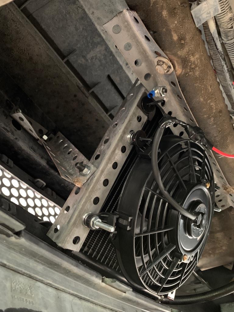

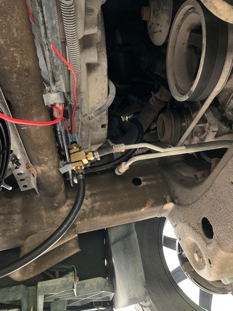

Well guys I got the cooler and fan installed. It has a 180 thermostat to turn on the fan and it shuts off once the fluid hits 165. Currently hasn’t gotten above 172 so we shall see. Don’t mind the janky punched angle bracket but this thing doesn’t move at all.
Looks great! Thanks for sharing pics of your install, too.
Hauled our camper down to the outer banks this weekend. No mountains so never saw transmission temps above 200 on the highway, and only 212 in traffic. Planning to make the mods to the lines this week.
Where did you end up mounting yours again??

So it wasn’t, but I popped out the grille and cut the plastic backing out and then cut out the same area on the bumper. I knew the Denali’s lower grille would allow for airflow if I did that after doing some looking. The big trip starts in the 9th so I’ll let you know how it does! Right now I have constant 12v to the thermostat so I think I’m gunna run a wire for a switch inside so that way I can kill the fan if it’s still running after we stop and I shut the vehicle off.
