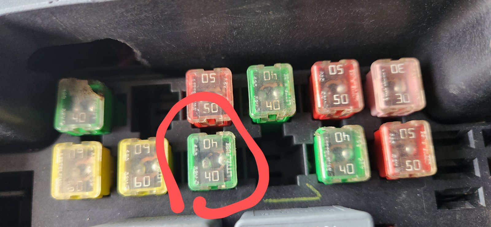

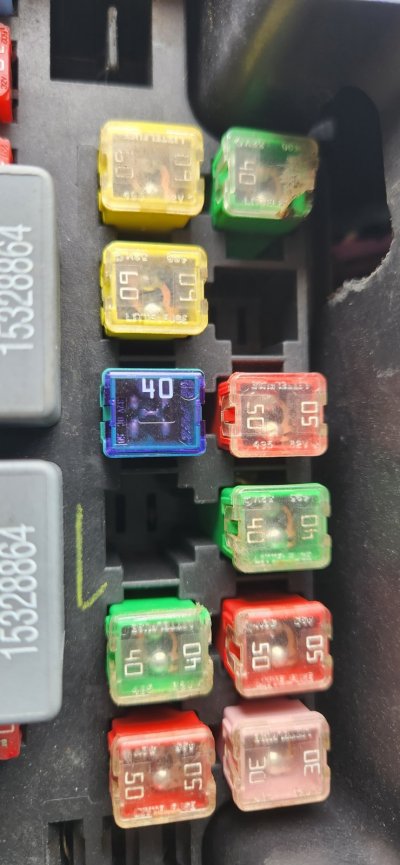

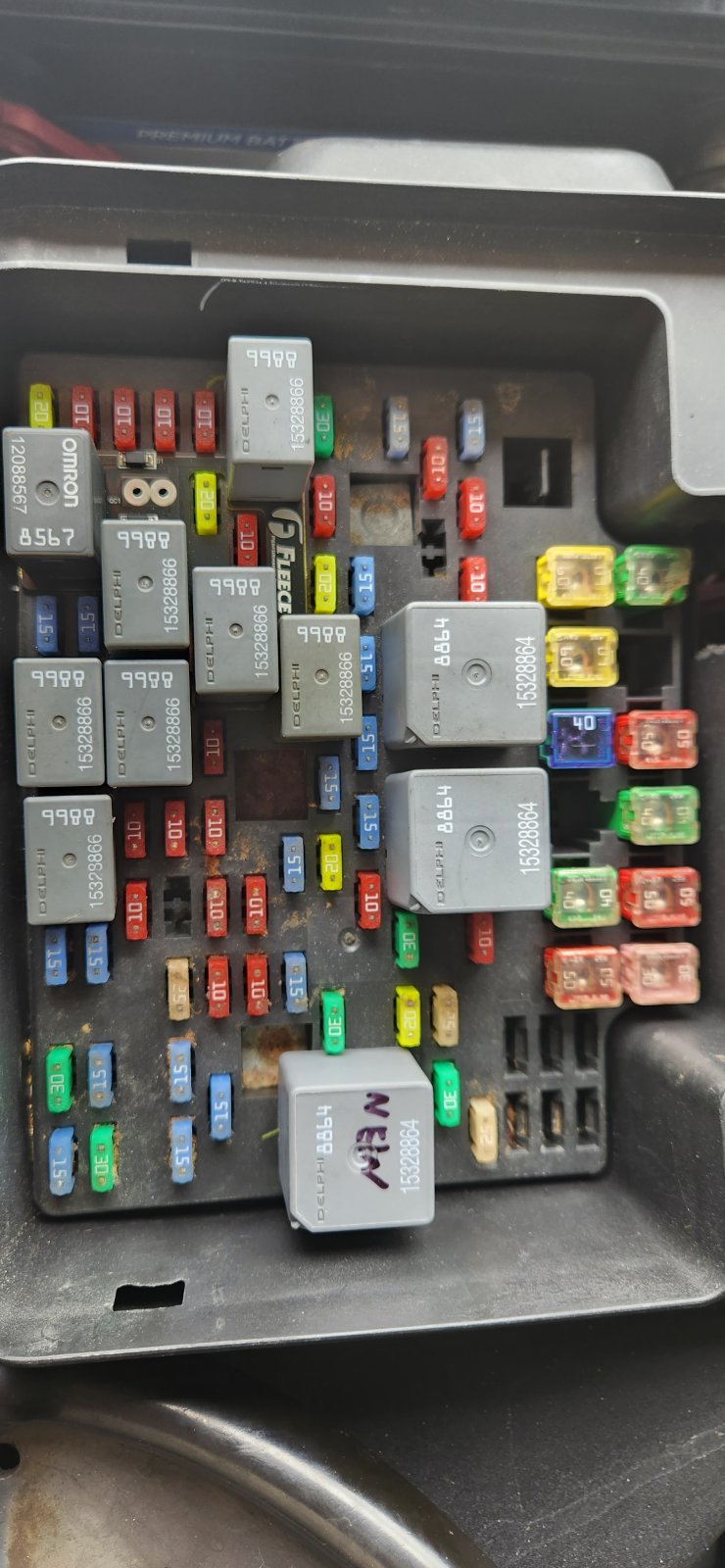

Ok...... This thread is nearly over !! I found the GLITCH...... ( But, not clear when the fuse popped, but replacing it solved EVERYTHING !! I may have popped the fuse when jumping the starter with a screwdriver, when I got home after replacing the starter.....
(( At the shop, after replacing starter,.. a "screwdriver-jump" started the truck....Maybe that is when the fuse popped, but the truck was running, and I drove it home........
But at home, the new " IGN A - 40 a" fuse ( blue color) fixed everything, and, also the few idiot lights went away on the dash, so no need to clear codes.
( pic with red circle is blown fuse )
