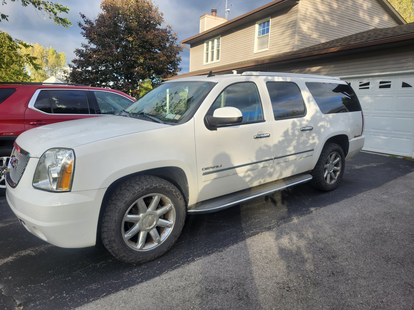

Pics of the truck, please.
You are already receiving sage advice from the knowledgeable folks on this Forum.
I had similar intermittent starting issues with my 97 Yukon (RIP), and it turned out to be a worn out ignition switch.

Thank you for the welcome, the advice on here has been great! I will update this thread as I find things out and will participate where I can in other conversations. Just know I'll be a slow poster, I work from home so I don't drive it very often and it just recently turned cold so I'm not being very proactive on diagnostics in my free time. Also, 8 week old baby. I like him a lot more than the truck so I spend time with him lol.

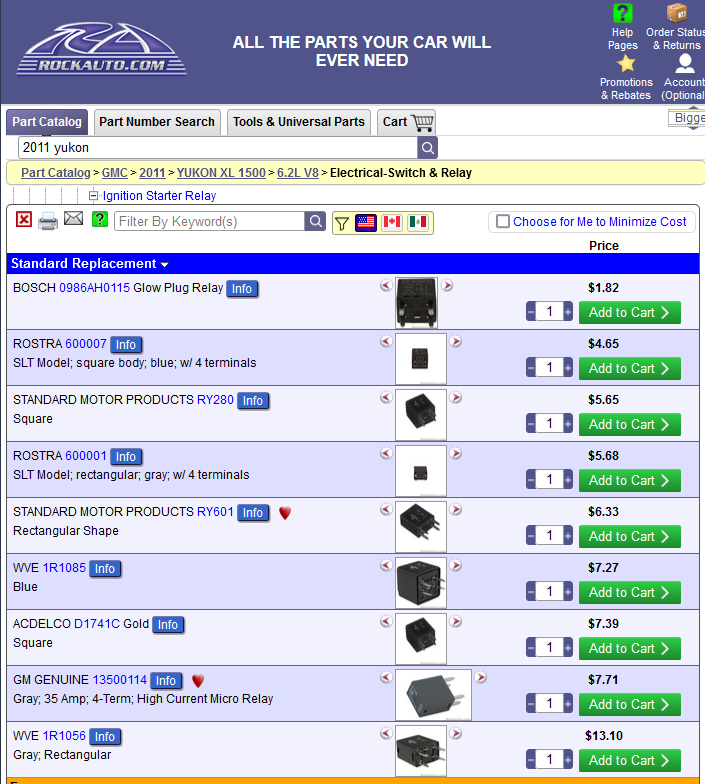

Starter relay? I know you said fuse box was replaced... not sure if that comes populated with new fuses/relays?
Starter relay was replaced, but I would like to carry a spare anyway. Does anyone have a part # for that relay?
Moderator
16,612
34,385
People's Republic of Colorado
Recommend you familiarize yourself with a few quality online vendors. If nothing else, parts lookup can be easier. If you have questions about if a specific relay matches yours, compare the pin diagrams that are on the parts.
