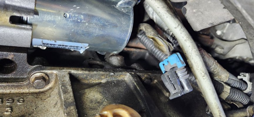

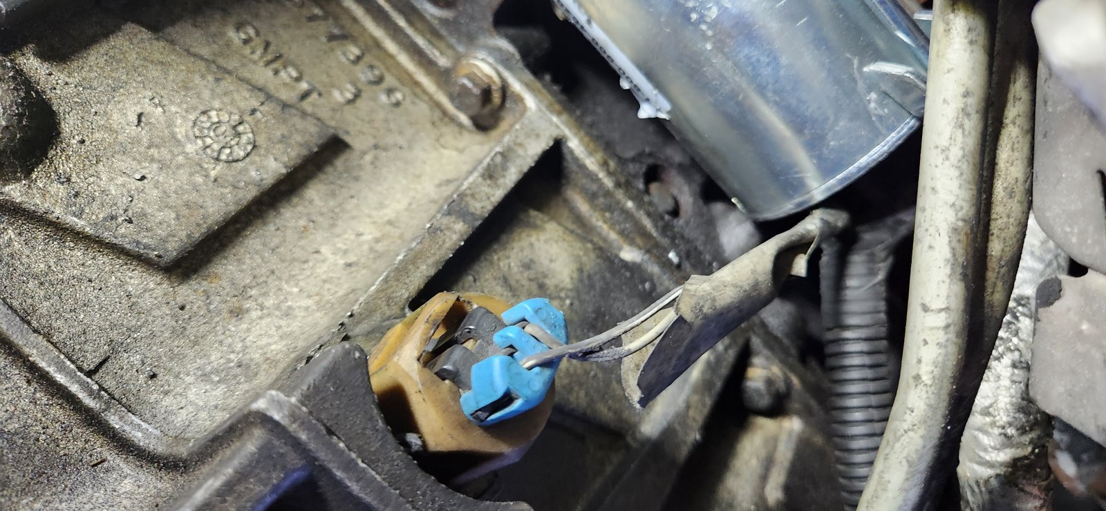

I re-plugged in, the plug to transmission ( It was unplugged). I wonder if I should disconnect then re connect the battery, to reset ?? Because I plugged in the plug to transmission ( transfer case)??
I also have "Service 4 WD " That may turn off if I disconnect battery to clear , since it is now plugged back in. ( photos )
CORRECTION : This un-plugged pigtail is the oil level sensor. ( stupid me.... I didn't notice that is the oil pan..... stupid-stupid..... ( but the 'service 4WD" is still in my dash....

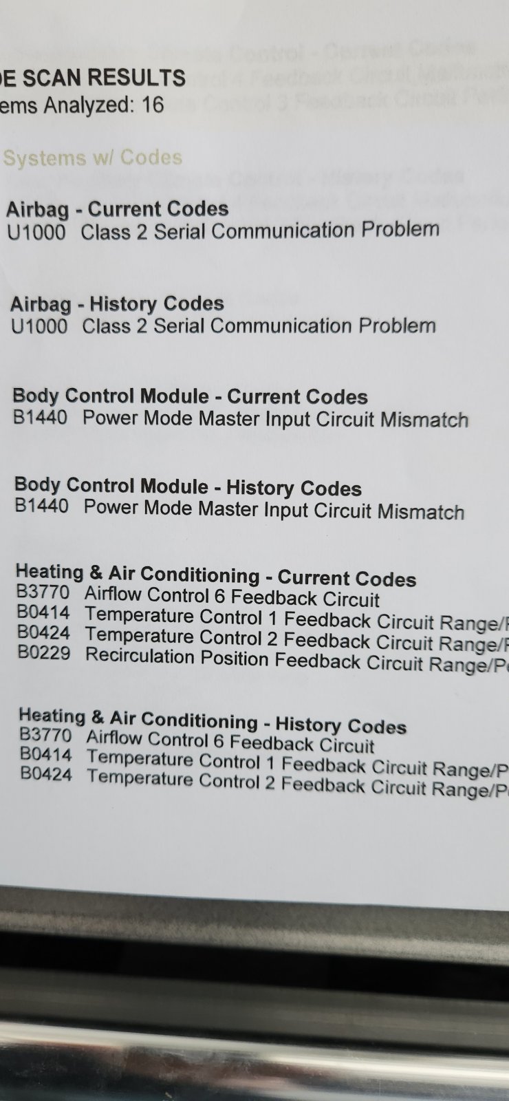

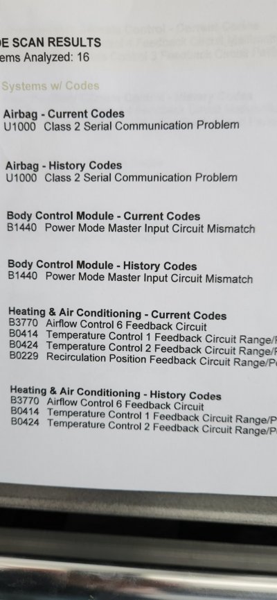

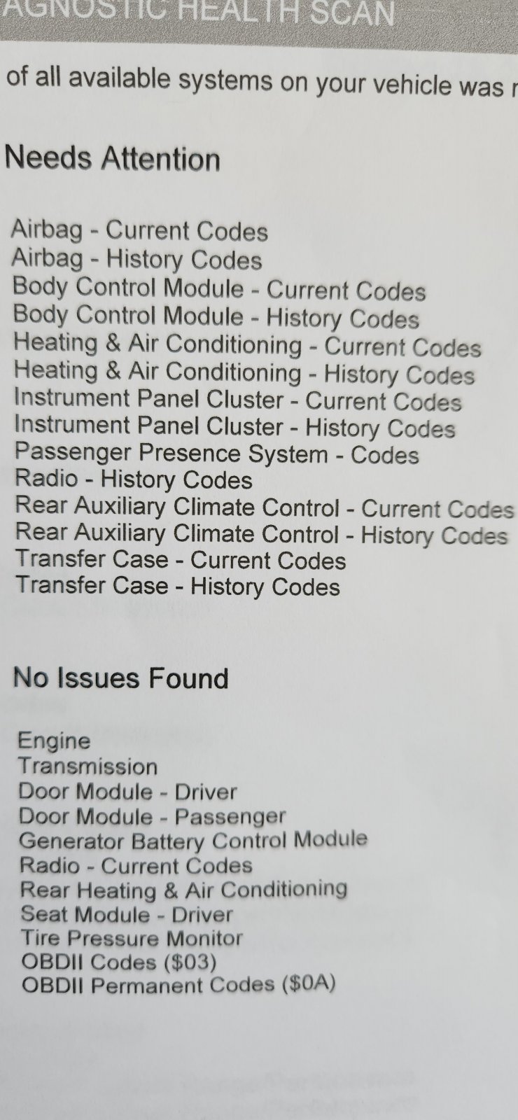

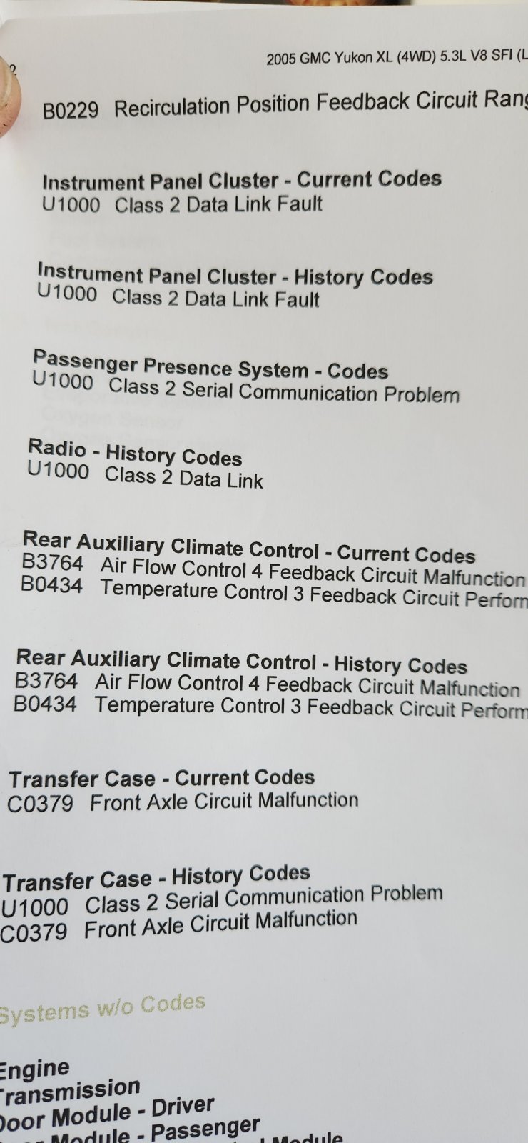

All these "trouble codes"...... I'm confused..... EVERYTHING about my 2005 Yukon has NOT shown these issues. ( Did I loose my ECM all of a sudden ??? ) When I drove back from my mechanic, ( besides the transfer case un plugged)..... It drove great as usual.. no issues...
A/C is fine, front & back..... etc....

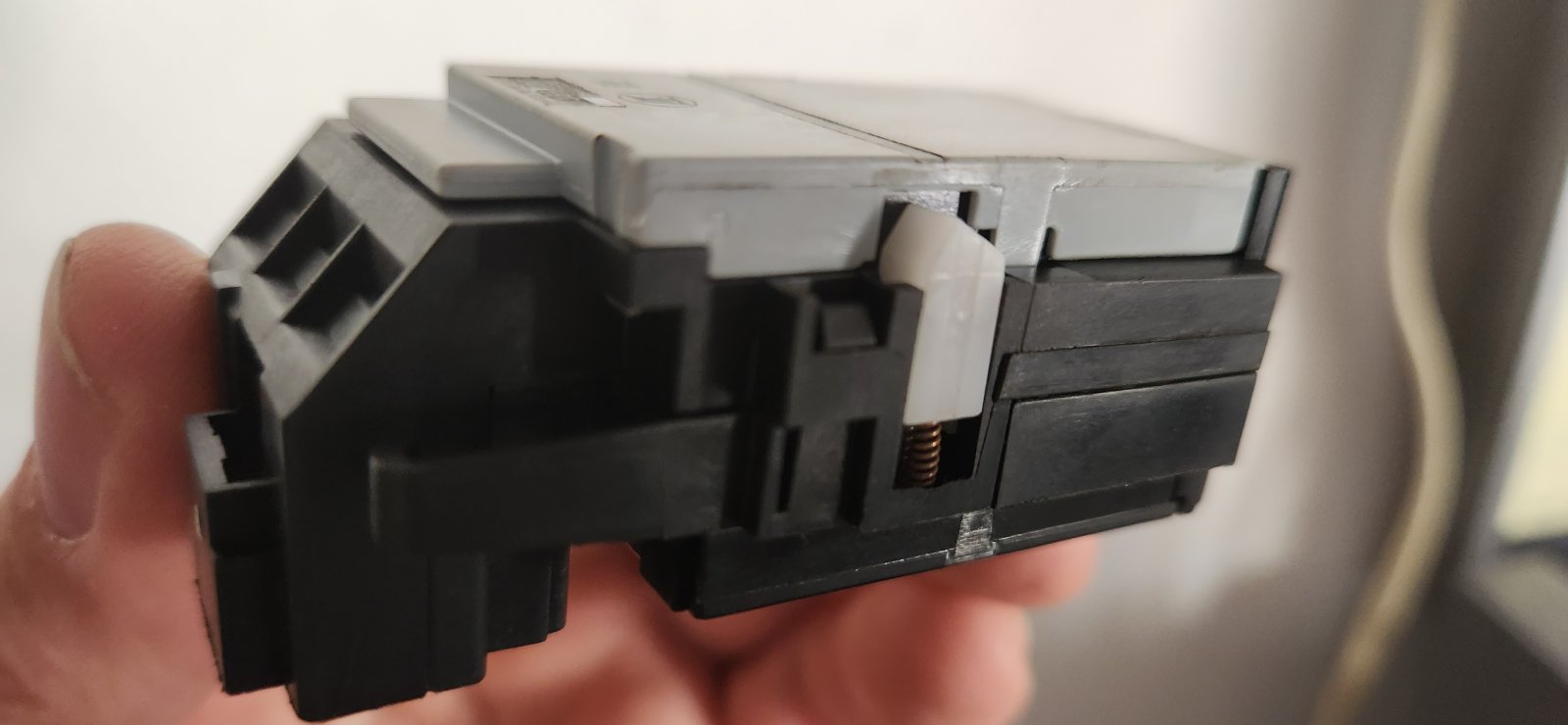

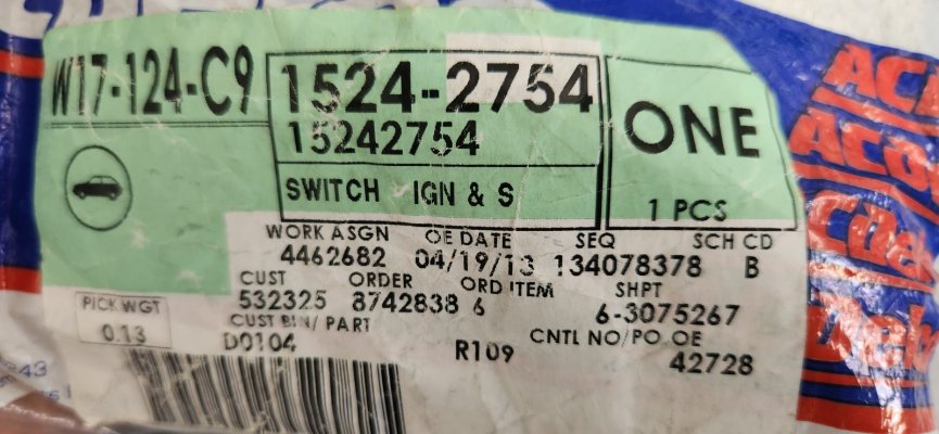

Almost a year ago, I bought an AC Delco ignition switch . ( I heard they are hard to find)..... I am thinking of changing the ignition switch....
I am wondering if the switch is a cause??
OR VietVet
GMT800 2005 Tahoe Z71
Navy Supporting Member
Oct 8, 2014
23,917
44,624
Willamette Valley
Just make sure the gear teeth, on the switch, is keyed in the correct position. I went thru this on my girl's Trail Blazer and it uses the exact same part # switch. So does my Tahoe and I just bought a Genuine GM switch on ebay, just to have. They are very hard to find, oe part that is.

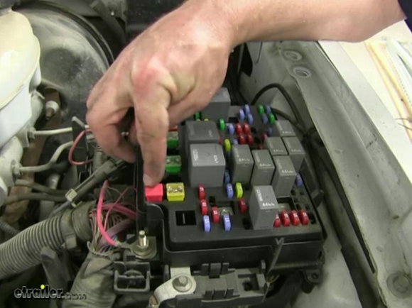

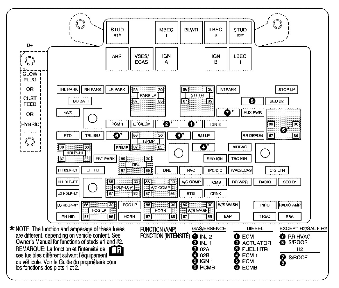

Probably you have not disconnected the battery while working on the starter and you made a shortcut. Then the 40 ampere fuse which is in the fuse box, on top on the left side is burned.
That would explain all the lights on your dashboard...
Good advice... but battery was disconnected... I 'believe' all fuses were checked, but the fuses will be re-checked today.
I had once this fuse blown, i do not now why, just removed the radio, and my symptoms where the same...

Look on the pic. The fuse left on top, if you look from the side in your car...
That one, where the guy point's on.
Tagged as STUD, whatever that means...
