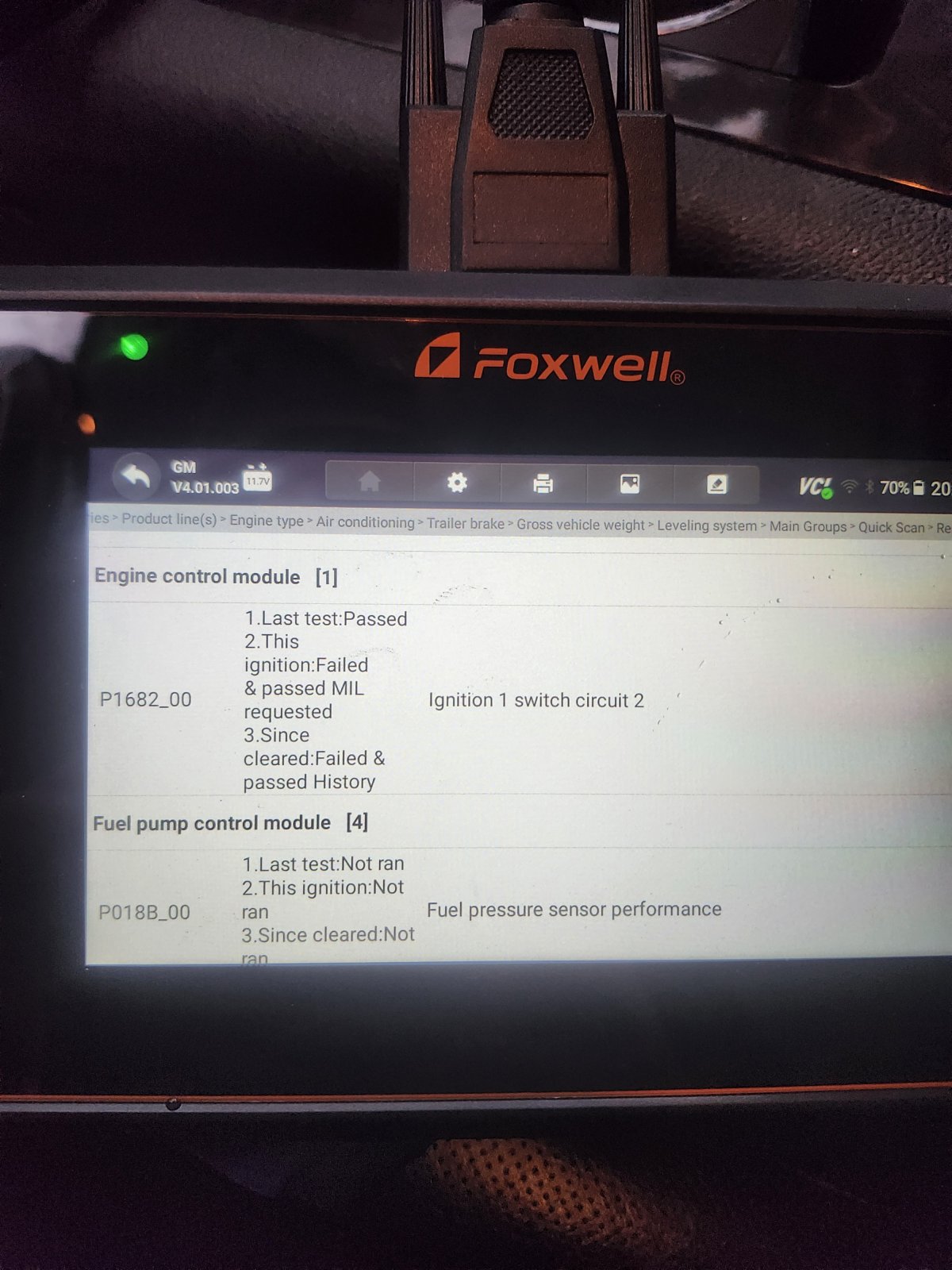

Well all, my luck ran out. Had to jockey cars around the driveway today. Fired it up remote start. No issue. Ran for 10 minutes, shut down for an hour. Tried to remote start, nothing. Got in, turned key, fired right up but had a CEL. Code P1682. Cleared the code, moved the truck shut it down. Realized I was off the driveway, couldn't see it due to snow! Went to fire it again and it cranked and cranked with no start. Tried again, long crank no start. Tried again, it fired but was lopey. Check engine light, reduced power warning, stabilitrac warning. Got the trucked moved and shut down and went in to watch Sunday night football. Y'all got any ideas what the hell my truck did?

In the morning or tonight, disconnect and slow charge the battery. If DTC goes away you may have a battery that’s ready to let go.
Next step would be to slow charge overnight/ disconnected again and have it load tested at part shop.

very general but sounds like ign power issues.
if it sets the code again. the freeze frame data could be helpful

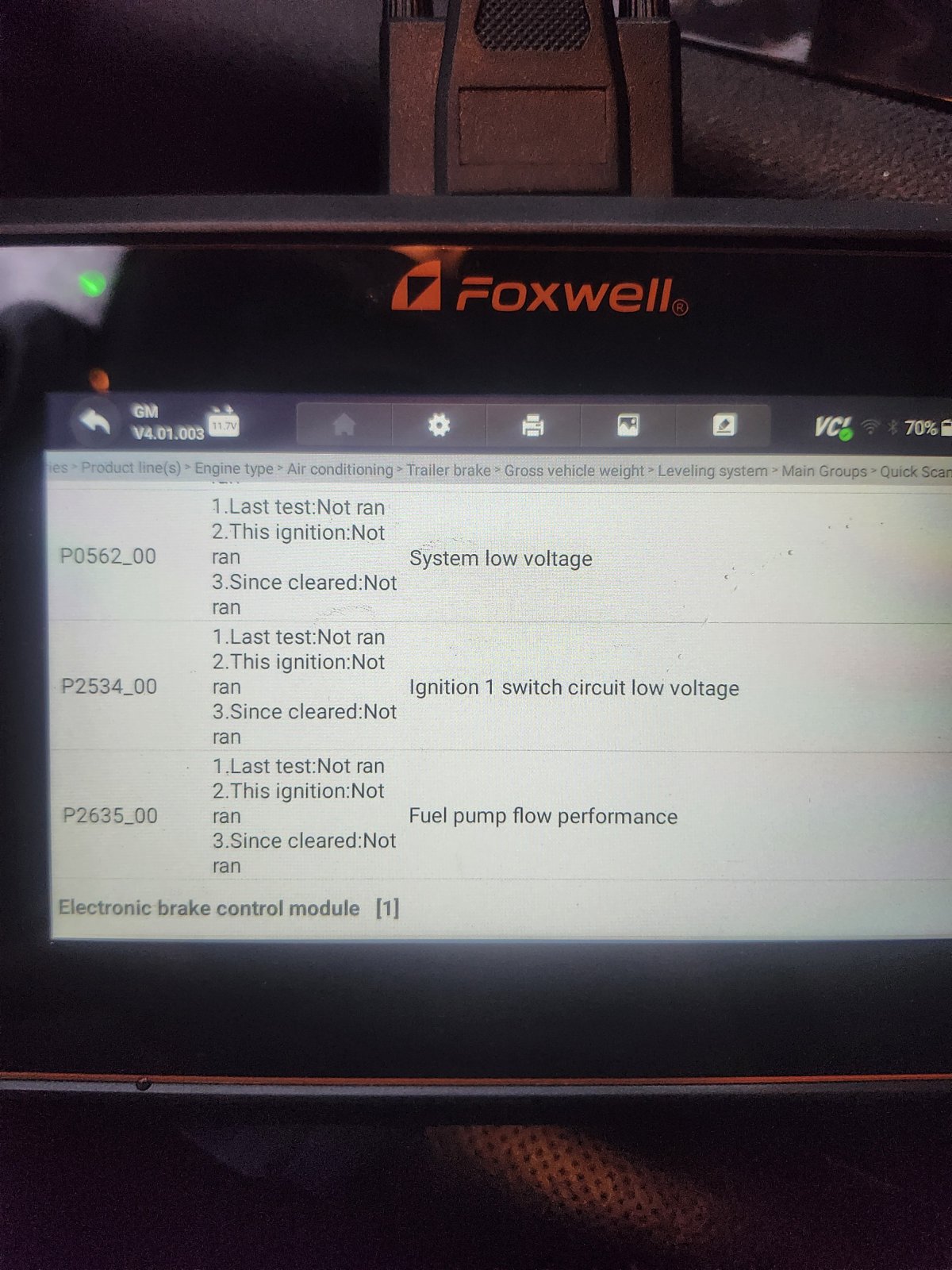

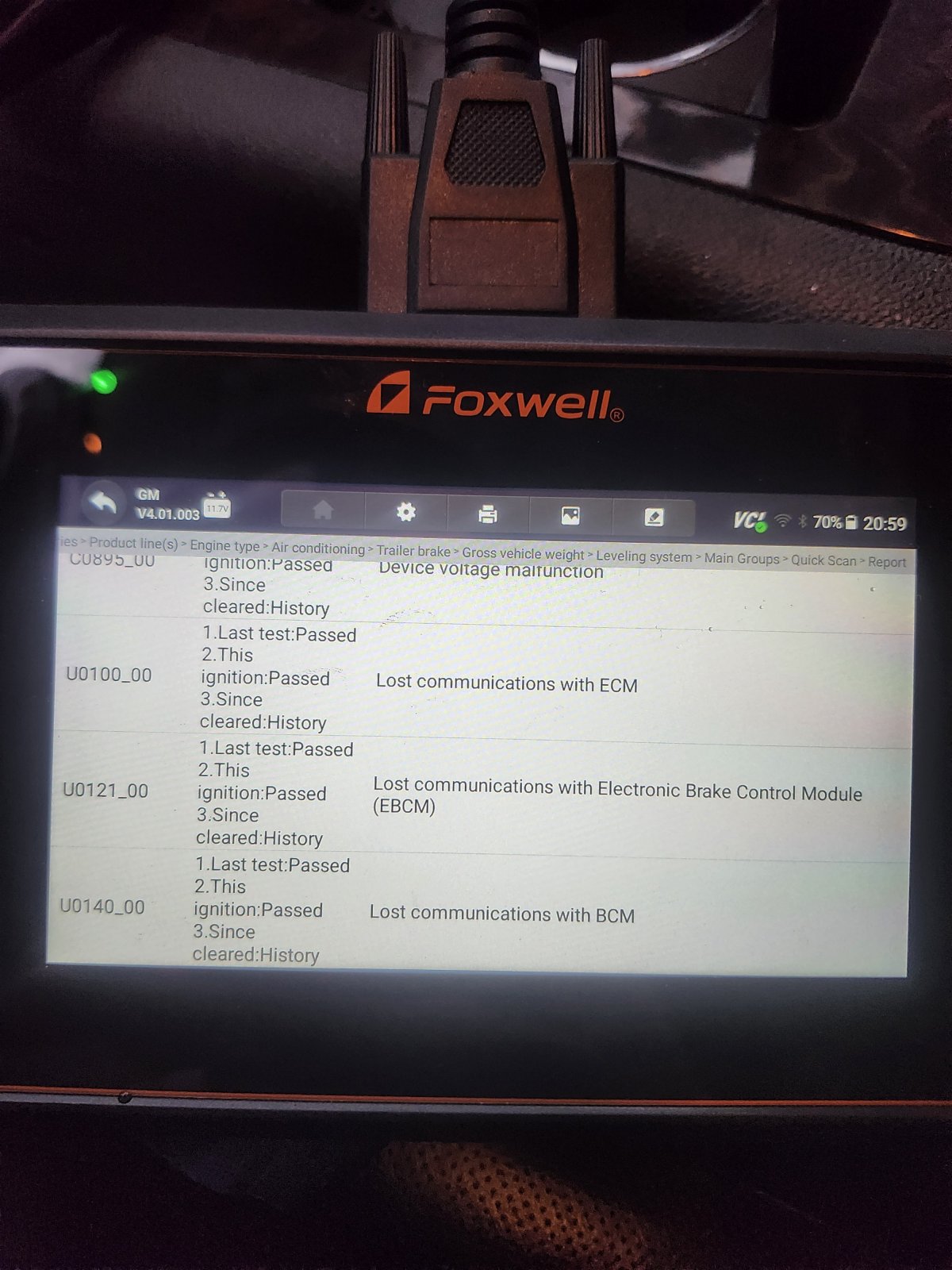

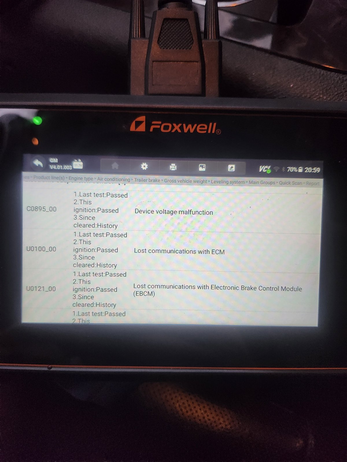

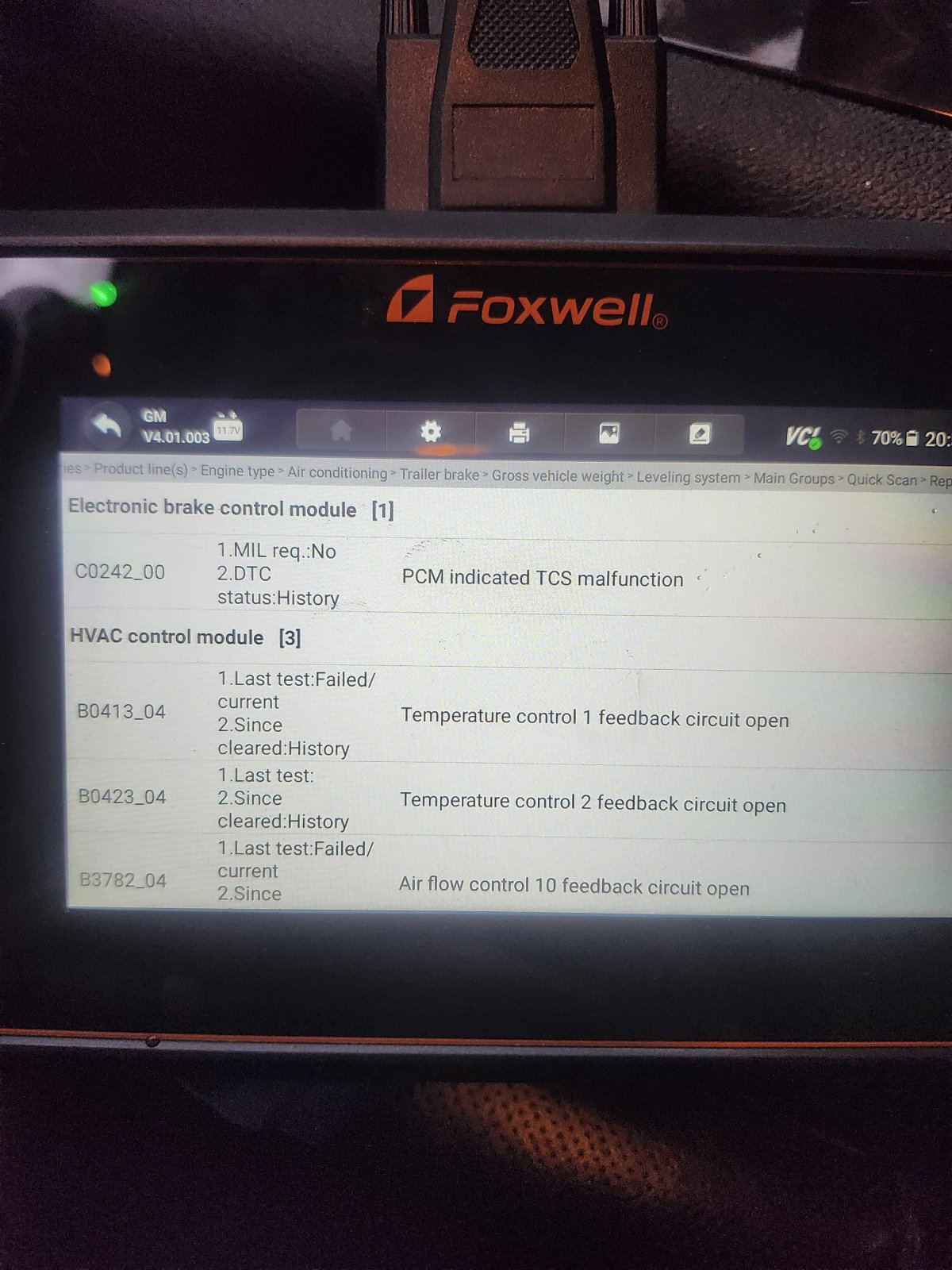

Well folks, get ready for this one. Went out today to look at the truck, Crack and no start twice. Fired third time but all warning lights on. Collected codes in pictures. Erased codes. All warning lights went away and idle returned to normal. Shut it down, started right up, no CEL, no warnings. I'm tossed. Mechanic thinks bad battery. I think it's something more but I will start using a battery tender on it since it sits a lot between drives. I should also mention sometimes volts are below 14 and sometimes they are above 14.
30,698
48,333
the hvac codes are likely unrelated but there is a TSB out there for the transmission harness having some of the pins not inserted properly and it causes a whole host of issue's, might be a rabbit hole but not hard to check out also.
some of those codes and your issue's match the known problems reported in the tsb
