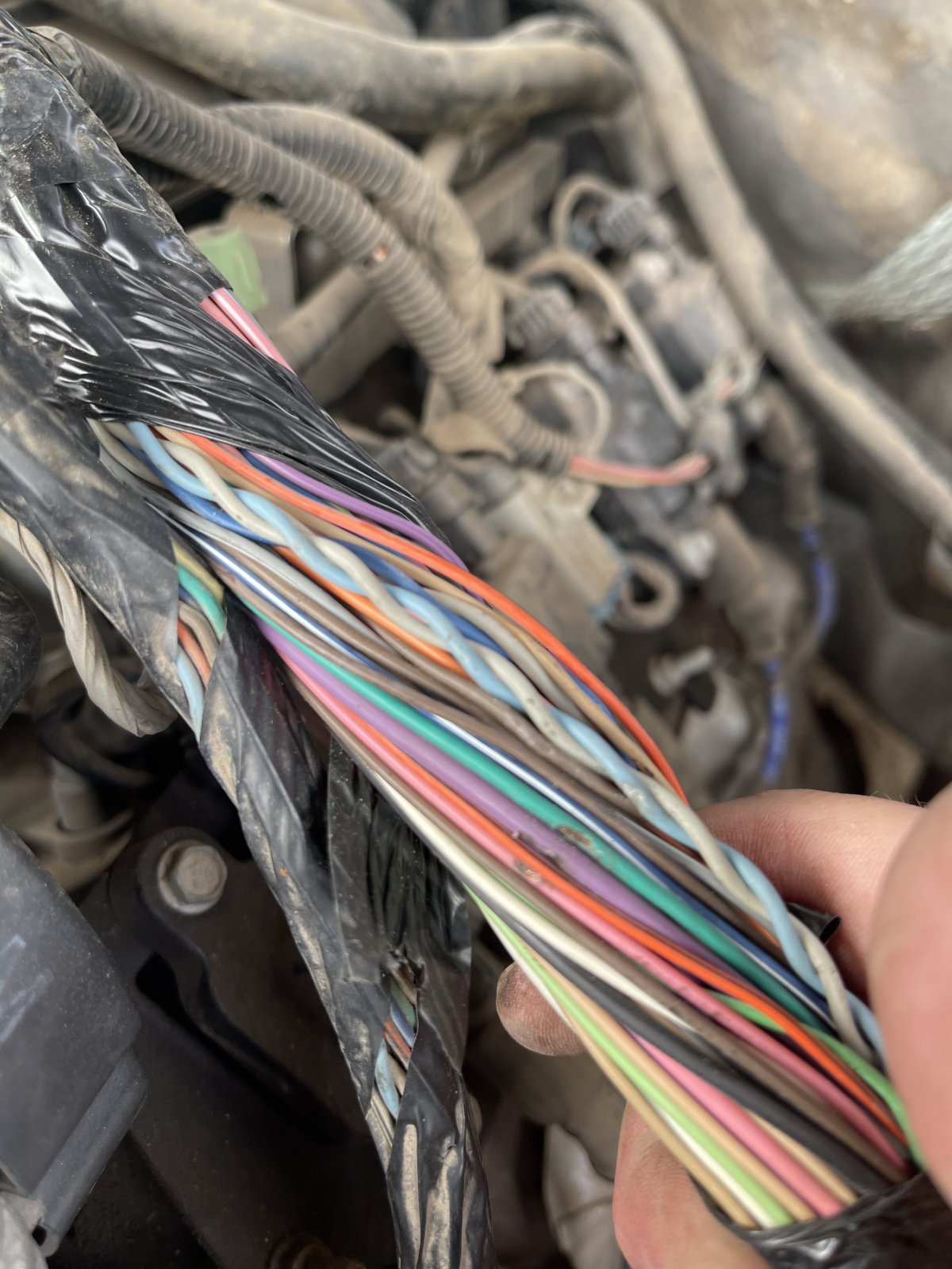

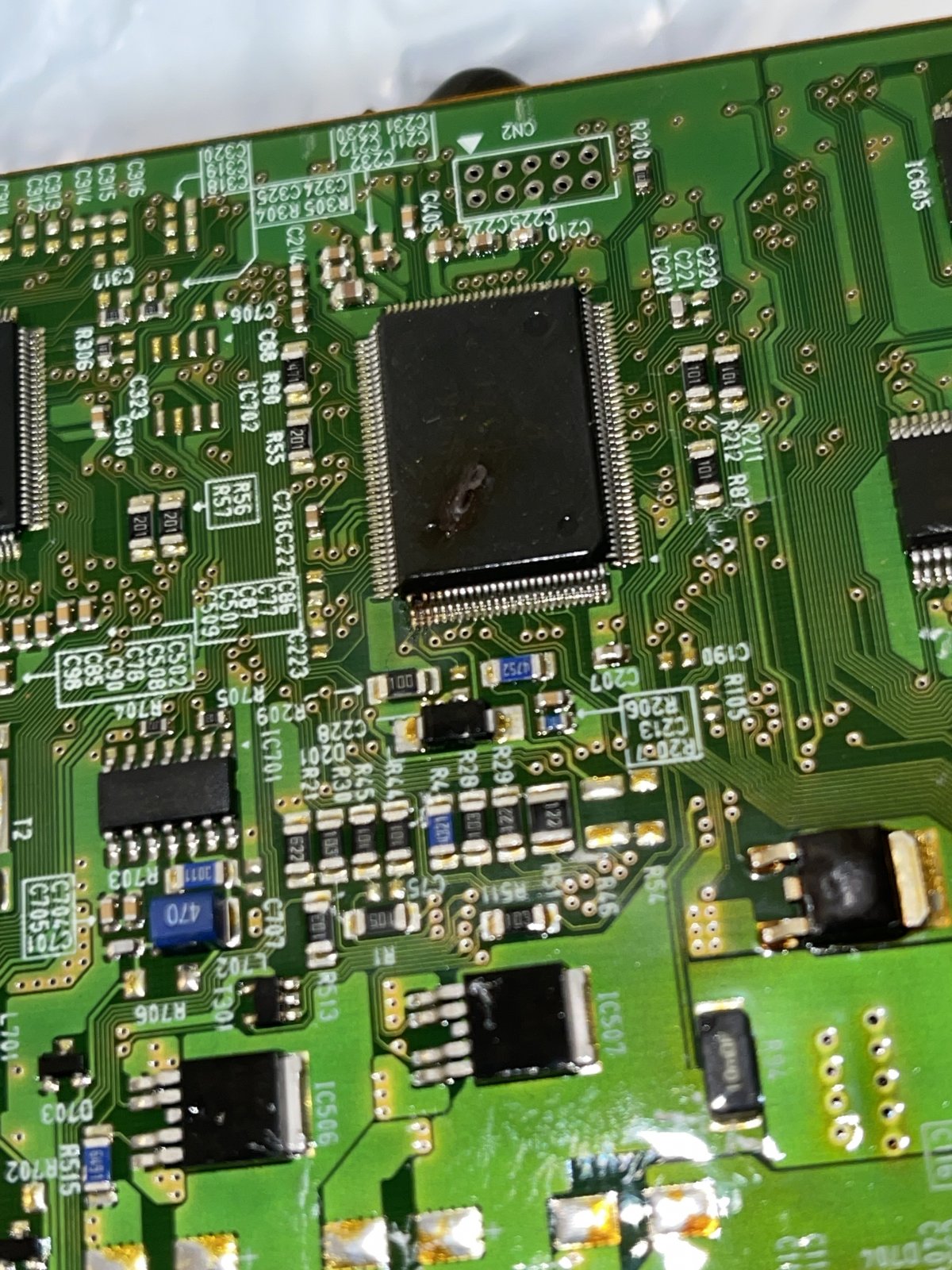

To anyone who looked at this post. I think I found the problem, after hours of going thru testing power checking grounds ,Following schematics, I was getting power in but not out. The Bcm left the chat lmao

that's rare, perhaps some wires got crossed at some point causing the chip to fry, I have seen that on other brands but not on a gm.
that's what scares me about buying one for 250 from eBay and it doing the same thing. the ground being loose wouldn't have cooked it like that i don't think.

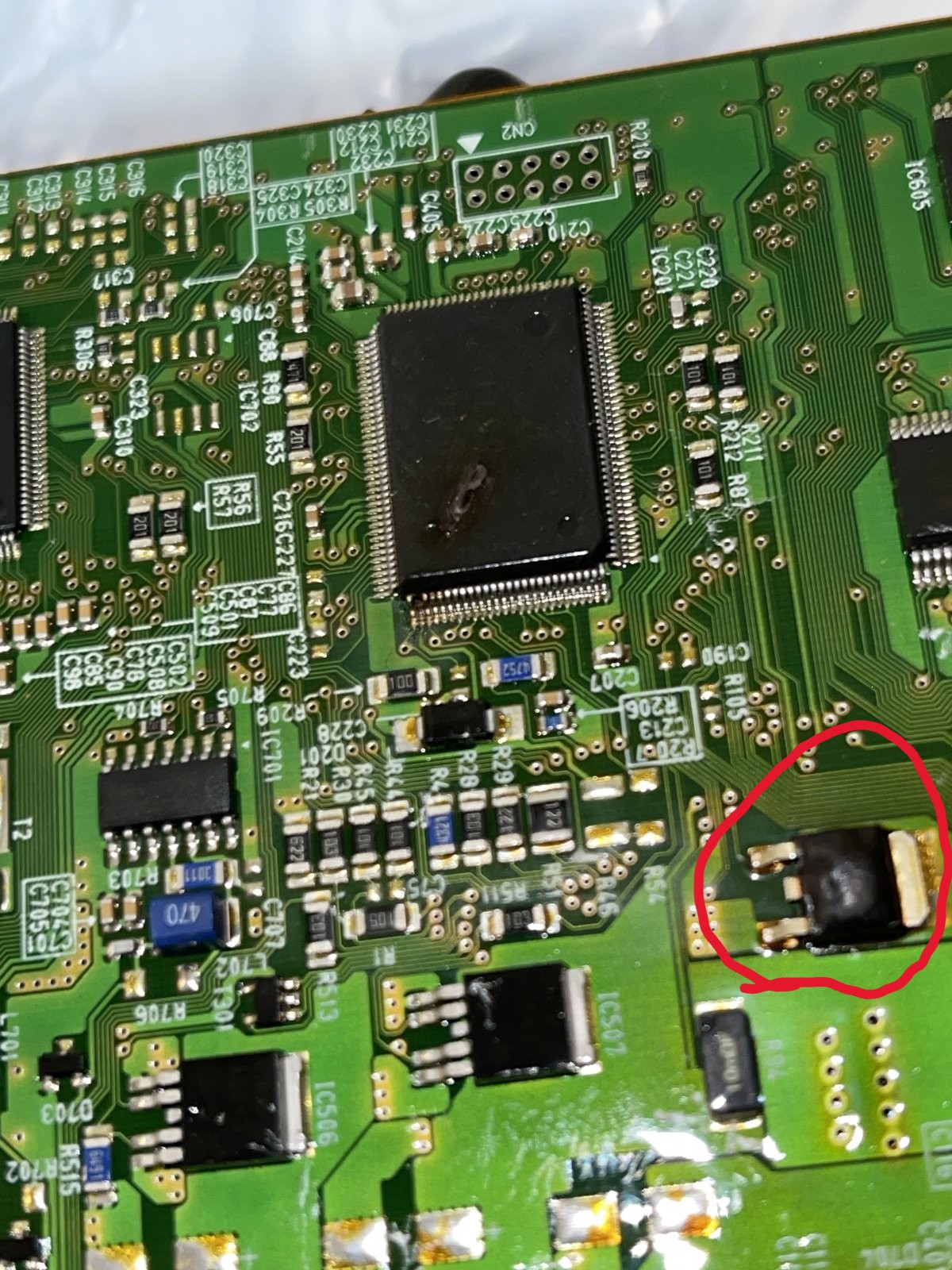

That is weird that tightening the ground caused the headlights and blinkers to stop working..
Hopefully it was the BCM itself. Maybe another failed component on the PCB could cause this?
Circled in red, I wonder if that looks overheated..
that was the first thing i saw yesterday , hopefully that failed and caused the mess .

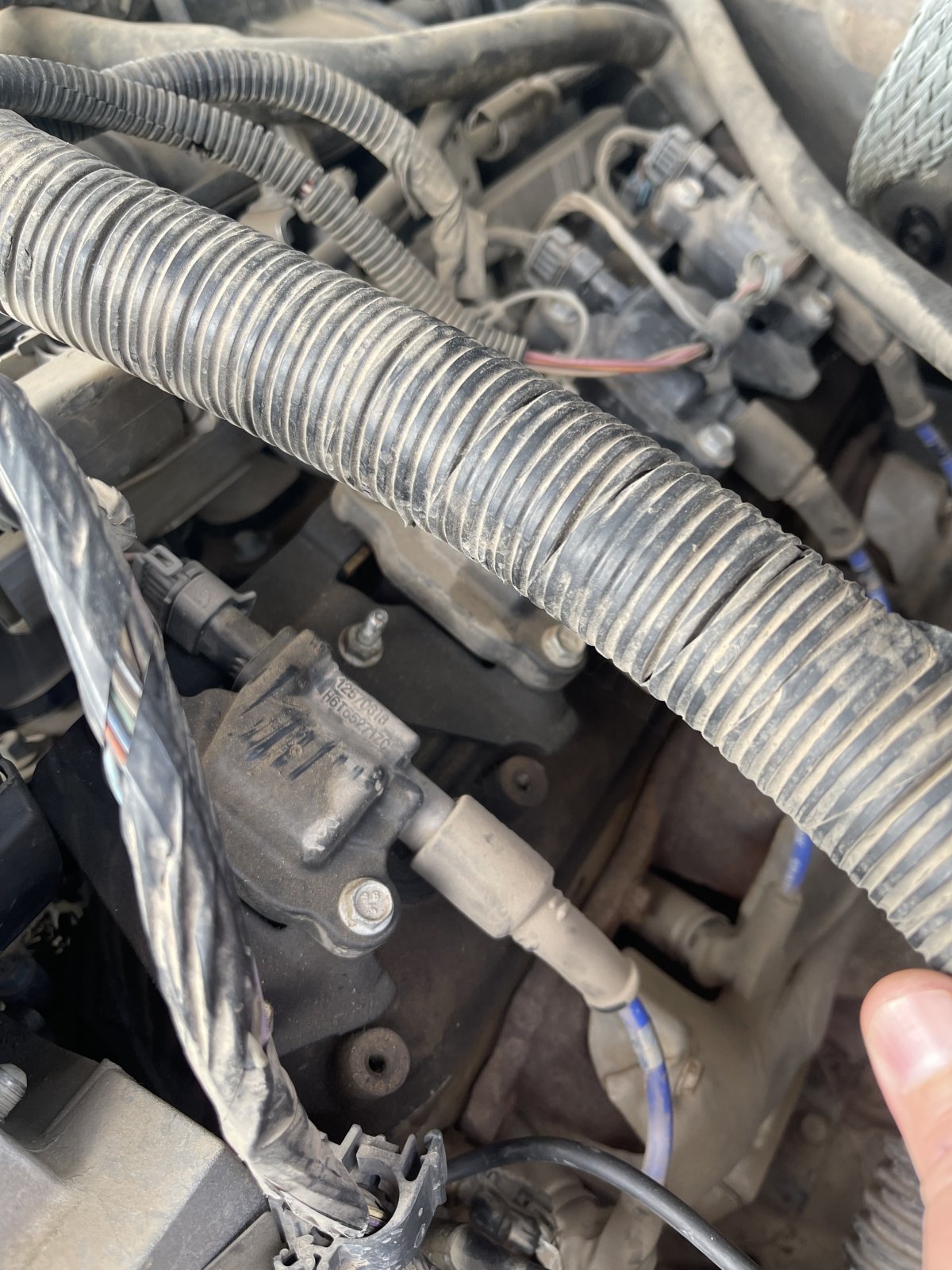

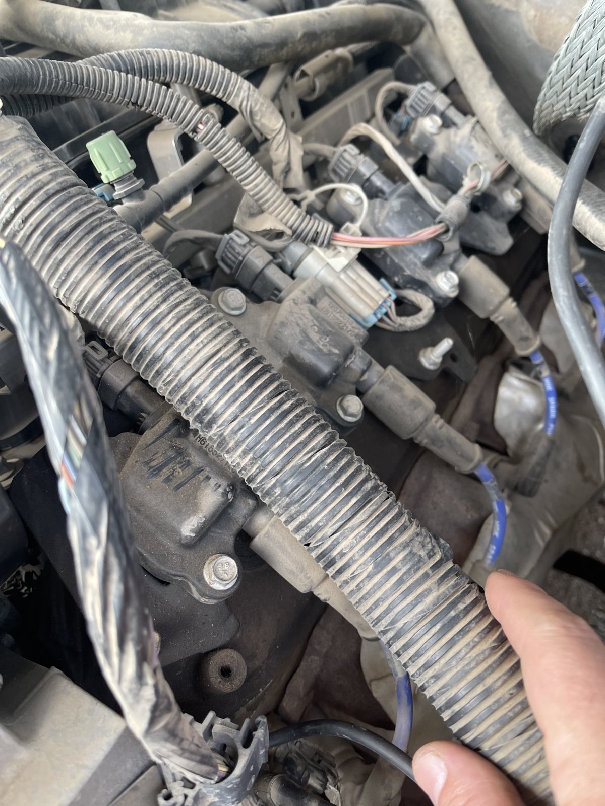

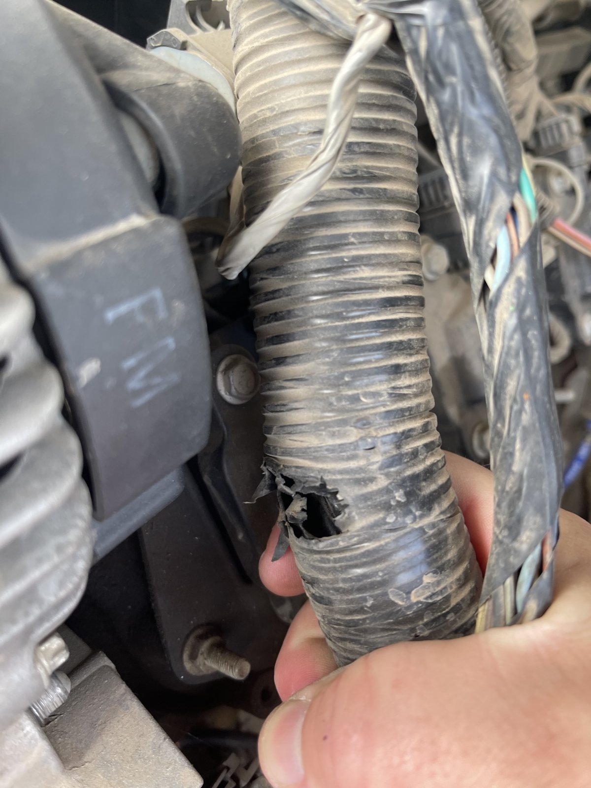

So I’m still waiting on bcm, but it was bugging me to find out what killed it. So today I went out and started looking over stuff again and look what I found. There was like two strands on each wire barely holding on .I’m glad because it would have sucked to have put new bcm in and it fry again. I also put a new/used fuse box in and got rid of that stud and put a regular 10mm bolt and solder the wires.

He said it was a stud that he replaced with a bolt.
Just looked at mine, what you were missing is a wire loom holder that sits right on top of that stud.
(small plastic standoff with a ziptie)
my wife has a 2013 and yeah it has that part ziptie that sits on stud. once i get the new bcm and it runs im going to go thru and replace loom and tape and those stand offs

yep, you have look at all of the engine compartment wires and adjust them as needed over time they sag or the clips break, etc
everyone should do this as general preventative maintenance.
some of those stand offs are not sold separate by gm and only come with a new wire harness, so the junkyard is your friend
a small flat head screw driver or pick tool allows you to open them and then move them to your wire harness
when you are looking under the hood anytime, just eye ball everything and if it looks questionable adjust as needed.
you can use zipties or electrical tape to support wires if clips are not handy
anything that sits on top of the engine or crosses over it is critical.
anything that just dangles free should not be, just wiggling up/down over time the wire inside can break where there is a bend (invisible break)
