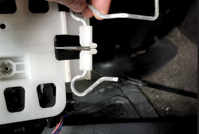

I also cracked open the power lumbar gear box.
I confirmed 3 gears just like it should have per Gruven.
But the outer ring gear has a crack in it.
I doubt it will matter much, but I'll probably steal the ring gear out of the passenger side for now.

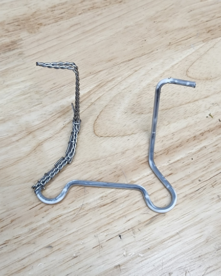

I also found a broken part in the lumbar itself.
The wire piece seems to be made out of aluminum, and coated with plastic.
I thought I was screwed, but then I got the idea to use my handy safety wire pliers.
I spun up a piece of the heaviest stainless wire I have then folded it over.
The end ring attached to the original broken end.
Then secured with some smaller safety wire.
It's pretty stiff, so I think it will work.
I finished it up with some shrink tubing.
Mostly so it won't snag.
So far it feels like it will work just fine, but I won't know for sure until Gruven actually ships my parts out.

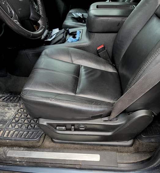

and the picture of the freshened seat.
Last night I used my steamer to try and get some of the wrinkles out of the leather.
Much better than it was for sure.
Due to the little repair on the side, I was tempted to replace the cover.
but I opted to use the current one instead, saving me some money.
+ I like the aged look of the leather.
33,185
51,399
