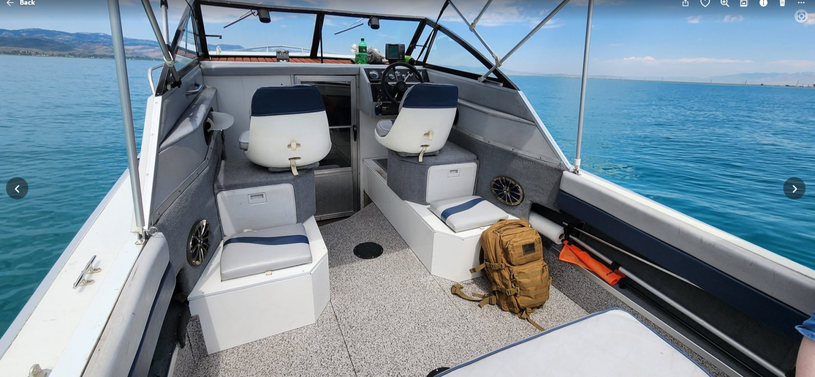

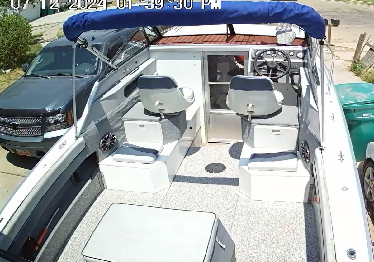

In the end of 2023, I picked up a new to me boat, and the Tahoe did fantastic hauling it home for its several hour drive, and up some canyon roads at highway speeds. :ehcapt:
The boat is a 1994 22ft StarCraft Islander 221 with a MerCruiser 4.3l that has a somewhat small crack in the engine block.
The trailer is a 05 Metalcraft with all the bells and whistles, first time having something with brakes and double axles!
Not to mention this thing was professionally fitted to the boat as metalcraft is local.
The PO kept meticulous records, I have everything including the trailer and the fitting done by metalcraft.
Work starts on it soon... :ehcapt:

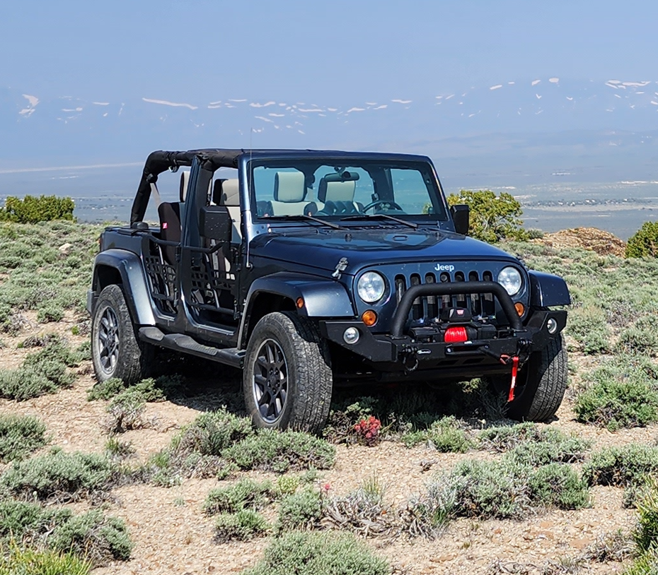

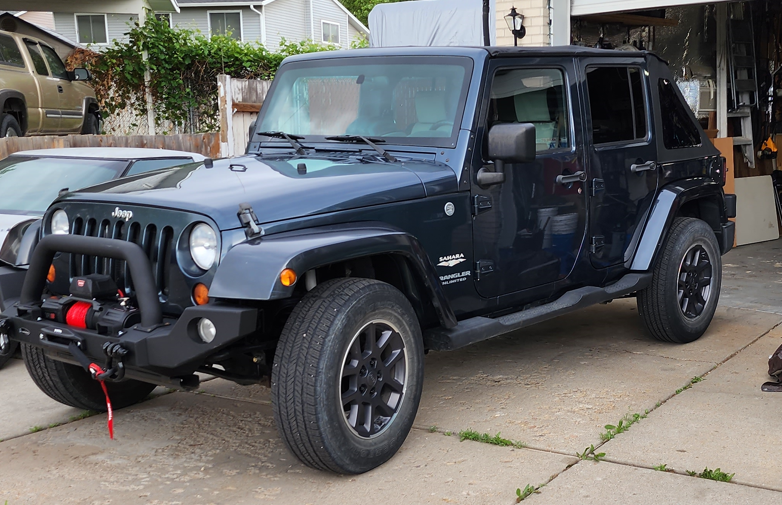

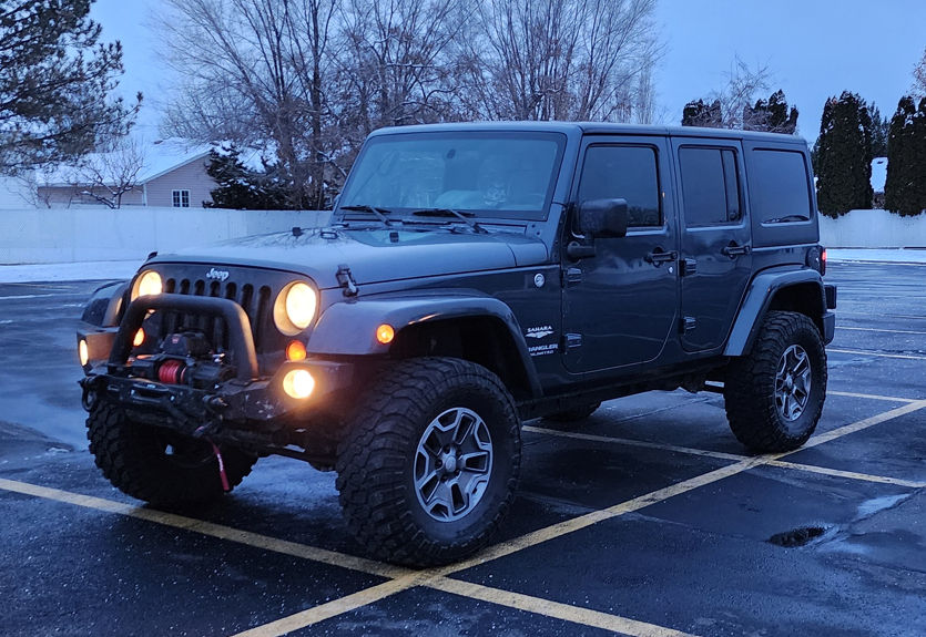

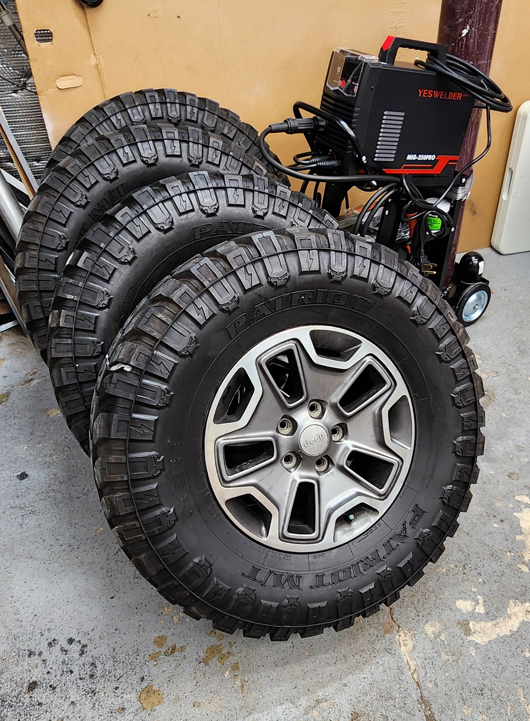

Then the end of 2022 I also picked up a new project, the price was right so I couldn't pass it up.
The Tahoe got it's first taste of about 7,000 lbs (+/-), it did great!
The project was a 2007 Jeep wrangler Unlimited.
Price was 5k.
the catch: Severe rod knock/spun bearing.
I think part of the good deal and the motivation is that the seller came from NC, and the Jeep still had the NC plates on it.
He tried and failed to get it registered here in UT per some receipts I found.
I found it was leaking oil, and antifreeze pretty badly, I suspect that helped make the engine fail.
It was a pleasure to work on something other than the Tahoe.
I ended up rebuilding that engine for under 1k invested.
I had to replace one rod + piston, and I got a used crankshaft from a minivan that was a perfect match.
Metal had gone everywhere, so it was a full gut, cleaning, new camshaft, new lifters since they were seized with metal. :jester:
Pushrods had that sanded look, so those were toast.
This engine has about 4k+ on it now and it's doing great. :cool:

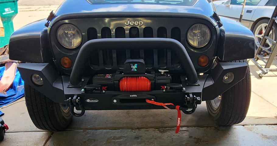

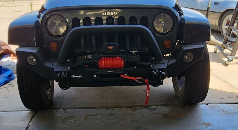

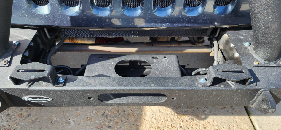

I also needed to replace the front bumper as it wasn't straight.
I ended up scoring a really nice winch bumper second hand, but new in box.
Quadratec brand.
Under $200!!
then I had to fill the big empty hole with something, so a winch found it's way via amazon.
Xbull brand with a 12,000lb capacity, then another $20 for a warn sticker kit since it seemed like it was asking for it.
Empty hole that was begging to be filled.
Installed with the x-bull stickers still there.
Increased the value of that winch by at least $1,000!!

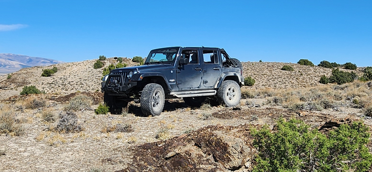

From here we proceeded to enjoy the Jeep over the summer.
My neighbor has a 30k side by side, I think this is much better + I can drive on the freeway!
A picture from my piece of worthless desert!

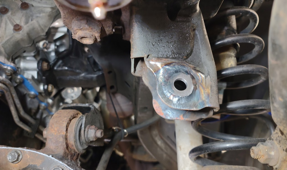

also forgot to mention the infamous Jeep death wobble.
This jeep had it bad.
Cause was both track bar mounts had become egged out.
Allowing the front axle to do the crazy wobble feature.
Luckily, I have someone that was able to fix it for a couple hundred bucks.

Part of the problem was the tires.
I refuse to buy the stock size since I have plans, but as luck would have it I found a set of 35x12:50 R17's mounted on Jeep wheels.
Scored them for $70!
Not the best tires, 6 years old and Patriot tires wasn't known to be a great tire.
But cheap, and they have fun little punisher skulls in the tread pattern!
Also no signs of any dry rot..
About a week later I picked up a 2.5in lift kit, new in box for less than $400 (iirc).
Then I picked up a set of Teraflex adjustable control arms for $200 to give me a little extra adjustability.
As she sit's lifted and with the bigger tires.
:head3:
Still to come, I have a front axle truss to install, and I need to change the gearing.
Currently it has 4.10's, I'm planning to go with 5.13 since this is an even more gutless pig now. :jester:

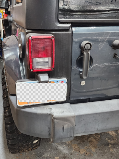

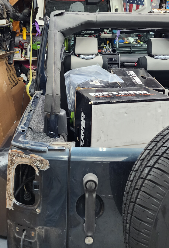

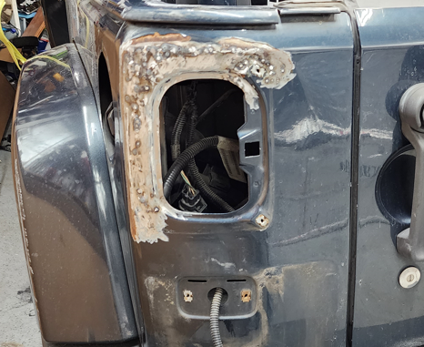

I almost forgot about the body damage in the rear.
When I bought this the driver side tailight had been pushed in, a common thing.
The challenging part was the body lines were pretty much gone.
the paint was also pealing from the damage, and some surface rust had already started.
So that needed to be fixed, so the top came off and work began with a harbor freight stud welder/dent puller.
Lots of work went into this until I was pretty happy,
I got it really close, and then a skim coat of body filler to help smooth it out.
I don't seem to have a before or a finished picture that was pre paint, but this is how it looked as I prepped it to sit outside this winter.
I used black spray paint since that's what I had, and I needed to cover the primer...
Body lines look better with the taillight removed, but they weren't perfect.

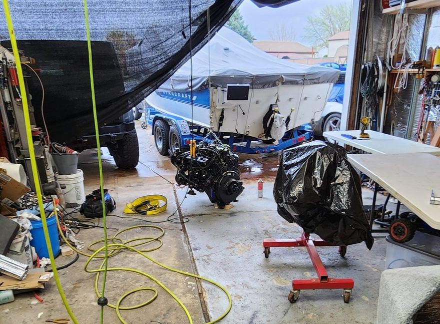

For the engine replacement, I ended up buying a built engine, and then doing a full tear down of that engine.
I found it was dirty as fk, lazy builder.
Lots of little issues found with it, including a freeze plug that they left inside of the block, I had to pull the freeze plug, and then remove the old one from within the block. :mad:
Turning the assy I found grit, that lead to the full tear down, plus how dirty everything was made me want to verify everything.
The grit sound was caused by one messed up thrust bearing, I guess they used a generic and then clearanced the bearing using a brick?!
Yeah, so it got full bearings, and I ended up replacing the balance shaft bearings.
Dirty as fk, plus I wanted to clean behind them.
To do the swap, I didn't have anything tall enough to pull the engine, so I opted to make something using UniStrut.
This is tied to the studs in the wall, and the ceiling, and then an extra support towards the middle for good luck.
They also did the hot wash tank, but didn't follow up with brushes and fine cleaning. :rolleyes:

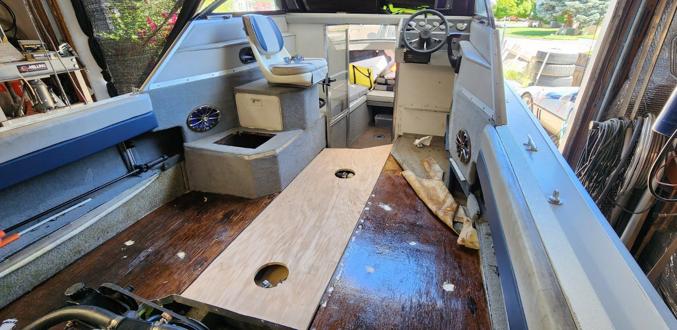

The flooring is just plywood, and the hull is 100% aluminum, including the "Stringers".
The flooring while it's Marine ply, was originally "Sealed" with vinyl flooring.
The PO decided he wanted carpet and cut the vinyl out and had it carpeted.
That resulted with the carpet holding water against that marine ply.
The first thing I did was to rip that carpet out, and put the original vinyl back in.
Somewhere I have a good before picture, but I wasn't about taking pictures of how nasty it looked with the "Bathroom carpet" look. :violin2:
This is a picture during, I had tp pull up the benches, and then flowed epoxy into fhe plywood in order to attempt to "bring it back".
I really should have just pulled all of the plywood up, however I was on a time crunch.
End of july the family had a big outing where they wanted the boat up at the lake.
It took so much epoxy and sanding to really bring the floors back to something I was willing to cover with $600 of vinyl flooring, It might have been faster and cheaper to start fresh. :happy175:
I did end up having to replace the center floor section.
The way the boat works, the side flooring has a complex box/cross supports that go from the bottom of the hull up to the floors.
Lots of support there.
The middle flooring section is where the 53 gallon tank sits.
Not much support, it's also a thicker piece of plywood at 3/4in.
there was no bringing back that middle section where I would ever be happy with it.
So a new piece was made and encapsulated in marine epoxy.
And then painted white using an epoxy paint for extra protection.

The Jeep project also stands as "done"
Final thing was a front and rear axle re gear to 5.13 and some Eaton true trac diffs installed in both axles.
I was pushing for air lockers, but the guy doing the work talked me out of air lockers.
He does a bit of rock crawling and sports a Jeep JKU like mine but sports a 6.2ls (Gen 4) and 6l80 swap. :p
Told me to run them, and when I get to the point where I want to upgrade, he told me to also replace the front axle.
As it sits now, with a fresh set of BFG AT KO2's and wearing the OEM soft top.

More on the boat (ran out of room for pictures!)
This is a picture of the boat as it currently sits,
And this is on the water while we enjoyed the boat.
Security camera view, I installed some faux teak under the windshield/dash.
originally it was this blue astroturf stuff, the PO installed carpet right over the top of that. o_O
I wanted to pull the carpet from the sides of the boat, up by the driver and passenger seats, but that would end up being a whole nother thing.
And adding more time to a project that needed to be on the water.
So, it's a later problem. :ehcapt:
For now, the boat works! :angels2:

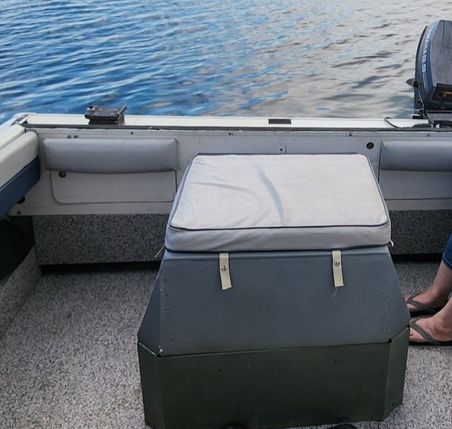

The engine cover was another thing,
The bottom of the engine cover is aluminum.
Orignally covered with the same vinyl flooring on the alumium parts.
The top is ply.
Covered with that blue astro turf, then the po put thick carpet over the top of that.
It held water, it was mostly done.
I was able to rebuild it, but I had to do lots of trial and error to get the angles right.
He also removed some of the supports for the top as it's a clamshell with a hinge, that caused some warpage.
I used a few pieces, but I had to replace 80% of the wood.
I still need to either paint or cover with vinyl.
I have the aluminum parts painted with the correct primer, and then the top is a different color/type of primer, I still need to do some fiberglass work to really clean it up.
I'm leaning towards finishing the top with an epoxy tractor paint in paper white.
