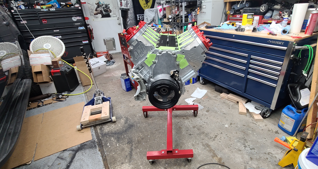

Been getting back into it while I still have a few days off of work.
One thing I wanted to do was to flush out the rear transfer case output to driveshaft area.
I had gotten a little dirt into the dust seal portion of the output shaft seal.
While I don't believe it made it into the bearing area, I did want to make sure it was as clean as possible.
I also needed to fill the transfer case with ATF.
I already primed the engine so I could get the power steering/Alt bracket reinstalled and out of my way...

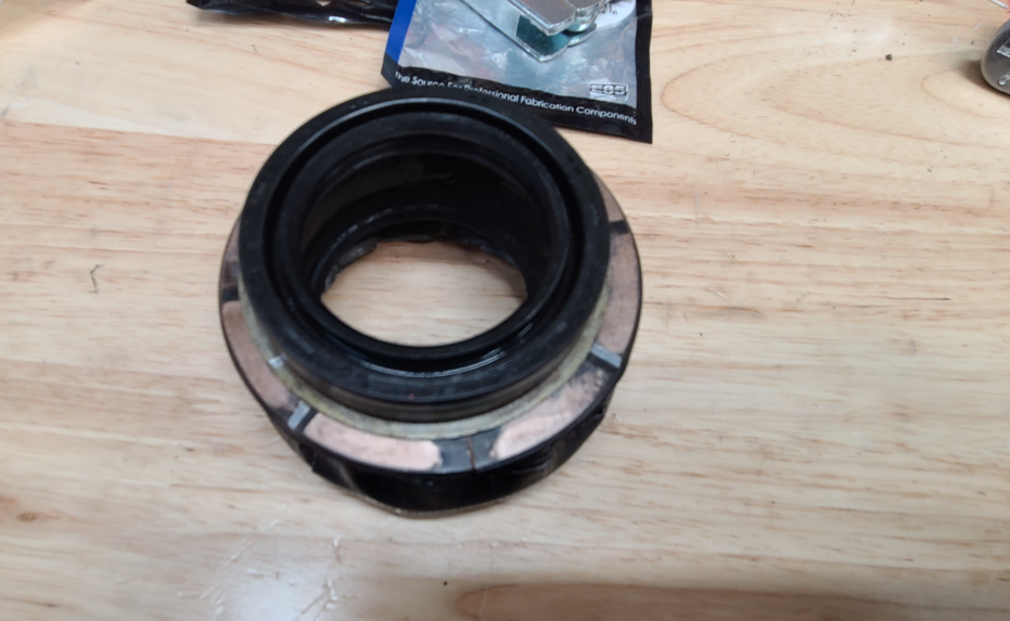

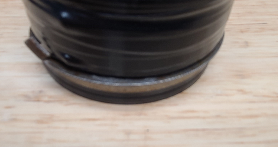

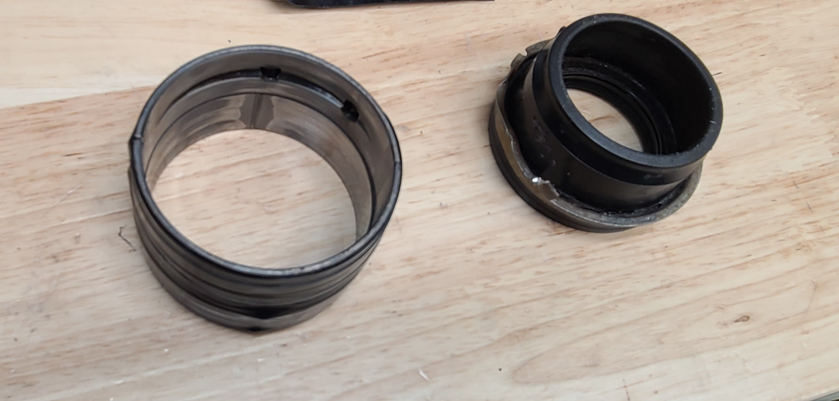

When installing, I needed some way to only hit the rim of the seal.
but that seal is pretty big.
Originally, I thought I could just use a holesaw, cut a hole in a block of wood, and use that as a driver.
But I didn't have a hole saw that was quite right.
So that would probably require me to find my jig saw.
and that jigsaw, I'm pretty sure is on the shelf above where the tahoe is sitting.
So next idea, find a bearing or something that might work!
I went through my left over transmission parts hoping i had something right, a piston, bushing, whatever.
Answer = nope...
Looking on my tool cart, I start flipping through some of the left over parts I have on there...
Rod bearings = nope but closer!
Main bearings?
Close!!
Old seal for reference.
(Stacked and staggered the bearings to get a proper height)
Close, but its too close to the inside edge.
Thrust bearing?
Perfect!!
