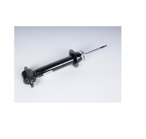

Yesterday I slapped on new rear shocks, I kept the PN from some research i did a while back.
Plan is to keep the "premium ride", so I sourced the OEM components.
Rear shocks are easy, and I had some help finding/confirming the correct PN for the front struts.
Codes I have,
PREMIUM SMOOTH RIDE CHAS PKG(ZW7)
6PB COMPONENT FRT LH COMPTR SEL SUSP(6PB)
7PB COMPONENT FRT RH COMPTR SEL SUSP(7PB)
Rear shocks resolve to: 25871225 aka 540-433
$69 each (went up by $1 :jester: )
Front Struts
20765171 aka 540-460
Price went up since I ordered them, I paid $86 each

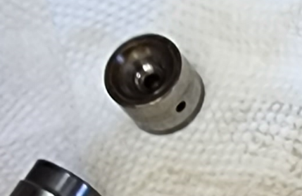

Otherwise, I need to remove another 5 thousands from my rocker shims/add more preload.

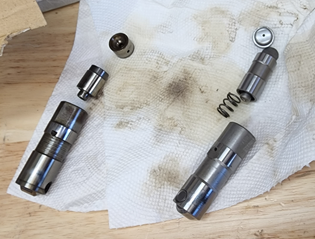

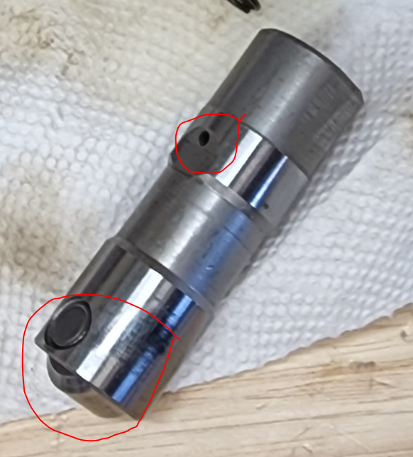

I also would love to dump those lifters.
I hate them. :violin2:
Extra oiling feature sucks ass.
and the preload requirements are confusing.
but I'm not wanting to touch anything again until next winter if I can wait.
+ I would need to source another head gasket.
I hear I can reuse my head gasket, but I'm not about to mess around with it.

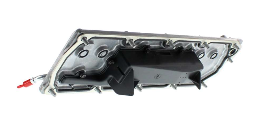

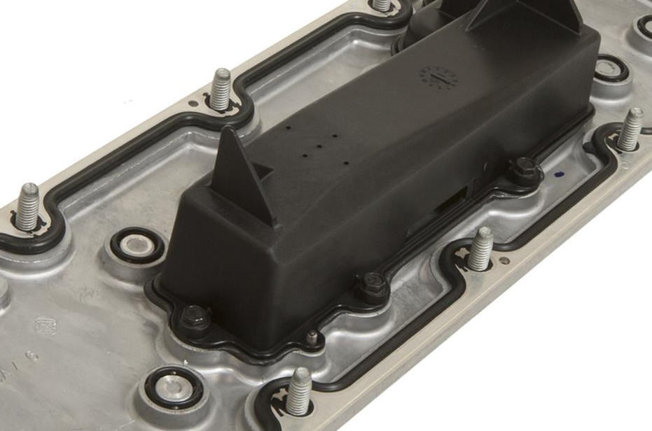

brings me to this thing.
Breather for the valley cover!
Seems deliberate to pick up air from the center and not pick up oil from the camshaft slinging it around.
It might help, assuming the lifters are just pumping and spraying the top of the valve covers with oil.

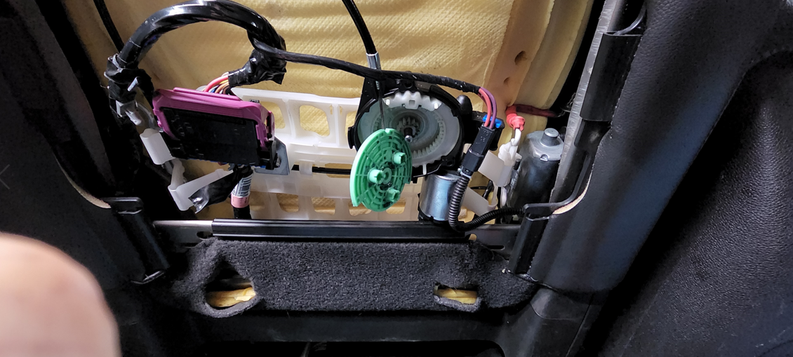

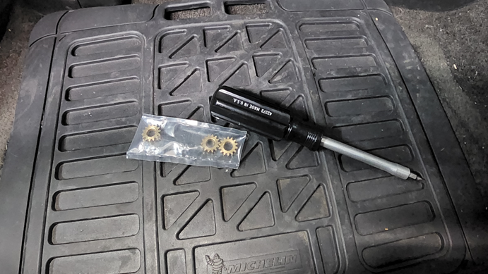

And i received my lumbar support gears about a week ago.
I haven't yet dug into the seat to start the replacement, but I plan on doing that soon.
But probably not this weekend.
I was sort of hoping they would send a new "Ring" or outer gear with the kit since mine has a split in it.
but no such luck.
I think I'll glue it and toss it in the passenger side when I get around to it.

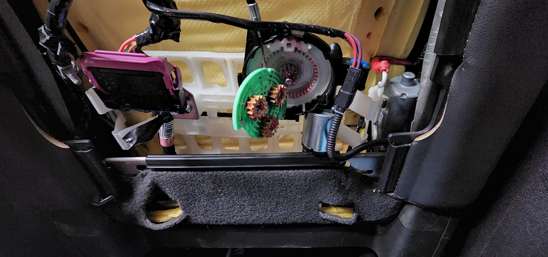

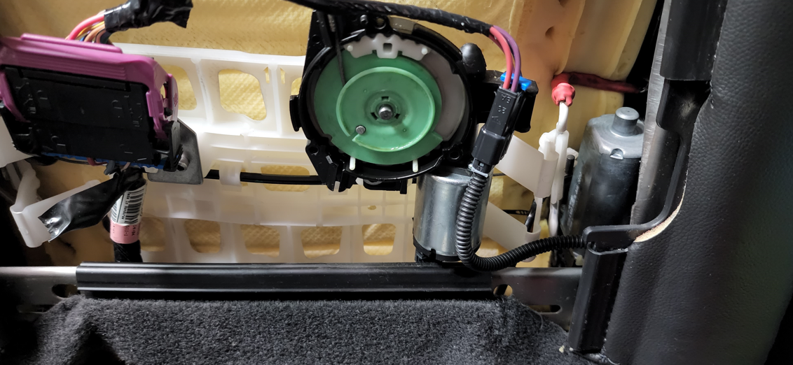

So power lumbar...
this was really easy.
First thing is you need to pull the seat back off.
Covered in this video: @ about 22.22

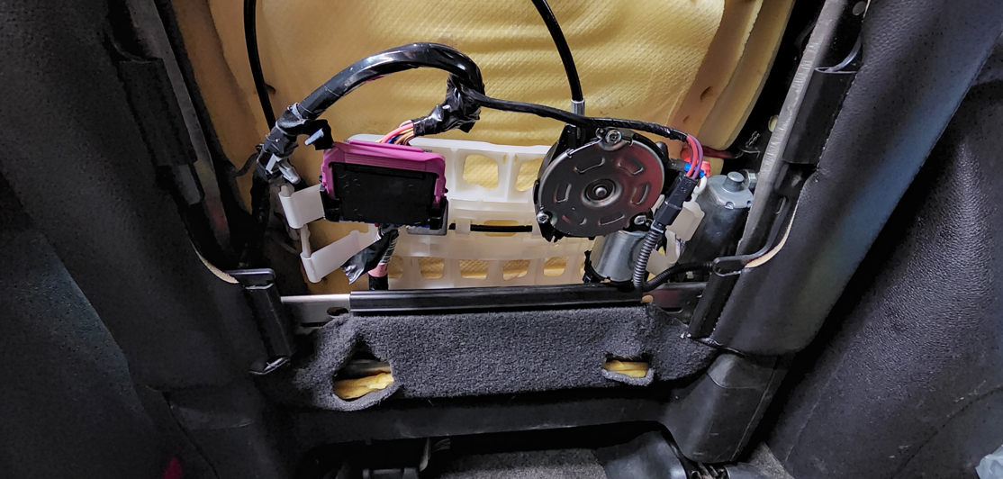

Once you have the back off.
you're going to have something like this.
Screws to that cover are those weird square bit that every dewalt toolbit set has had a bunch of, but I never find any actual use since most things are torqx now.
https://www.gruvenparts.com/ replacement gears,
Cover removed,
Green thing removed,
There were little bits of white gears sitting in here, but I already cleaned it out last time i had this apart.
New brass gears installed; I added some lube, so they functioned smoothly.
It took some work to get the gears to mesh and for everything to go back in, I used a small pick to rotate the gears until it was wanting to line up.

I'll also add that this the "Ring" or outside white gear in the image has a split in it.
Like it had too much pressure at one time, and it cracked under the strain, then likely turned the little white gears into powder/goo.
I reused that gear.
So far, I don't see any negative effects, and the lumbar seems to be working just fine.

Ok so a decision has been made...
I tried adding thicker oil to see if it helped the lifters, and that's a "sort of".
Now I think it's acting like I have too much preload...
:yaoface2:
So, I'm going with the lifter change out option using the ones above.

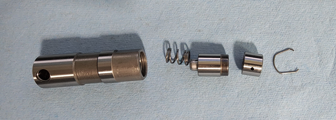

Fun little thing about these lifters, they are still LS7 lifters in the bottom, but they are identical to the original non dod lifters in every way.
I discovered this while cleaning the new lifters to prepare for install later when I'm motivated to tear into things again.
One of the retaining clips came off and went into the void in my office, so I went hunting for a replacement and found it with the original high mileage lifters!

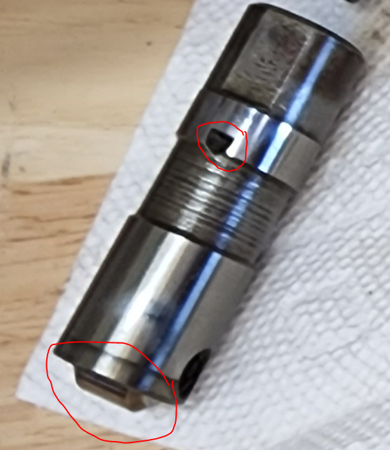

Example,
Original lifter on the left, and a lifter identical to to the ones i have currently installed.
Main differences is the oil feed hole.
On the original lifters, the feed hole is lined up with the roller
Then the pushrod feed hole is on a solid machined piece, the oil feed hole being on the side
From my Original lifters + the new lifters, this should be pointed away from the oil feed hole in the lifter body.
Just Fishing
Just Fishing
Can't fix stupid
Aug 30, 2020
4,499
10,114
Utah

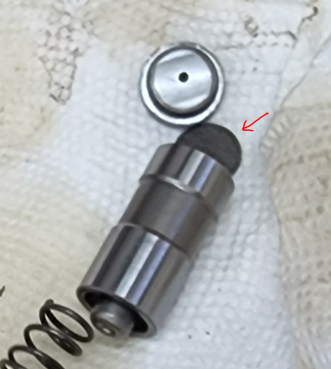

Then the current lifters,
Feed hole is on the side of the roller.
Oil feed comes from this little restrictor plate.
New lifter,
Identical to the originals, even down to the retaining clip!
And just like the originals, the fitting is very tight.
it takes a little effort to get everything to come apart and slide back together again.
Clearances seem a bit tighter throughout the whole set.
I also read that your supposed to line that lifter body oil feed hole directly into the oil gally.
Something I got from the corvette forum, and as long as they are installed correctly, they should hopefully quiet my valvetrain down.

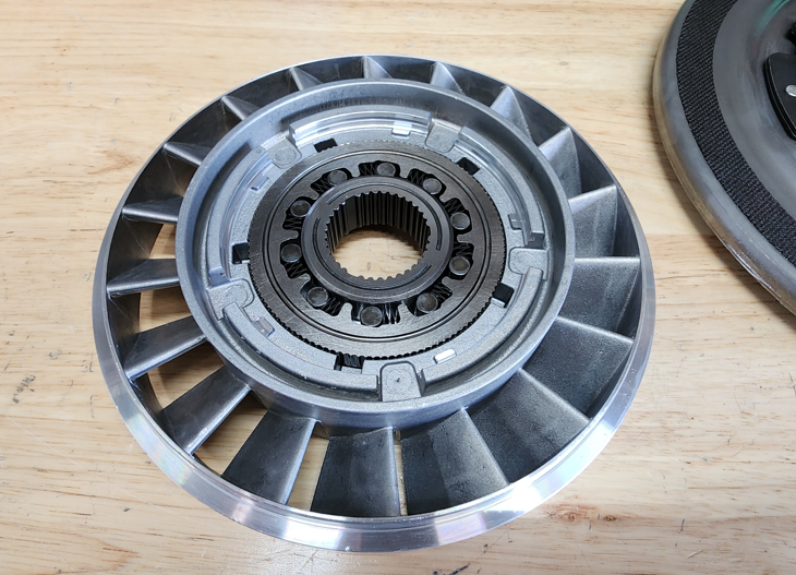

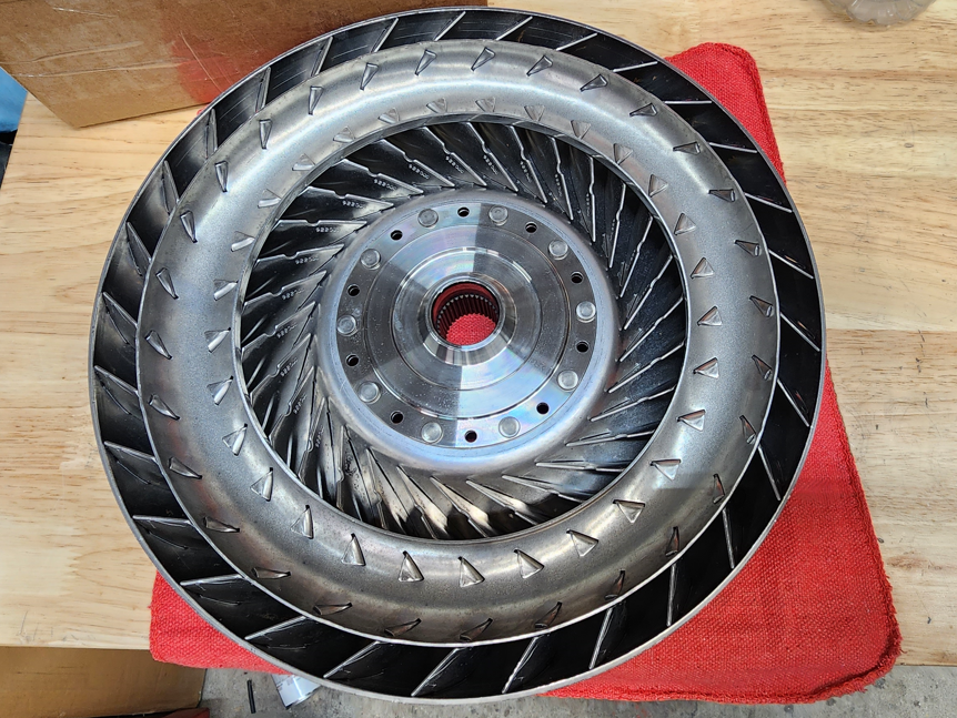

I spent some time opening up my old/orignal tourque converter to see what kind of condition it was in, plus I wanted this fancy little part for a wall hanging or clock.
One thing I learned, cut the weld.
I opted to do that after watching some youtube videos.
I went through 3 cutting discs with my die grinder before I broke out the Sawzall.
Once I drained my three Dewalt standard 20v batteries, I migrated to the airsaw. :jester:
Getting that weld out is important as the two outer halves are sandwiched together and fit with some pretty tight precision.
I cut through the weld, and through the inner wall.
Left with just a ring that I had to remove in order to pull the part out above.

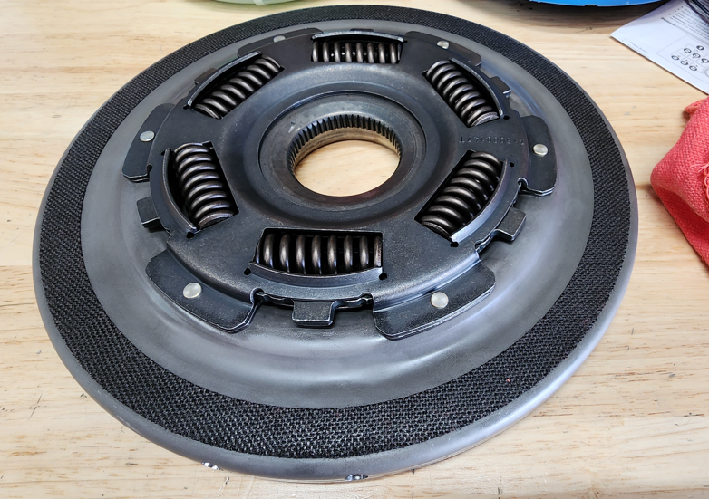

Here is the original clutch.
Has some material left!
Overall everything was in pretty good shape.
Meaning I don't believe the trash I found in the cooler lines came from this converter..
Another part that sits between the two turbine halfs rides on a bearing on both sides.
I pulled the cover off of it to show the inner one-way clutch/sprag thing it has.
interesting setup, I haven't fully wrapped my head around how the lockup clutch applies, however on the back of the clutch disc, there is a billet looking piston thing that the input shaft appears to seal on.
Without the transmission apart I can't see how it actually functions, but it seems pretty simple.
The converter body half has some pretty cool looking splines, but I tossed that, it's too big and heavy to do anything with.

New lifters going in with that, plus I'm changing the PCV setup to that of one for a corvette that pulls gasses from the valley vs the current valve cover.
I'm planning to allow air to suck through both sides of the valve cover vs just the passenger side.
I'm hoping that will help with oil flow back into the pan, plus keeping the rockers nice and clean looking.
