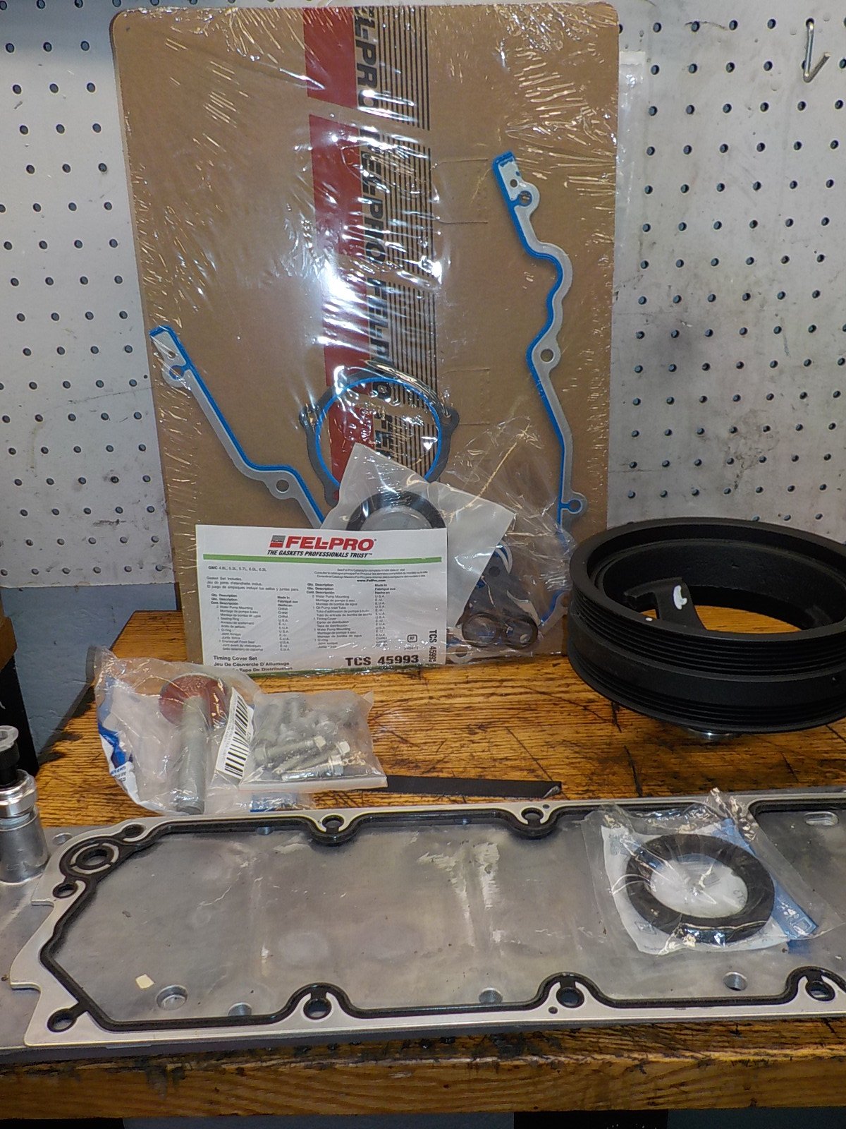

Okay non-AFM valley covers... When I bought my kit, I didn't really understand what all I was buying, and now in hindsight, I see that the shop I bought from was out of stock on the covers. All I'm finding in stock are weird Amazon stores or verrry expensive stores. Anyone have a recommendation for a reputable part that doesn't break the bank?
OR should I just use the block off plugs and replace the gasket on the OEM cover? Would that do the trick?
donjetman
Oct 22, 2018
1,975
3,615
Amazon non-afm valley cover w/gasket and bolts for $56 is whats on mine :)

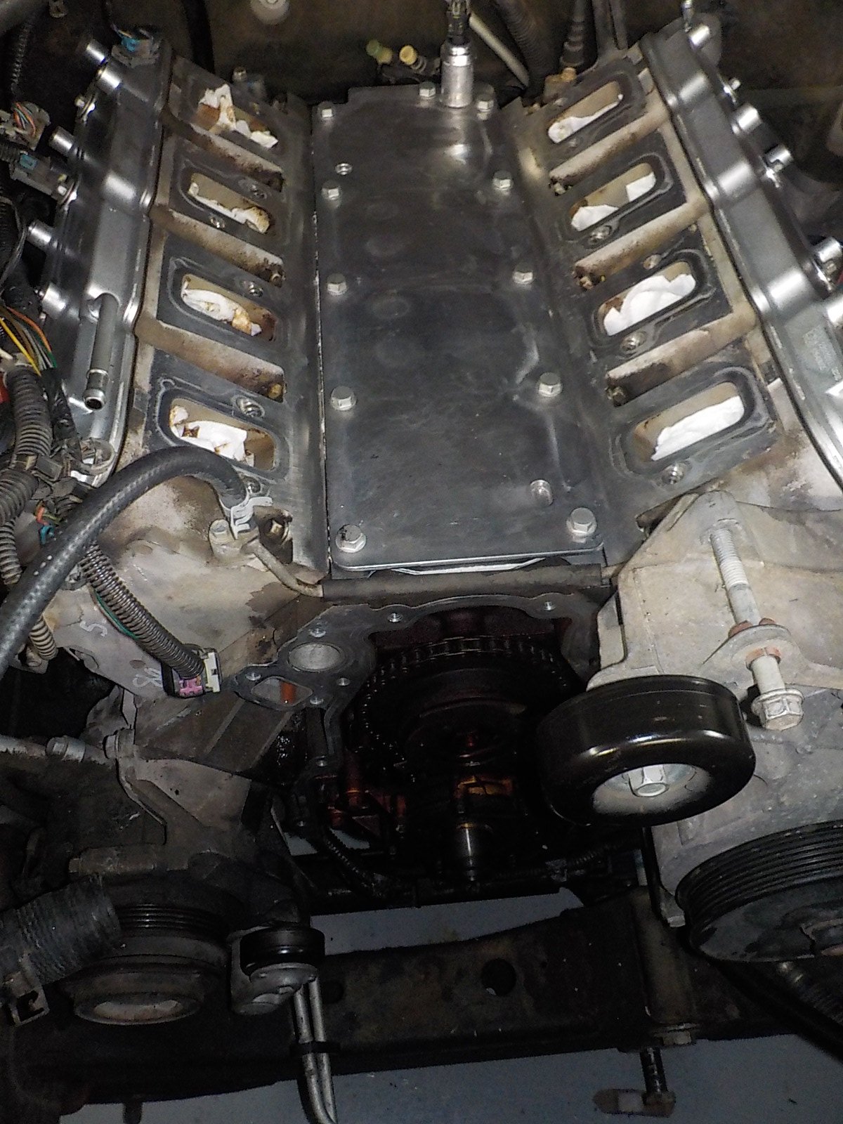

Well, here we are... reassembled. A few things:
1. It's idling like total dogcrap. Is there something in the tuning that turns off the VVT, or does that happen when you change the timing cover that's non-VVT and tune it to delete the AFM? Throwing a P0010 code. There was no place for the plug to go on the new timing cover, so it's just tied up, unplugged.
2. I'm guessing maybe I have an exhaust leak...? Totally getting the "glub glub glub" sound out of the exhaust pipe in the rear. Also throwing a P219B code. In this process, I had to remove one of the O2 sensors on the passenger side, but I am 100% sure it's reinstalled and plugged back in. I also couldn't see where any vacuum leaks would happen, though I guess it's reasonable to think I missed something.
3. Turns out I'm not a "while you're in there" kind of guy. I regret this decision so much. I wish I would've just taken the one head off, replaced the broken lifter (or even the set of 4 on that section) and just risked the cam. This has royally sucked. It's all back together, still throwing codes, pretty sure I have an oil leak somewhere. I can't believe people do this as a hobby.

You will need a tune to turn off codes for AFM and VVT.
If you have not turned off AFM in tune (?), that could be why it's not running right.
No it's definitely been tuned to turn off AFM. My guy with the EFI Live tuner did not see any place where VVT is mentioned. He did say he thinks they call it camphasing, which he did disable. That's where we got with the tuning.
