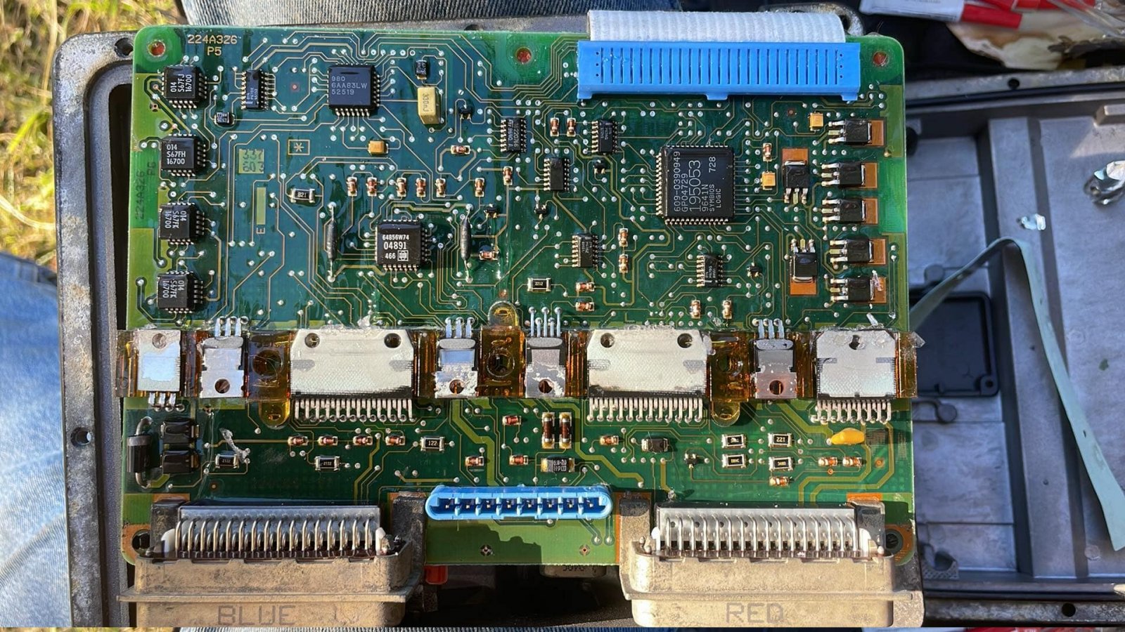

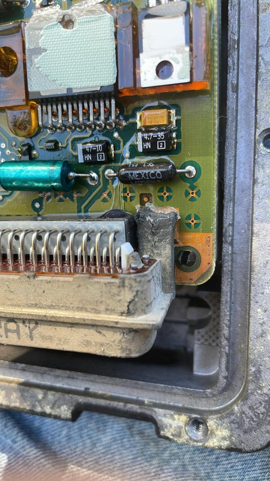

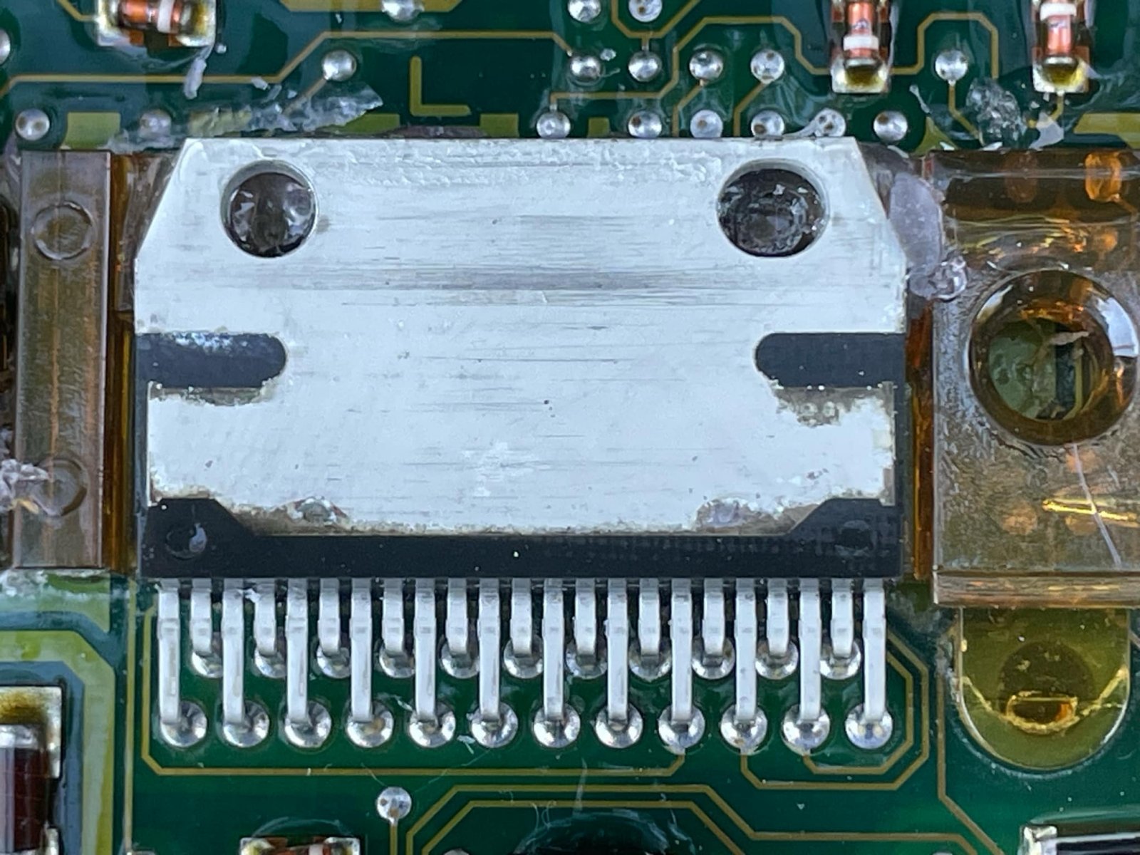

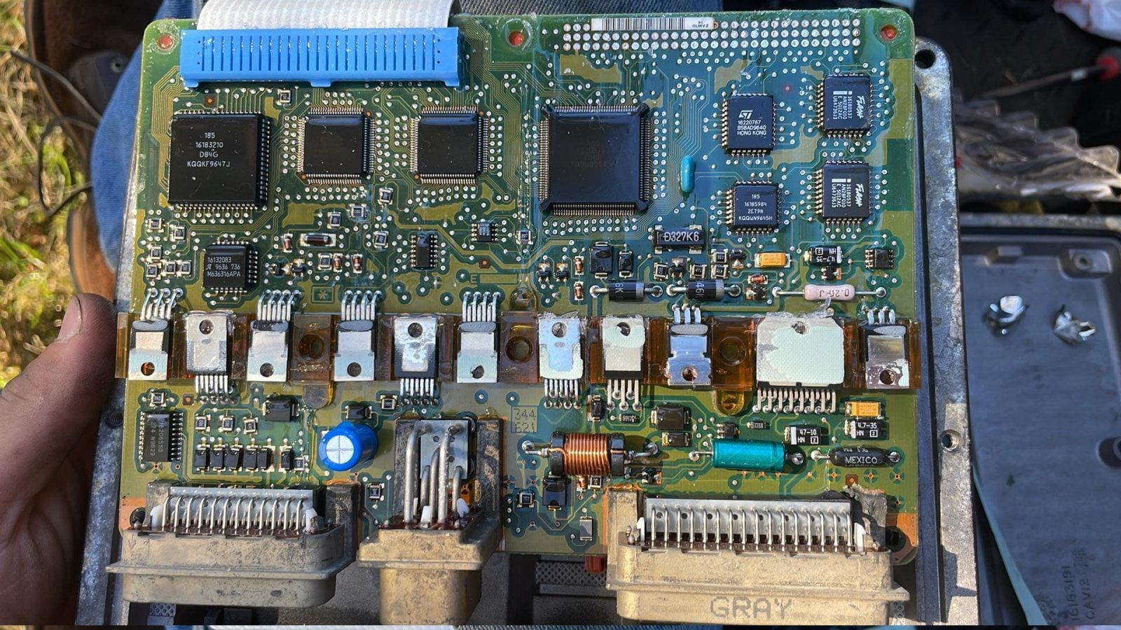

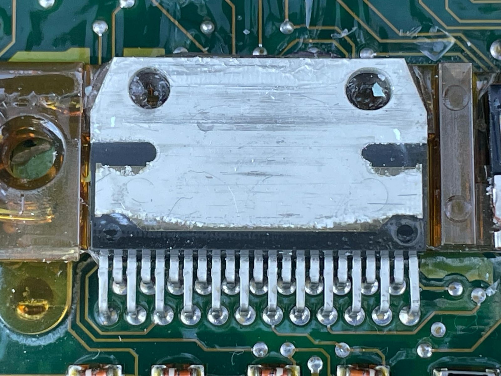

At this point I am thinking it's an ECM issue, so today I pull the ECM to crack it open and just see if I can tell any obvious issues. No bad resistors or capacitors that I can see. No burnt spots on the board. One of the connectors where it connects to the board looks to be cracking but the other side is solid where it connects. A couple of the chips seem a bit discolored to me. I'll post pictures below. I clean up the original thermal pads and reapply new thermal compound to all the chips and mosfets that use the case for heat dissipation. Close it back up, throw it back in, truck won't start. No fuel pump. I jump the relay manually and the pump runs. Truck fires up, missing and throwing white smoke. Interesting note, the AC is now working, but the truck is running very poorly and I now have a new code - P1345 Camshaft to Crankshaft Position Correlation Fault. At this point I feel fairly confident in the ECM diagnosis, feeling the issue is too consistent for a wiring problem, and not knowing of anything else it might be. However, if you have another idea I am all ears.
