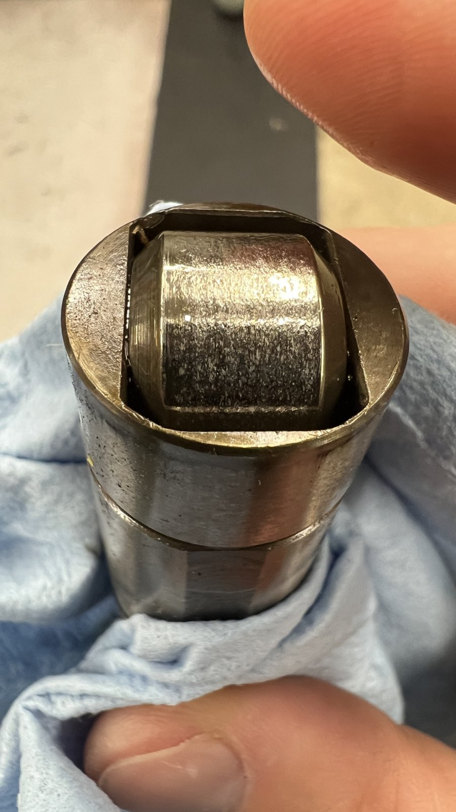

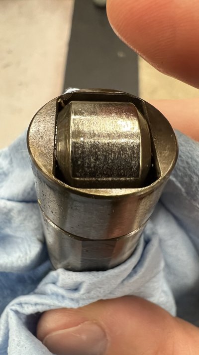

Blackcar
Mar 31, 2018
925
871
Got picture of roller lifter that came out of that position.
Dustin Jackson
Aug 9, 2018
1,788
2,065
I imagine the parts of the cam that contact the bearing are even worse.
Blackcar
Mar 31, 2018
925
871
Yep. Here's the pic. And video of me rolling it.
After looking at the lifter I would replace cam but doing that all lifters should be replaced then after that you have to wonder about doing a complete VVT delete.
All that’s left is the radiator, water pump and timing cover at that point. Maybe another hour of disassembly (only one or two beers) since you had to drain the coolant to get the heads off anyway. Granted, there is an escalating parts cost and I don’t know your finances, but the smart money in the long term is with new lifters, OEM trays, and a good sleeper cam for durability.
I’m really happy with my setup since I did the DoD delete back in 2021. I have to remember to keep my foot out of it or passengers get whiplash pulling away from a light.
Also, I’m always happy to help others spend their money.
