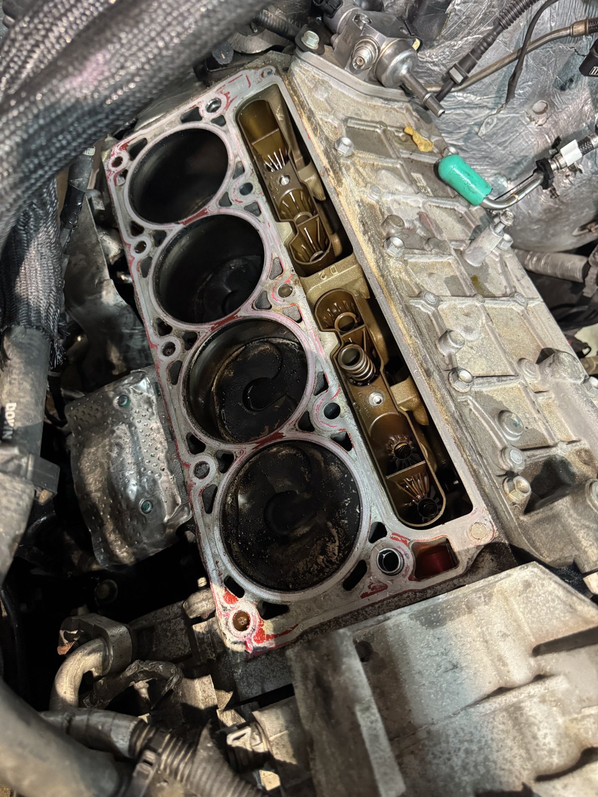

Hello I am a new member here and I have not owned a GM Vehcile in about 20 years. I just acquired a 2018 Denali with multiple issues with the AFM system. I pulled out 2 bent push rods, 1 lifter that came out in 3 pieces, The cam shaft has enough wear that it's getting replaced. I crunched the numbers using all GM OEM parts to repair the system which includes a new VLOM vs buying a delete kit. At this time I was considering the AMS Racing kit which includes a Diablo hand held programmer. The price to either repair vs delete are about 150.00 only in total.
I am curious if GM has updated the AFM/DOD parts since 2018 and if they are any more reliable. I am big on keeping things OEM but with this AFM system having so many issues I am considering deleting. I understand it would lose about 8% MPG on the highway or under light load. Not sure if the fuel savings over time would be worth it if this AFM system fails again. How has the reliability been after replacing the damaged AFM parts over time. How many miles have people been getting or is this simply still a gamble? If I do delete what is the opinion on the Diablo tuner vs paying someone or purchasing HP tuners setup? I need to make this decision very soon as this Yukon is tying up my bay and I need to order parts. Thank you.

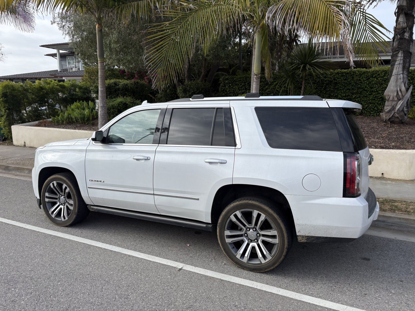

Pics of the truck, please.

Thank you! I ordered a full delete kit today from AMS Racing along with about 100 other parts from the dealer. I own a Jeep shop and I have been dealing with Chrysler parts all these years. I cannot believe how inexpensive GM parts are in comparison I am literally blown away! Someone asked for pictures it really looks like any other one but here are some. It broke down in California and I paid to tow it back to Maryland since the price was right. This is for my wife to replace her Minivan so she can drive something and have pride and actually move out of its own way.

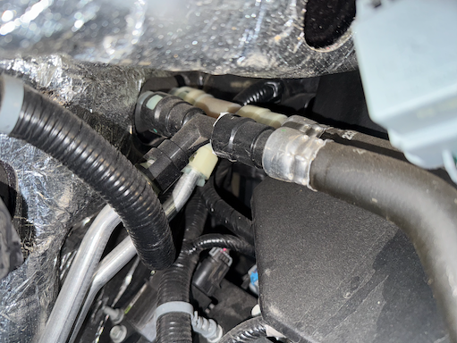

While you are in there and have the room to get to them, replace the heater hose firewall Tee's with metal ones.

Just a few things that might be helpful:
Dropping a valve seat on these does happen but it's pretty rare and usually only happens as a result of overheating. The plastic coolant tees at the firewall are notorious for disintegrating after a decade or so, and when they go, it's usually on the highway or sometime when the engine is putting out a lot of power and generating heat and pressure in the system, so the instantaneous loss of coolant causes the engine to overheat almost immediately. Some have said that that they dropped a valve seat when they pulled off the highway at a rest area while towing and immediately shut the engine down, resulting in a temperature spike in the heads. Others have said that failing to get all of the air out of the cooling system after a flush caused hot spots in the heads. Still others have had it happen spontaneously. But either way, preventing any overheating on LS/LT heads is your best risk mitigation strategy.

They go here (photo is from a 2018 Suburban 3500 HD, but the Yukon Denali 1500 will be the same):

Thank you for posting that information. I added them to my wish list to research later today or tomorrow. I am not a fan of plastic parts. How have the Dorman parts been holding up over time? Today I pulled the diff out along with the oil pan and oil pump , front cover. I am waiting on my delete kit to arrive. my only real constraint is I am tying up one of our bays.

This was one of my good customers Vehcile. He lives here in MD but lives in CA during the winter months. Cyl number 4 bent a push rod and the roller on the lifter did some damage to the cam shaft lobe. The lifter also came apart in 3 pieces when I removed it. It melted the catalytic converter to the point where the engine would not even run. I found another bent push rod on #1. once I unbolted the exhaust it fired right up and I was able to hear the ticking noise over the loud exhaust. Because the AFM delete requires a new cam shaft and lifters I had to make the choice to repair or delete. Some videos I watched claimed about 8% MPG loss at highway speeds where the engine goes into 4 cylinder mode. is 8% not accurate? someone mentioned this earlier in this thread. I am more concerned with reliability over MPG. I do not want to do the job again. the AMS racing kit includes a Diablo handheld programer which I am familiar with as I have installed super chargers on Jeeps and that is what they often use. It's not bad and it can do some other features. I did not want to invest in HP tuners as they charge for tokens or something like that each time you program a vehicle.

People used to have problems with the Dorman tees not lasting as long, but I haven't heard of any problems with them in the last several years. FWIW, I've been running a set of Dorman plastic tees on my 2012 since early 2021 and no issues over lots of heavy towing miles. I'll replace them with the aluminum versions in probably 2028 or so.
