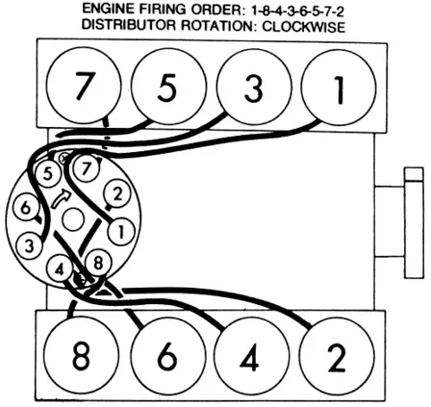

I’m sorry you are having such a hard time with this. You said you had the spark plugs and wires replaced. This is a shot in the dark, but…. See if the plug wire for #5 and #7 cylinder are plugged onto the wrong spark plug. It is “Very” easy to install these wrong. There should be numbers at the distributor cap. #7 wire has to go furthest spark plug back to the firewall on drivers side. #5 has to go just forward of that plug drivers side. I usually have to touch the wire and keep touching it as I follow it from the distributor to the plug. Don’t give up!

You mention changing the plug wires. Have you verified the cap to plug order is correct? I am sure you did but this was one thing changed right before the issue appeared.
Verify and eliminate the most obvious and easiest things first.

Gotcha. With all the events and parts that have been replaced, the story can get confusing and mislead the diagnosis. Throwing a bunch of parts at it can bury the root problem, so we gotta know how it was, what was done and the direct result all in chronological order.
So, the plugs and wires were replaced at the same time as the CKP sensor replacement. It's common to get a couple of the spark wires mixed up, but they'd pretty much all have to be really mixed up to cause a no start or to not allow even an intermittent fire ("try" to start).
As @wsteele said- double check the firing order of the wires. You also can't rule out a faulty CKP sensor, especially if it was a parts store special. GMs needs quality parts and the cheaper aftermarket copies tend to cause problems. Whoever AutoZone uses for their bottom-dollar house brand of aftermarket electronics parts has been well documented to be producing some junk.
