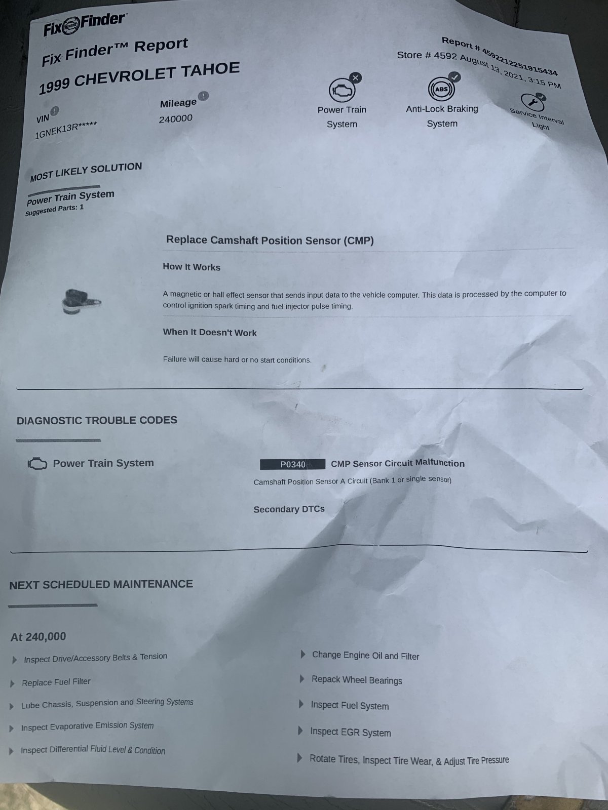

This is the print out. It was a code P0340

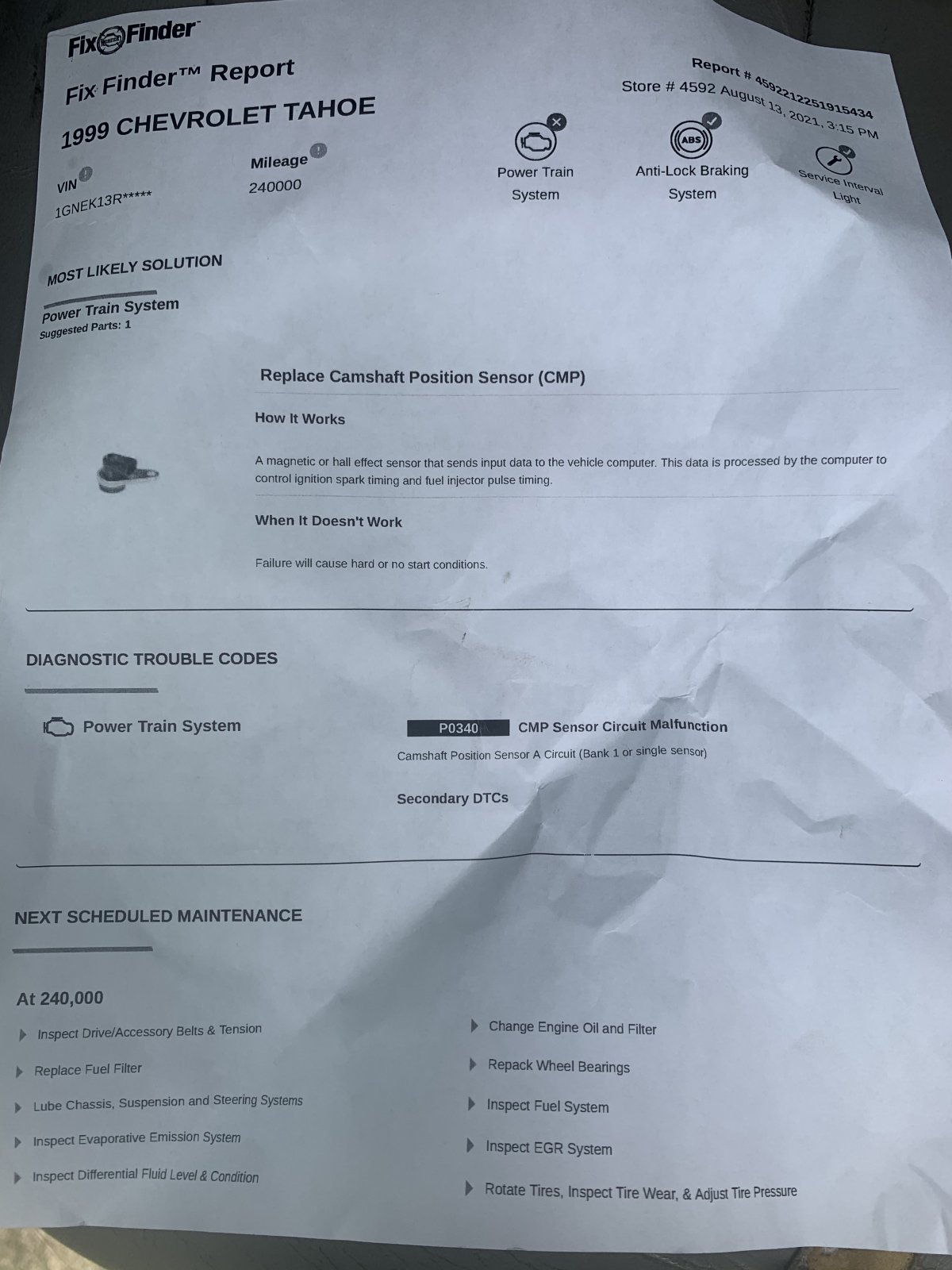

P0340 Code is cam posiition sensor in distributor. Was that code present before injector replacement? I hope you used a Delco Crank sensor.
It could possibly be a loose or chafed wire in the distributor at cam sensor, as dist must be removed for injectors. I believe that is one of the reasons P1345 was mentioned above. If P1345 still showing fix that first and cam sensor code may disappear.
