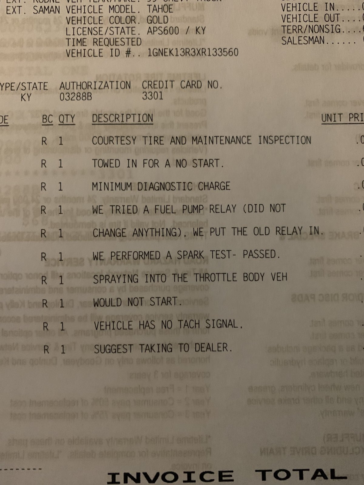

This is what Goodyear gave me! They said it past a spark test But no tach signal? What’s that even mean?!

I would hope that Goodyear would have verified that your Top Dead Center Mark, and your Rotor in your distributor were properly aligned, and that your plug wires were all correct before doing the “Spark Test”. I am baffled why they would not replace the Cam Position Sensor to clear your P0340 code. I feel that a no Tach Signal (RPM needle not moving on the dash) could be from one of these sensors not sending its signal. Going to a GM dealer may give you piece of mind that their Techs have the experience on these vehicles at this point.

Im Not completely sure what they did, according to the report, not much. They said they tried to swap the relay (nothing changed) and they tested for spark and it passed. But they didn’t say where they tested for spark or would that matter?
