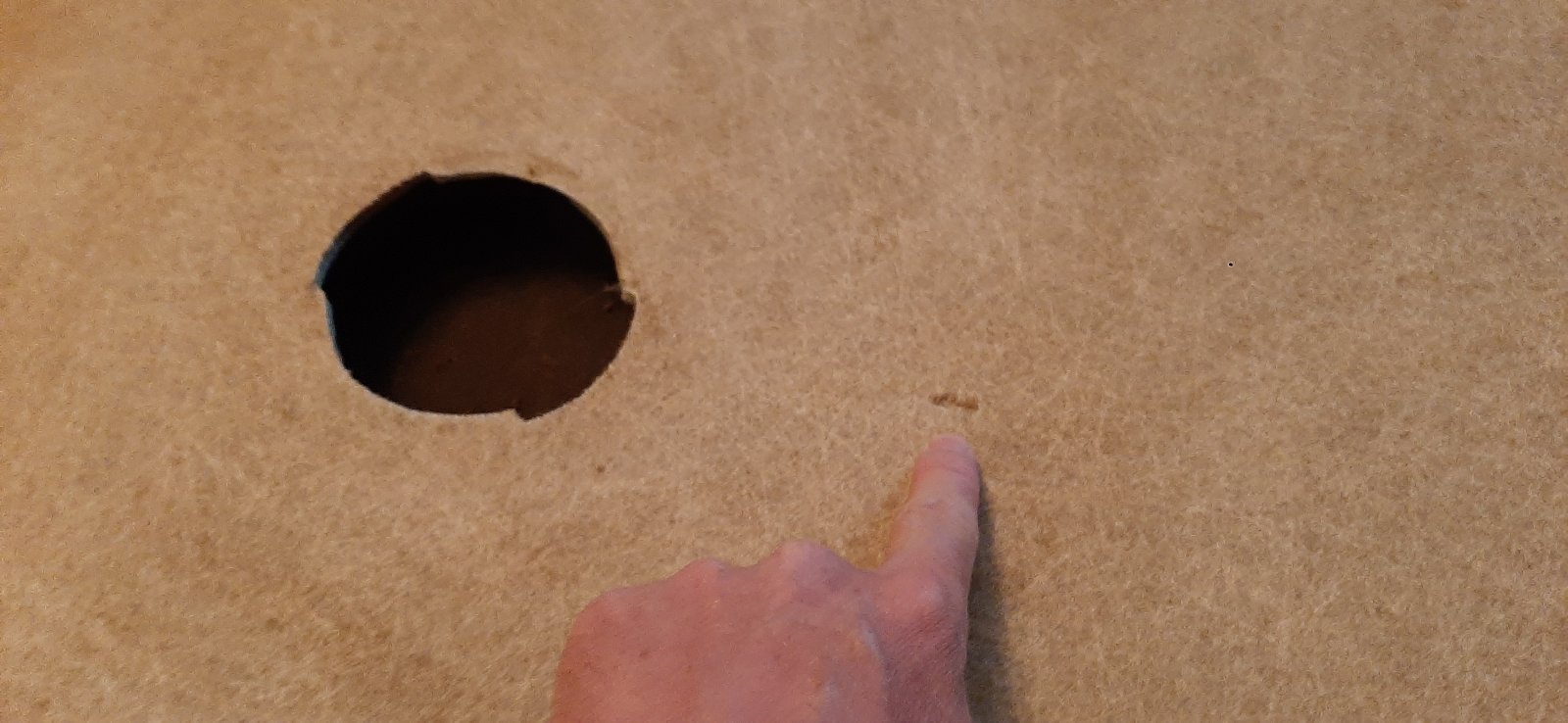

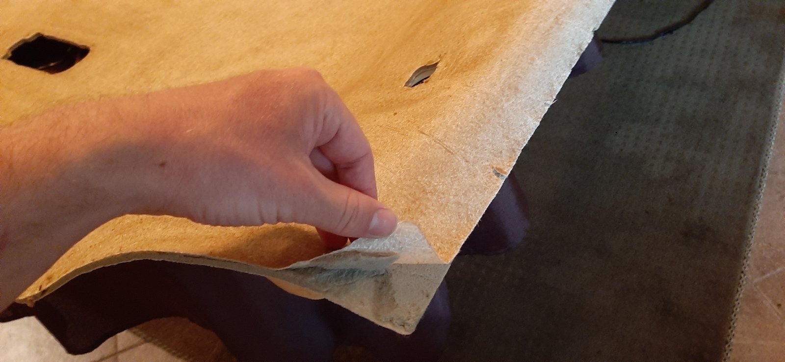

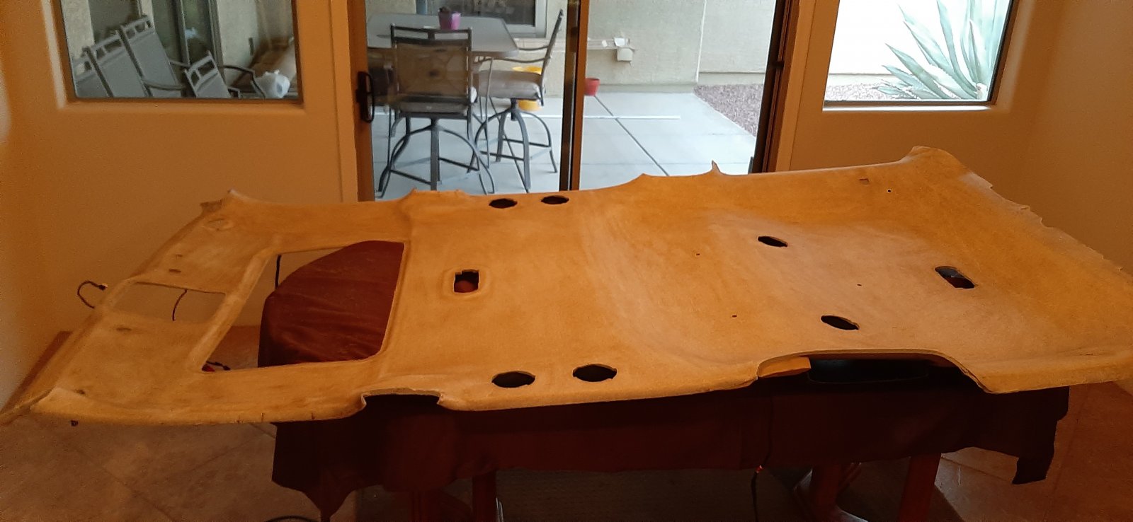

I'm getting there! Stripped old fabric off the headliner this evening. Couple questions:
1. It almost doesn't look clean, feels clean but doesn't look clean. There are dark streaks and lines all over the place. I tried to use a scotch bright to get it even cleaner. Is there a chemical wash I can use before putting the new fabric on?
2. I have some damaged corners. I had brought this up before, but is there a way repair some of these beat up corners?
1. It almost doesn't look clean, feels clean but doesn't look clean. Is there a chemical wash I can use before putting the new fabric on?

Dirty is fine, as long as it's smooth and clean of old glue and foam. I've never had to fix one, but I've heard of guys using fiberglass mesh to fix broken pieces.

I was thinking of going to walmart and getting fiberglass supplies like that.
I should elaborate, when I run my hand across the headliner there is a film / fjzzy feeling. However nothing really comes off with either the metal brush or scotch bright.
Sent from my SM-A505U using Tapatalk
33,185
51,399
Maybe it's the fibers from the board itself--from rubbing it with the steel stiff brush. Just be generous with the headliner glue. Spray both the board and headliner material--let them tack up 1st then press them together--don't get any wrinkles or you're screwed, you won't be able to peel it back to reapply. I like to use a plastic bondo applicator to smooth it out as I'm laying the fabric down.

A few things come to mind. For the busted corners, could you get some foam board the same thickness as the headliner core and cut little pieces to fill in where the core is broke or missing?
As for the fuzz, I have seen where folks will out a layer of very thin material like kraft paper over the entire headliner and glue that up and then put your finish material on.
Here is an article I found that talks about it.
http://theamcforum.com/forum/repairing-molded-fiberglass-headliners_topic50000.html
