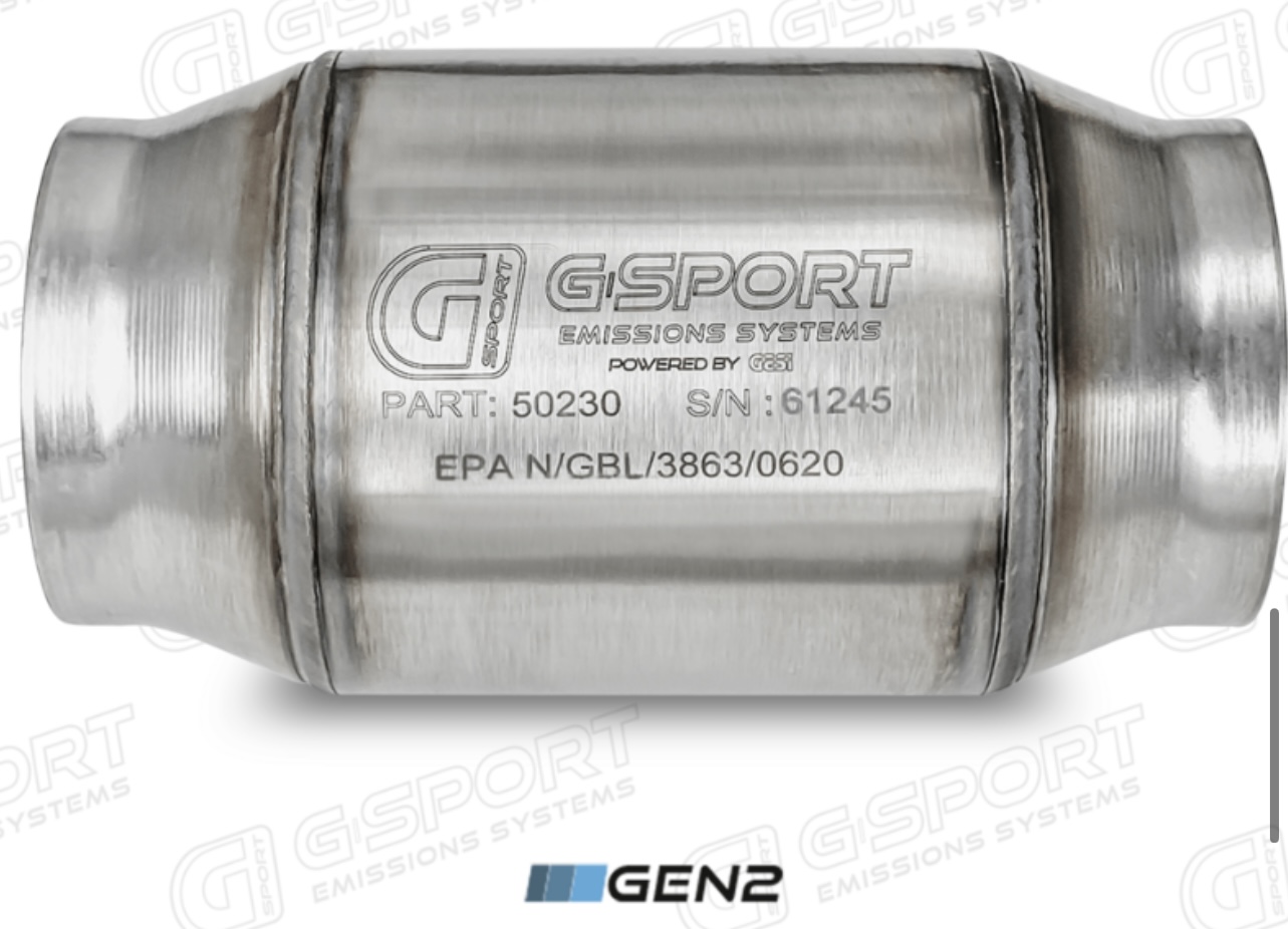

Anyone else put headers on? I’m looking to put a set of 1-3/4 with Gen 2 Gesi Cats and hopefully will be fine without a tune. Otherwise will fork out the $800 to HP Tuners

Looking to finally pull the pin and get some 1-3/4” to 3” headers with 2 x GESI 50230 cats followed by 3” Vibrant Ultra quiet Resonator and 3” vibrant street power muffler.
Is it enough having a single exhaust after the Y from the headers and cats? Or should I fork out the extra cash and have a H pipe and full double 3” with 2 x resonators and 2 x mufflers?
How big is the 'single'? Is it big enough?
There are turbodiesels making plenty of horses with a single pipe diameter big enough to hide a puppy inside of it (PLEASE don't).

Dual 3" pipes after the cats would be more than you need. It will just make it loud. 2 1/2" pipes would be better.
