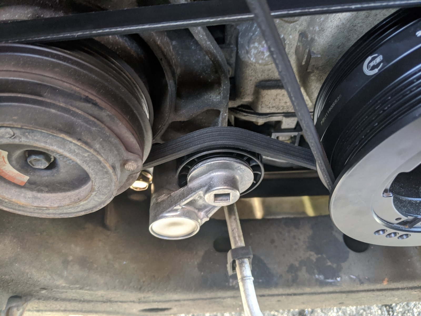

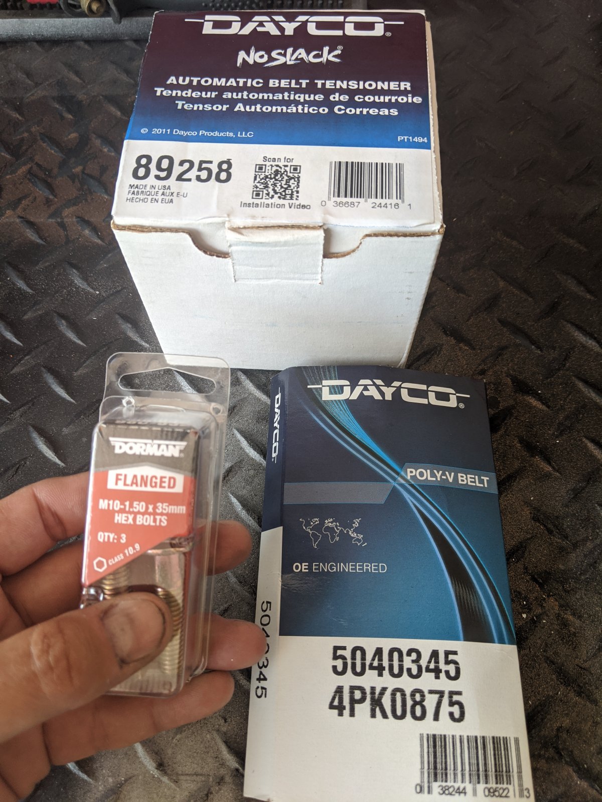

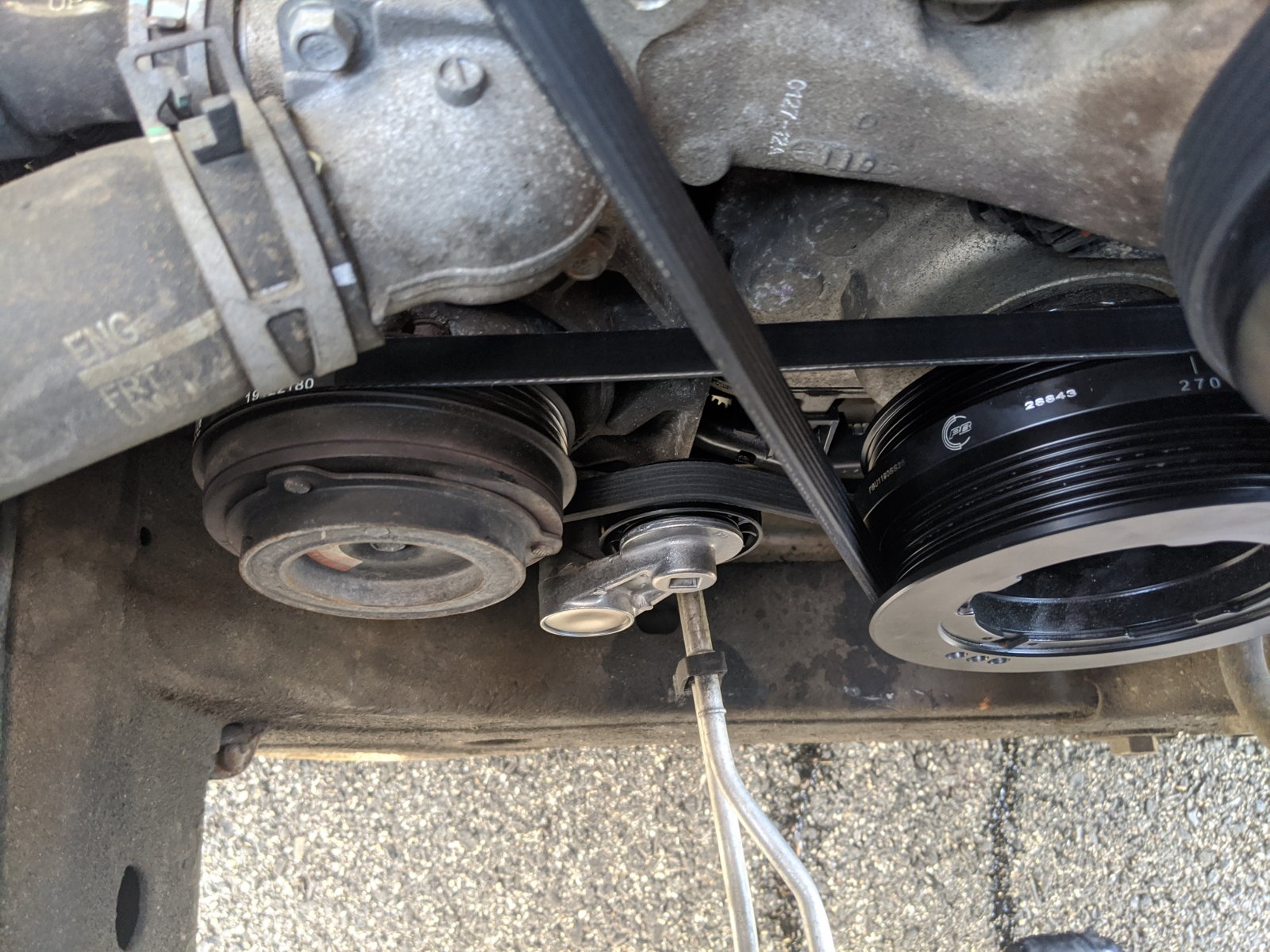

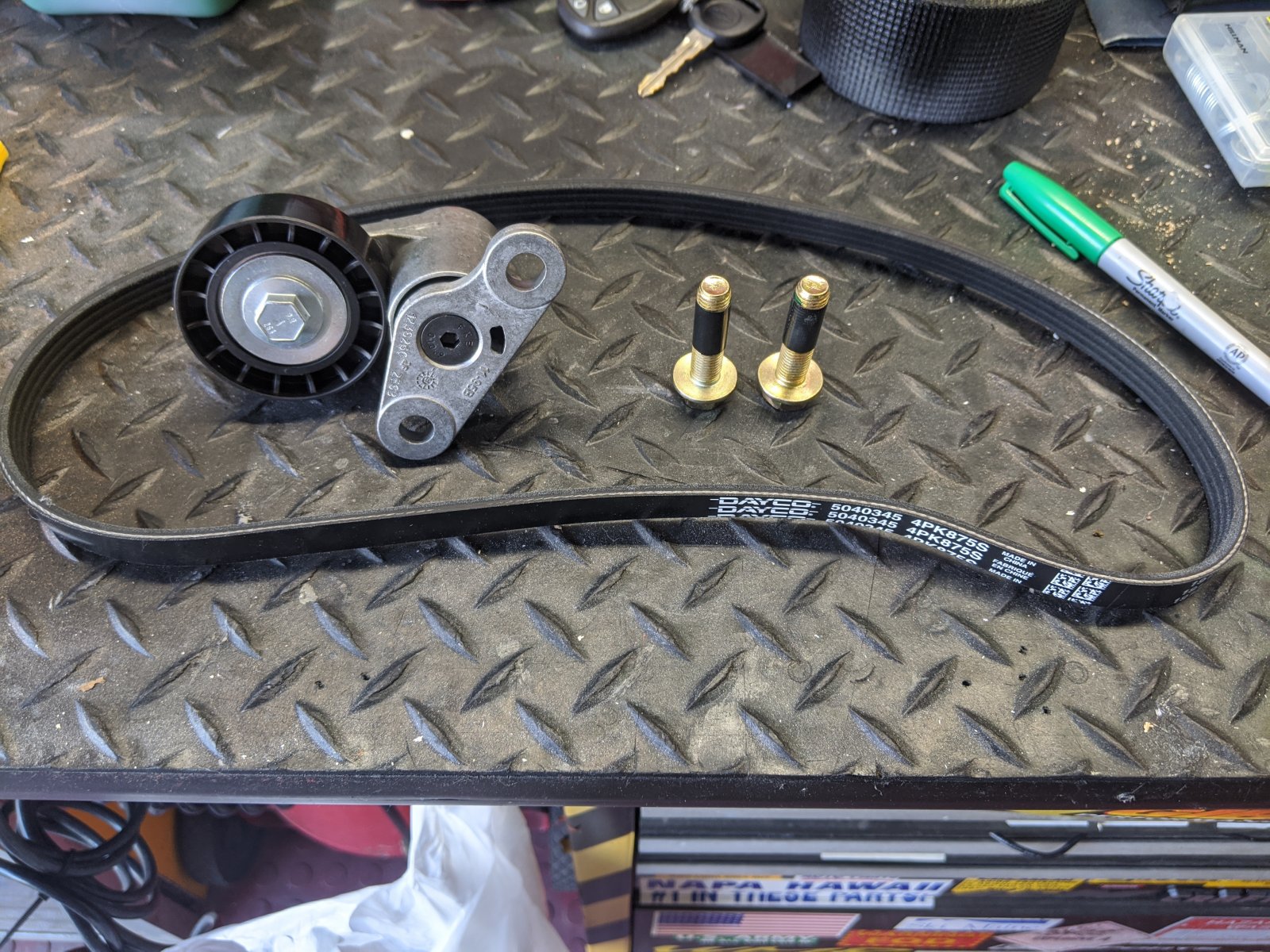

Well after the underdrive pulley install I was tired of the guessing game on the size of an AC belt (stupid ass slip belts). So I took a note from the old school LS motors. A belt with its own tensioner.
Parts numbers:
Dayco auto tensioner - 89258
Dayco belt - 5040345
Dorman flanged bolts - M10-1.5x35mm (2)
And I have AC again and all it good. Plus no more ****** around with stretch belts. One 15mm socket, one 3/8 ratchet and I can replace both belts in under 10 mins
IMG_20200516_102035.jpg IMG_20200515_160420.jpg IMG_20200516_102717.jpg IMG_20200516_102753.jpg

There's already threaded holes in the block for the tensoiner?
Sent from my SM-G973U using Tapatalk

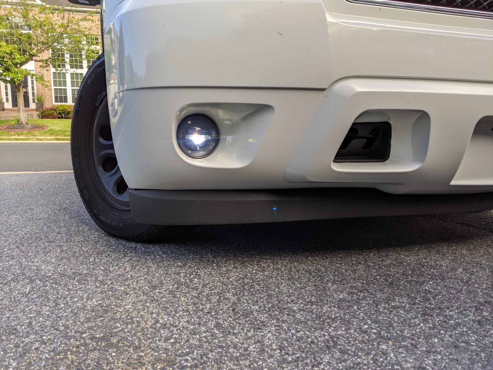

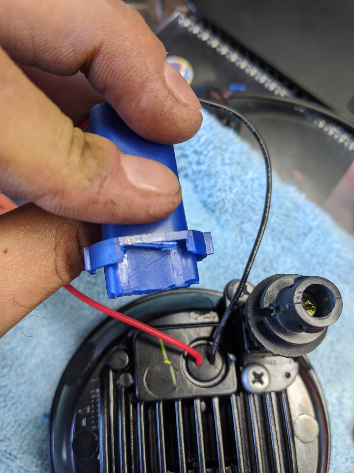

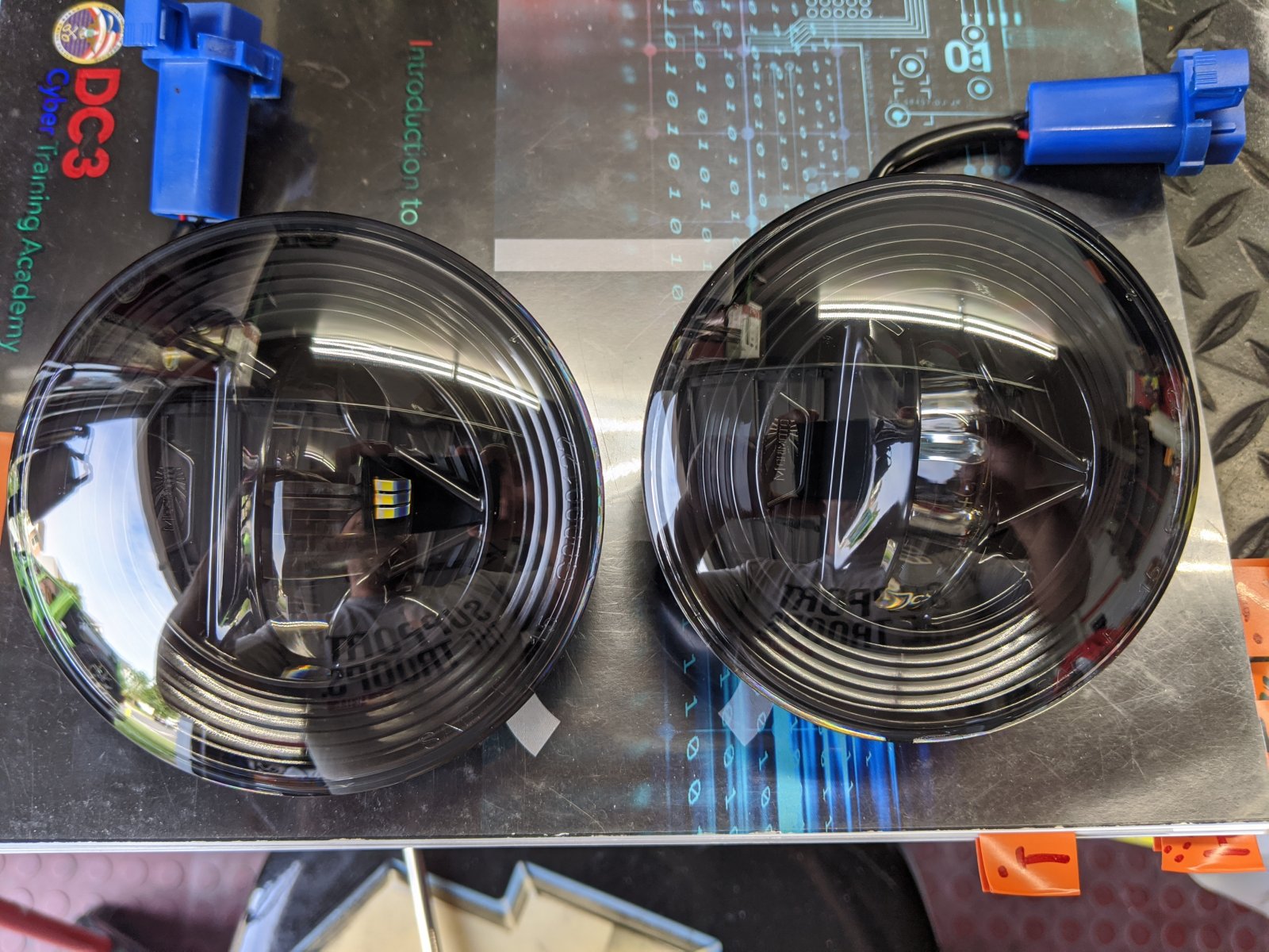

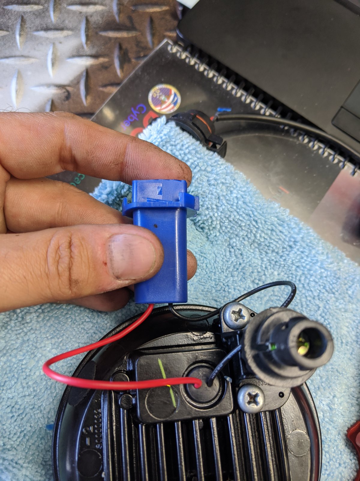

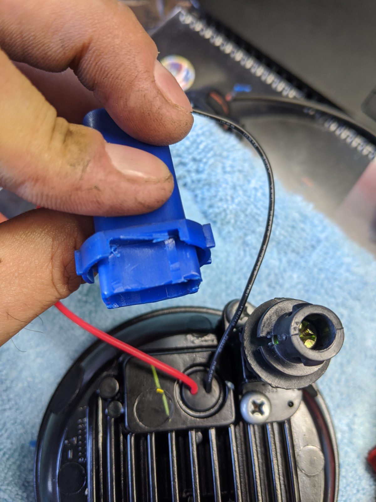

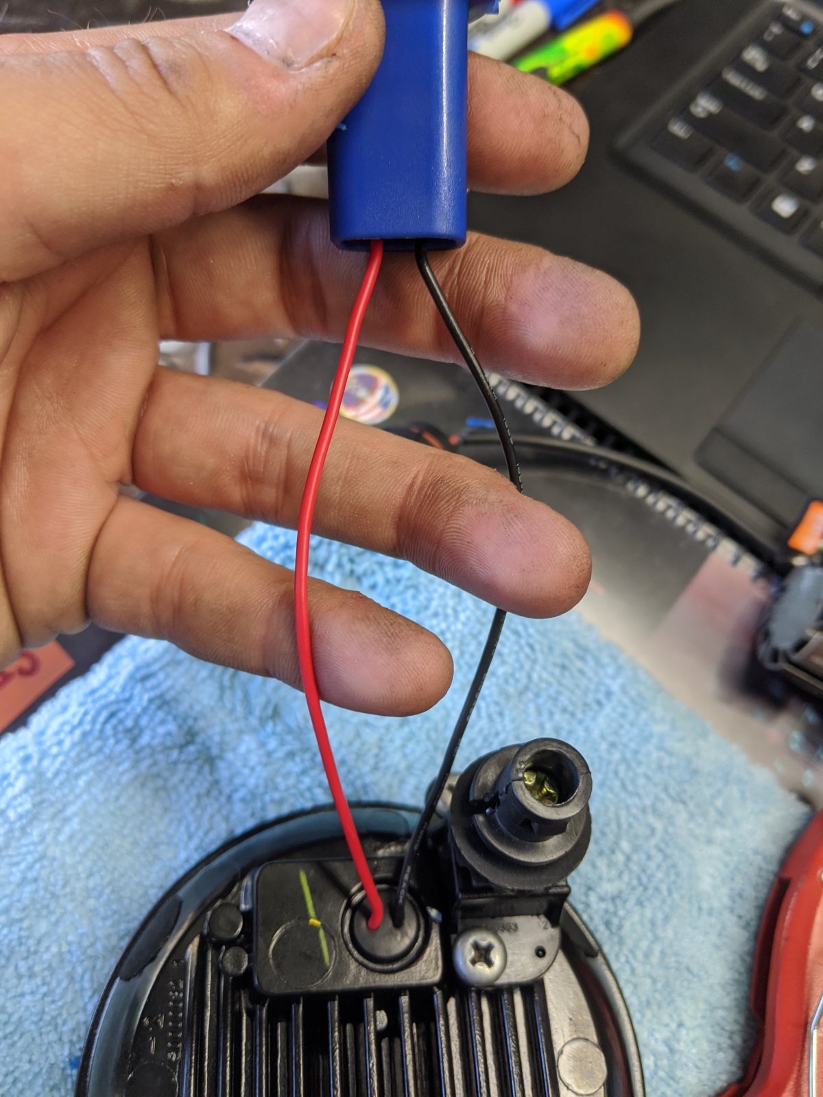

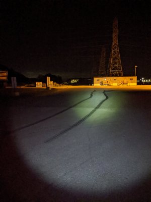

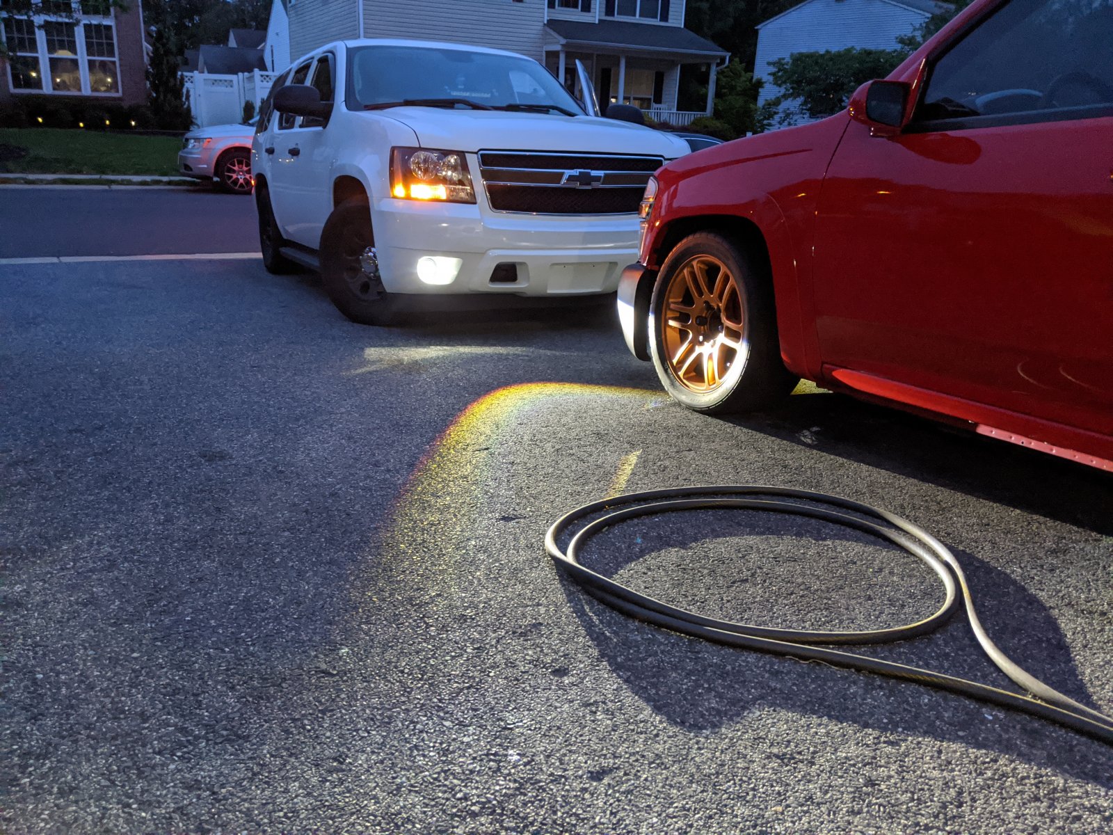

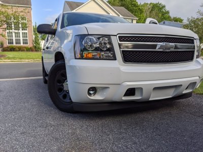

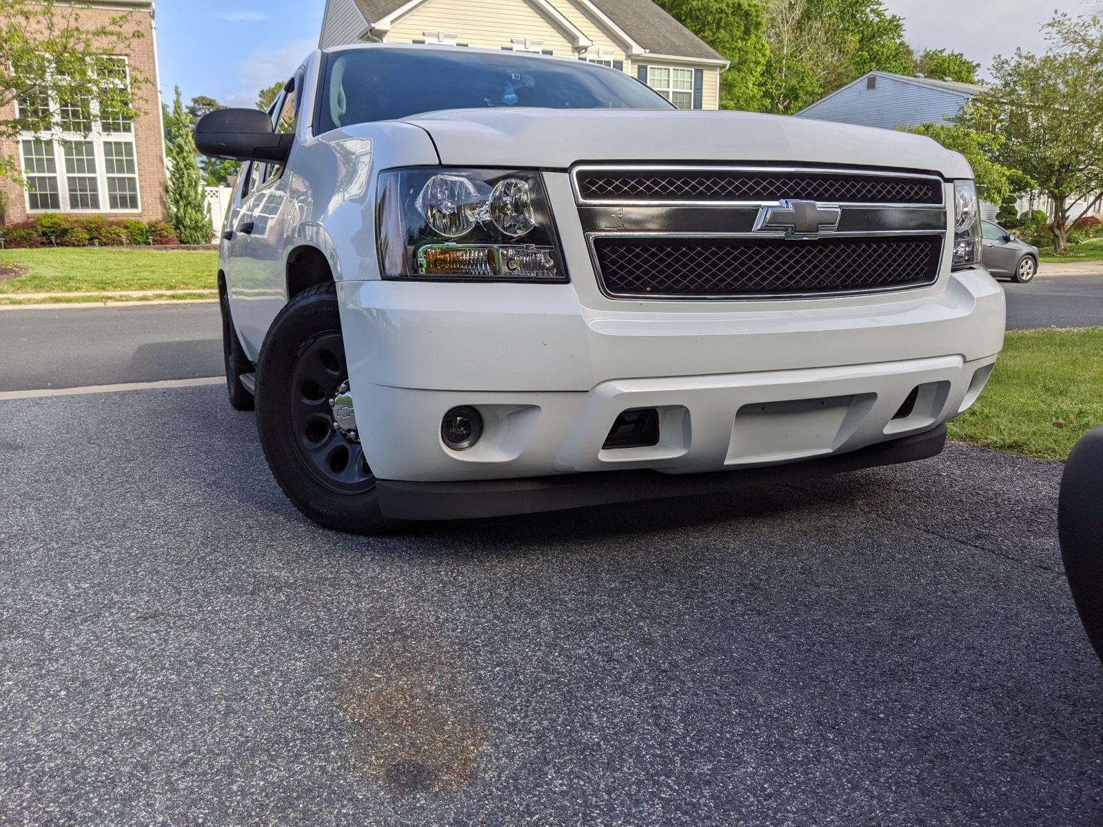

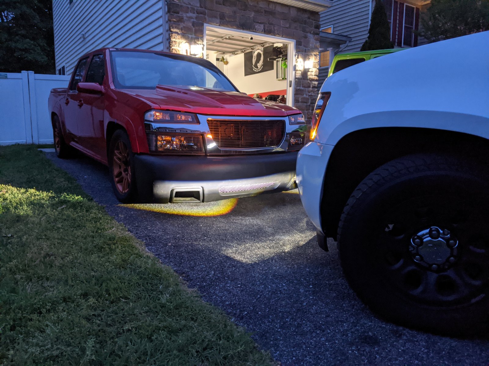

Well I bought the Morimoto LED projector foglights for my PPV. Here are my initial thoughts.....
Pros: look cool as hell and have a nice feel to them
Cons: the connector to the foglight harness was incorrectly wired. They would not fire up. So I bench tested them and......SOB they had them in reverse polarity. So I had cut/shave the connectors so I could flip them.
I have taken all of the pictures and will contact The Retrofit store where I bought them and see what they have to say or do. I'm a reasonable guy and I understand shit happens......maybe to one connector....but both. They have a problem in the QC department. If it was some cheap china shit.....OK, it was cheap. BUT no, I paid over $200 for these mofos; it should be plug and play gents.
More to follow, in the mean time here are some pictures. I only hope the light output is equal to or better then my previous set up.....cheap china replacement housings and some Amazon LED bulbs. If not.....these ****** are going back.

Lol, you ok dude? They do look good tho. Fit appears good also.
All good brother it had been a long annoying of teaching online then the wiring SNAFU...........a level mind and cold drink always come through LOL.
Just wasn't expecting to put my Tech hat on to do a simple remove/replace

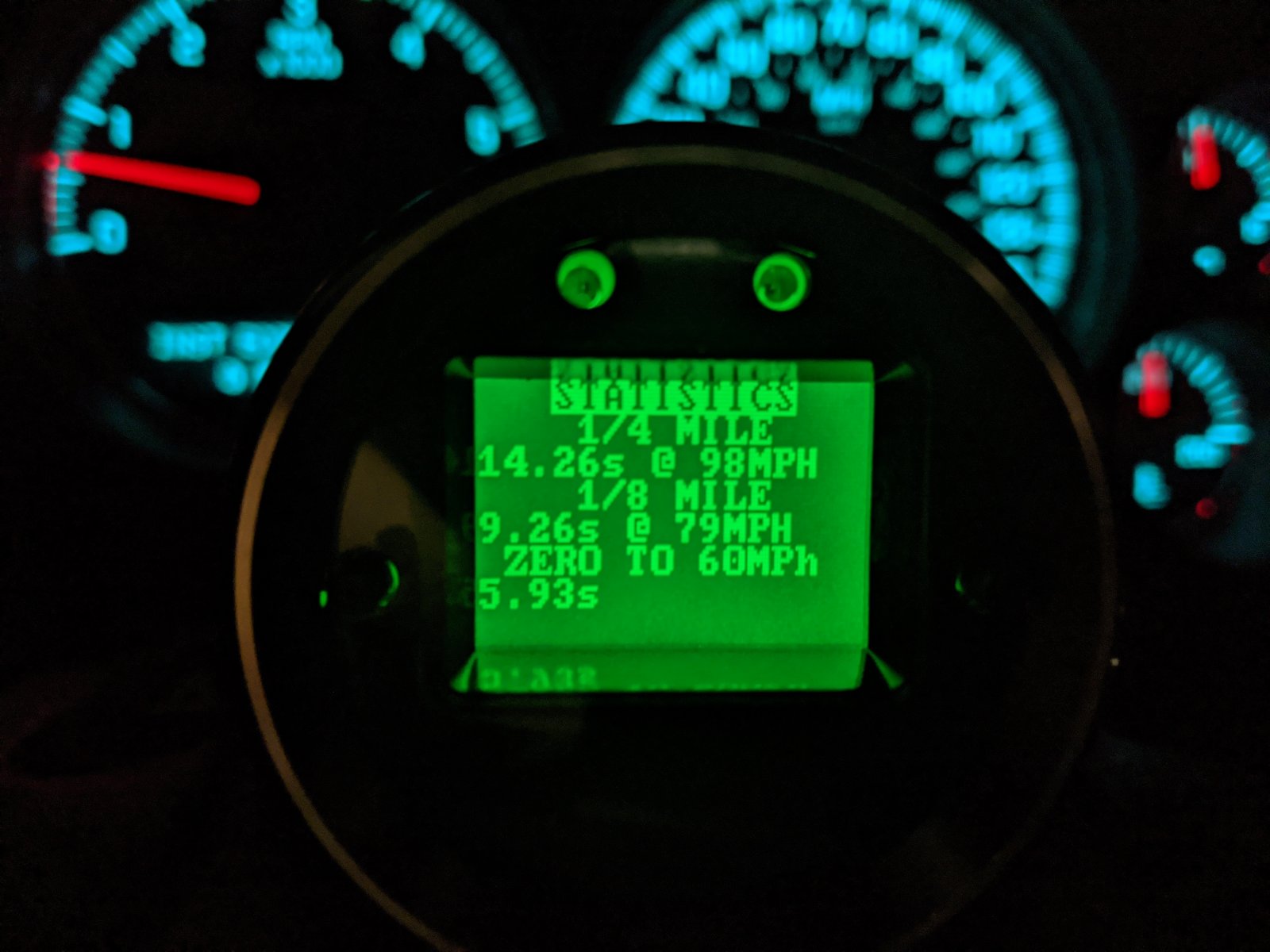

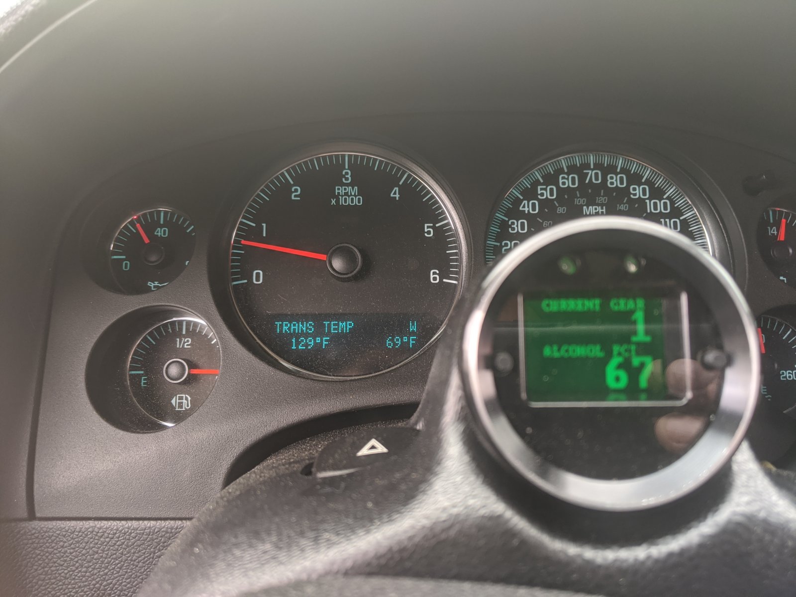

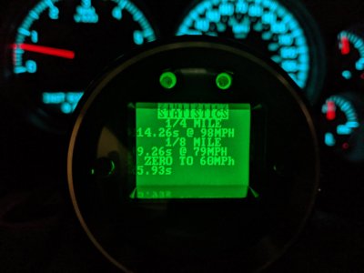

So here are my times from a run the other night........remember, full exhaust, ported TB, ported intake manifold (lightly) and 3.73s

what kinda HP your pushing to get those times? 0-60?
the hybrid stock is 0-50 in 5 seconds flat
0-60 is about 6.5 sec the engine at that point is playing catch up with the 80HP electrical motor
there is soo much torque you can almost get the front wheels off the ground if you launch it just right..
Not sure what hybrid you're speaking of, the the Tahoe Hybrid was rated 0-60 in 8.5 sec / the 2010 Tahoe PPV was 0-06 in 8.1 on flex fuel.
I'm putting down about 360 wheel on E85 (see mod list) and about 345 on 93 octane
The retrofit source does have nice stuff. Like you I had the same problem when I put HID’s in my ‘17 Buick Regal. My understanding is that they wire their shit to work for the “non American vehicles” as they sell at ton more to them.
That said if you buy one of their specific kits all of it works on the 1st shot... huh wtf...
I’ve called them and they have a run around with you a few times then send You what you need but it takes a bit of arguing.
