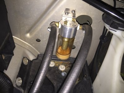

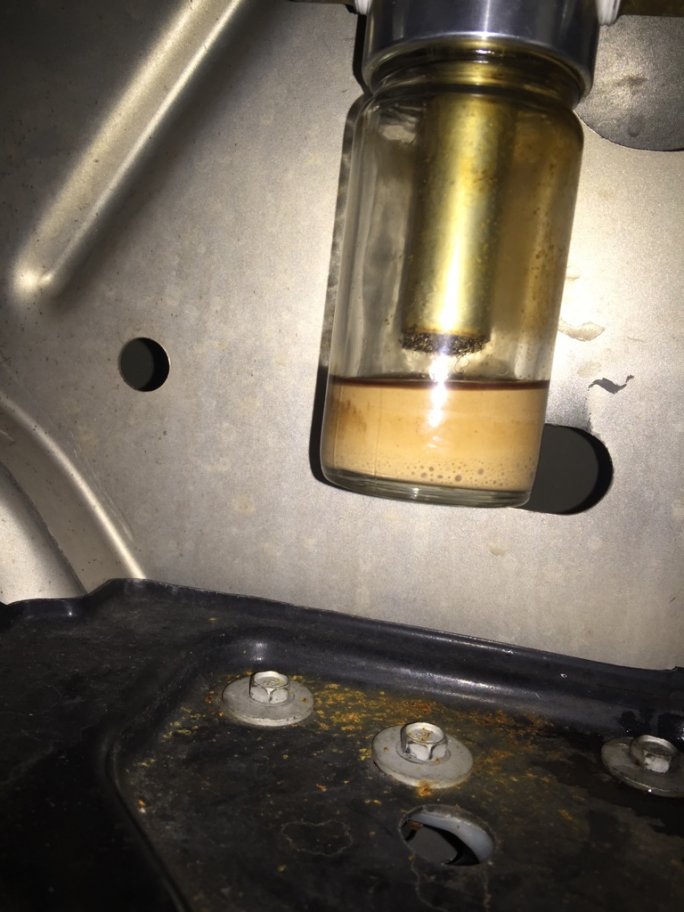

Nasty stuff

Since winter is hear for most of us this got me thinking. Will these catch cans freeze? When I drain mine the bottom is all water. Anyone experienced this or have any thoughts or comments?
joshcarl
Sep 8, 2014
115
Woodbine, Ga
doubtful. the fluid will be an oil/water mix, so just like antifreeze it will effect the freezing point of the mixture.
RotaryMachineRx
Sep 2, 2014
106
Saskatoon, SK
Well the oil and water do not mix and if sitting long enough the water will separate from the oil and yes is can freeze, I believe the system is open enough and that the can is rigid enough to with stand the water from expanding outwards and deforming the can. Long story short, once ur engine heats up the ice should thaw and ur catch can will be fine. Of course the more full it is the more likely there would be cause for damage so make sure you don't let it get overfull in the winter months. Also the colder it gets the more condensation you are going to find in your catch can so definitely worth keeping an eye on but if you are emptying the catch can every oil change I am most certain you will be perfectly fine.

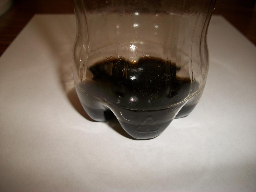

well my escalade hit 17996 miles time to change the oil today.
2993 miles since last oil change this is what I got.

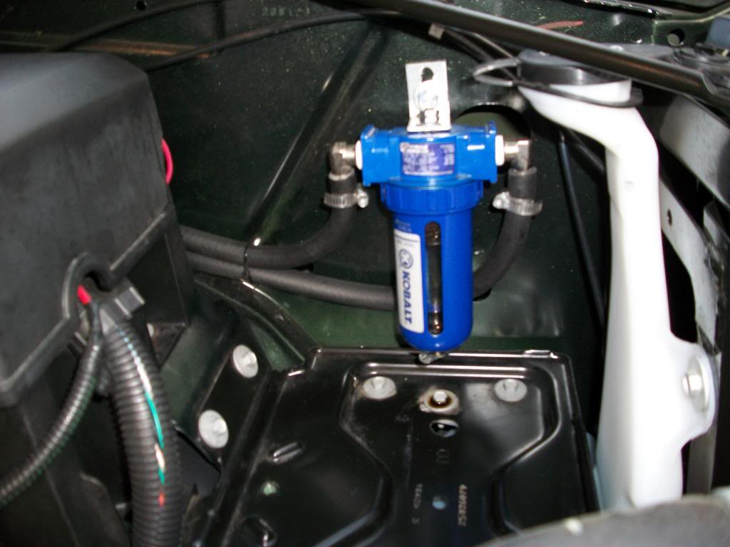

Took a pic last night of what has accumulated in my "catch can" since I put it on 36 hours before. More than I would've expected. Only drove it maybe 30-40 miles in that time.
