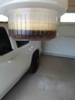

Finally, got around to replacing the PCV valve grommet. It was torn about 3/4 of the way around. So, I'm sure there was a pretty good vacuum leak. I'm hoping this was the cause of the P0171 and P0174 DTC's I was getting when the weather would cool off. Cleared the codes, and will cross fingers they don't return. (I don't feel like shelling out for O2 sensors.
I couldn't resist the temptation to check the contents of my Catch Can.
http://www.tahoeyukonforum.com/forum/attachment.php?attachmentid=30557&stc=1&d=1419104539
OMG, if this what the catch can prevents from being directed into the intake manifold, and subsequently the cylinders, I'm so glad I made and installed mine. This stuff looks a lot like baby $h!t, and about the same consistency. (Dads, you know what I'm talking about.)

That's just condensation in your oil from taking a lot of small trips around town and stuff
