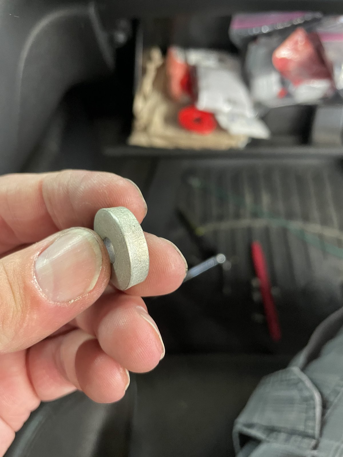

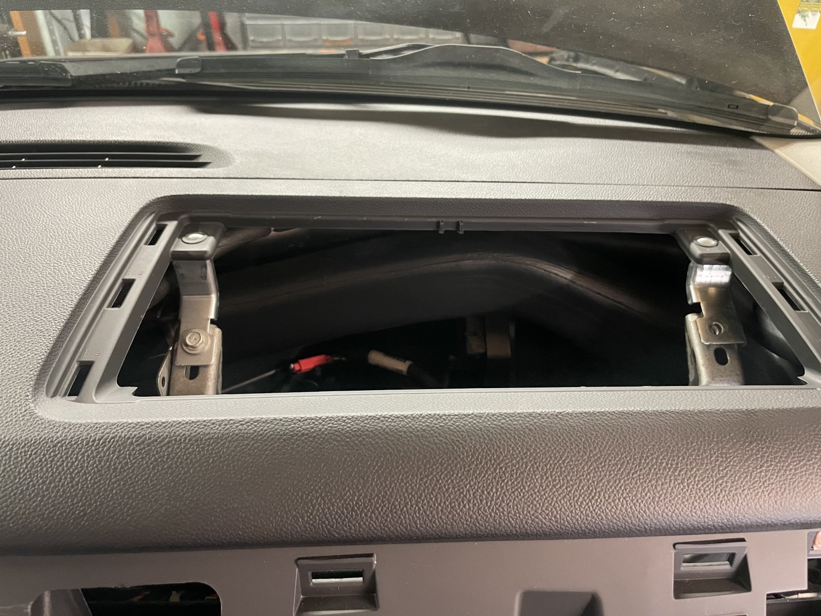

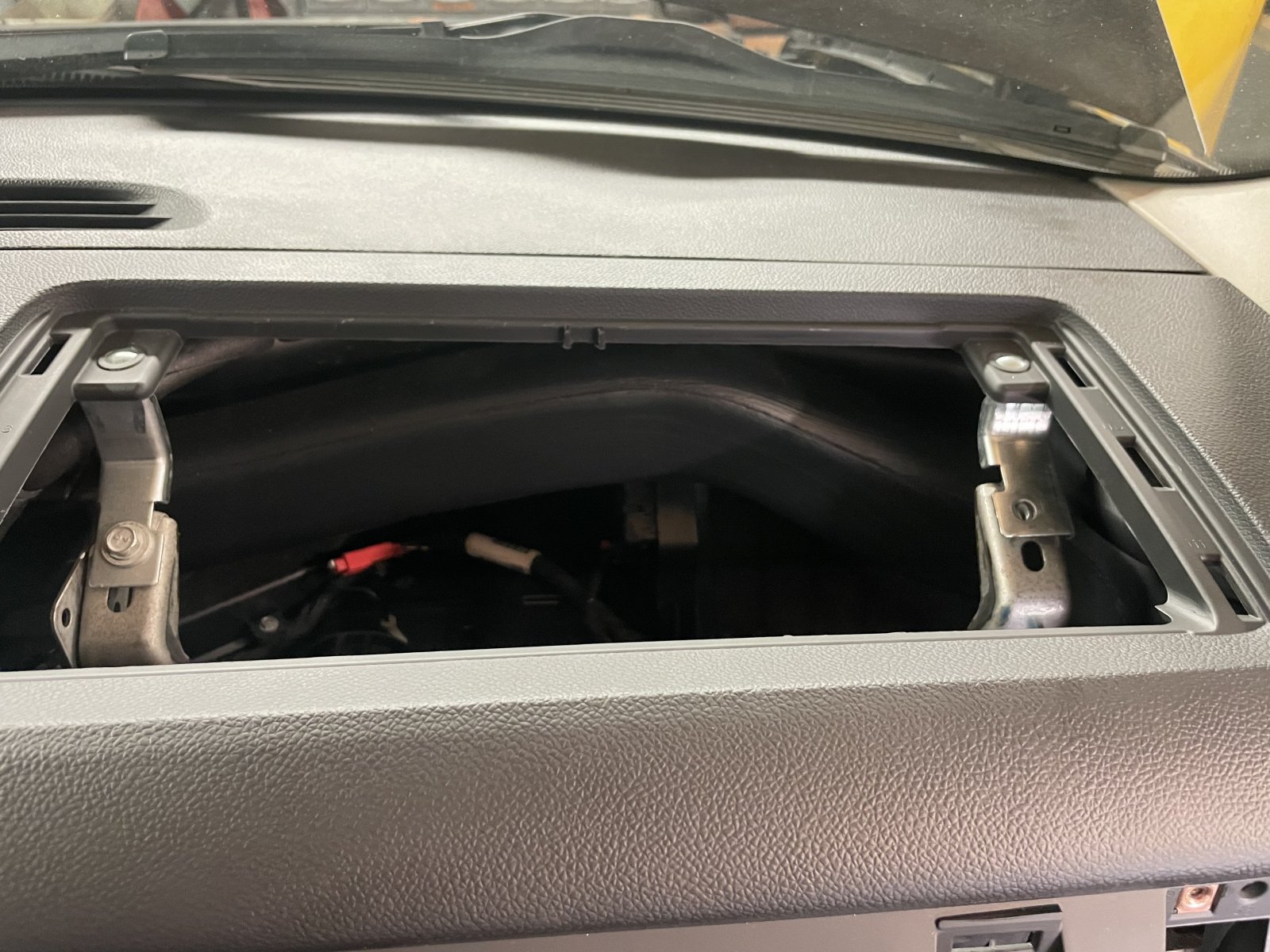

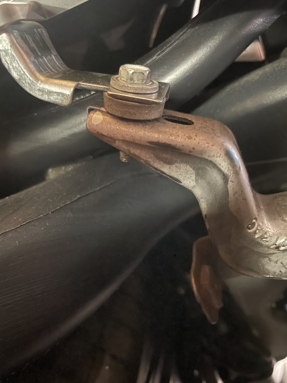

I revisited my dash install today. I recalled a comment about the brackets under the airbag and then remembered that one didn’t seem quite right. I pulled the airbag again and took out the two 10mm mounting bolts to find the right side bracket lifted up a lot. Thats what I recalled and I believe it creates stress on the other side of the left bracket where the first crack always starts. As I pushed down on that bracket I believe I could see the flex in the dash where the other crack was in the old dash. I found a spacer that fit perfectly and reassembled everything. The slots in the airbag mount still allowed for assembly too. Gad I came back to that!

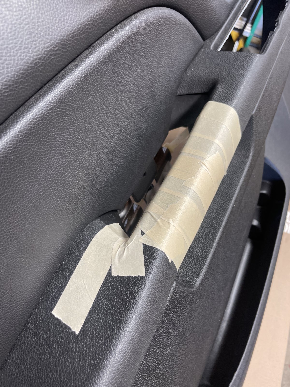

My drivers door handle busted more so I took the time to gut the busted plastic out if it and I threaded a large zip tie through the handle and around the metal pull bracket. Then I taped the handle rubber down like it needed to be and filled the handle and area immediately below the armrest with black expanding foam. Once that stuff all cures I should have a more resilient door handle. And the zip tie will be taking the pull of closing the door

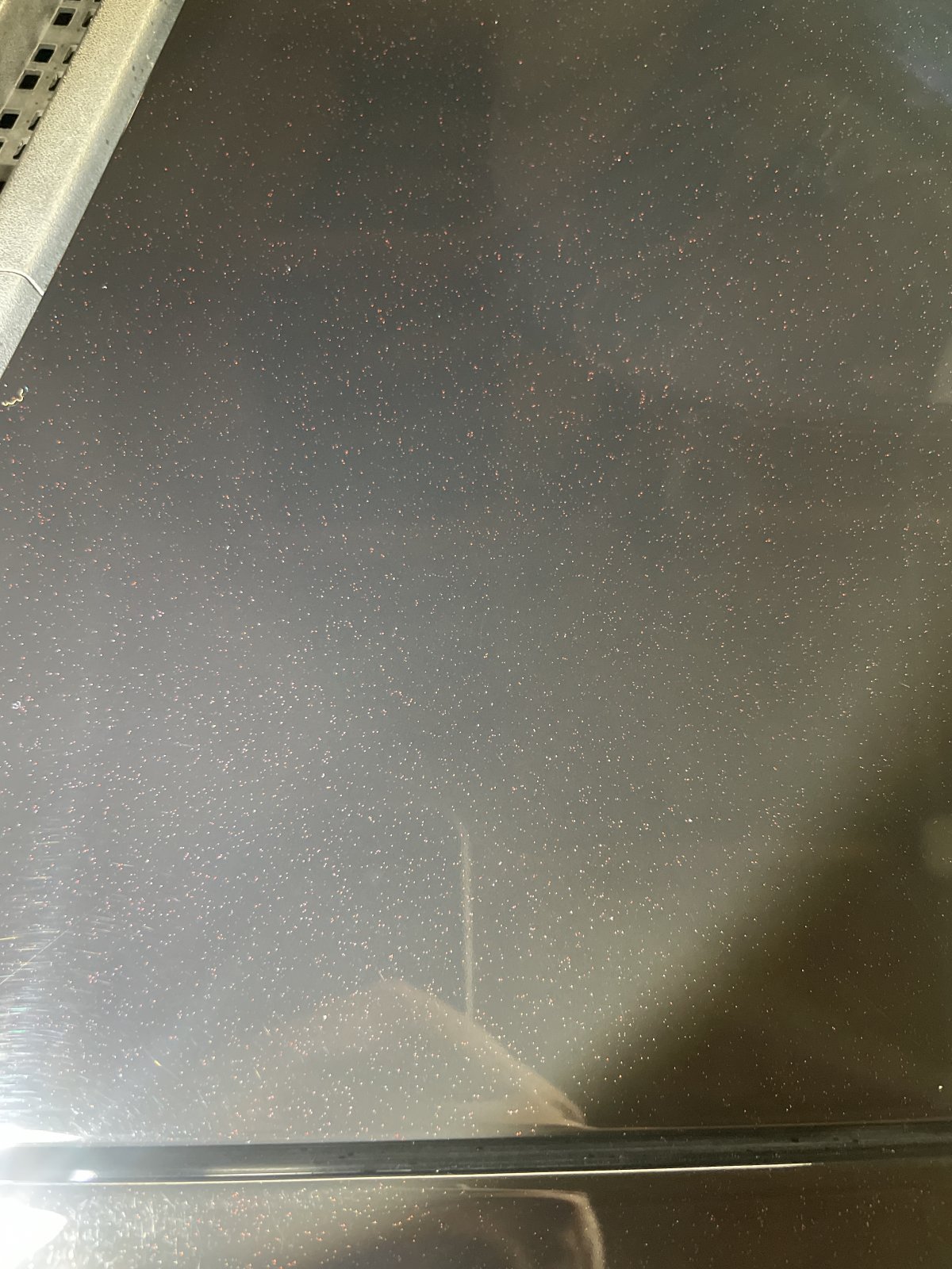

This dumb dumb painted a fishing bobber in the shop and got his truck covered in red overspray. Now the question is do I get the equipment to buff it off or do I farm it out to a body shop? Maybe all I need is a clay bar?
