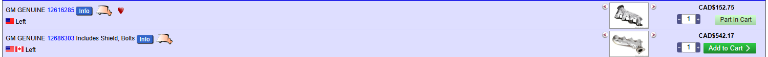

I plan to replace my driver's side exhaust manifold. The bolt closest to the firewall is missing. Cylindre number 7.
I plan to replace it with a new GM Genuine manifold. New steel bolts (not stainless). And new gaskets (GM Genuine).
What is the difference between these two manifolds?
Is the higher priced part (with a larger part number) an updated/improved part?
I see that the cheaper part is made in China. I have no problem paying more for the better part (possibly made in the USA) but I can't find any information as to what the difference could be between both parts.

Also. I posted on another forum. I got my answer.
"12686303 won't fit. Its for box delete pickup trucks ONLY. Option code ZW9. ZW9 trucks have a different exhaust Y pipe setup and the driver's manifold is designed to use a different seal for that Y pipe.
You want 12616285."
