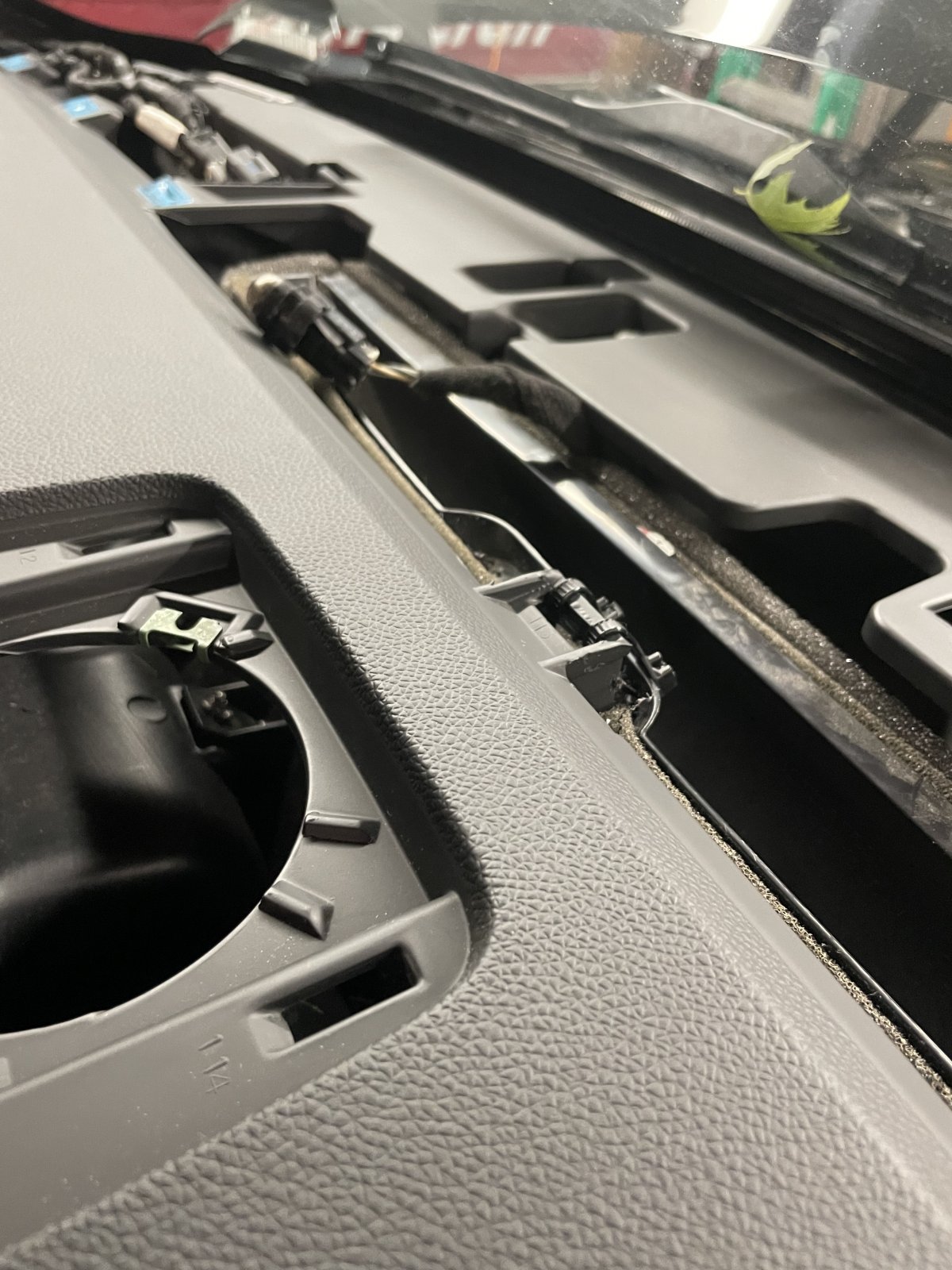

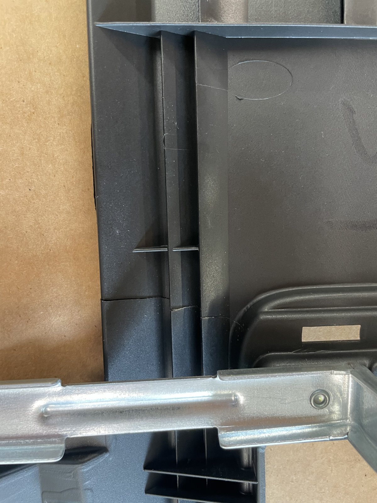

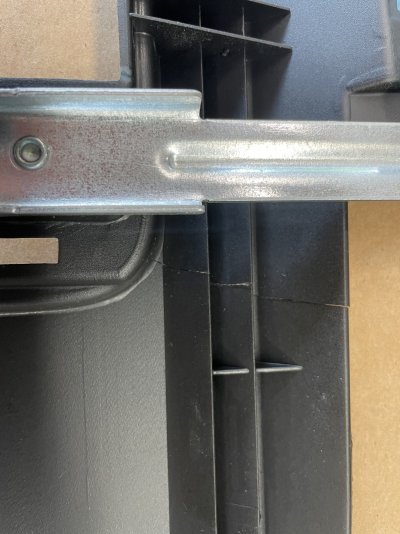

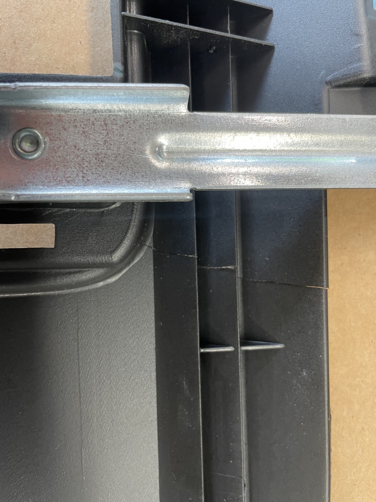

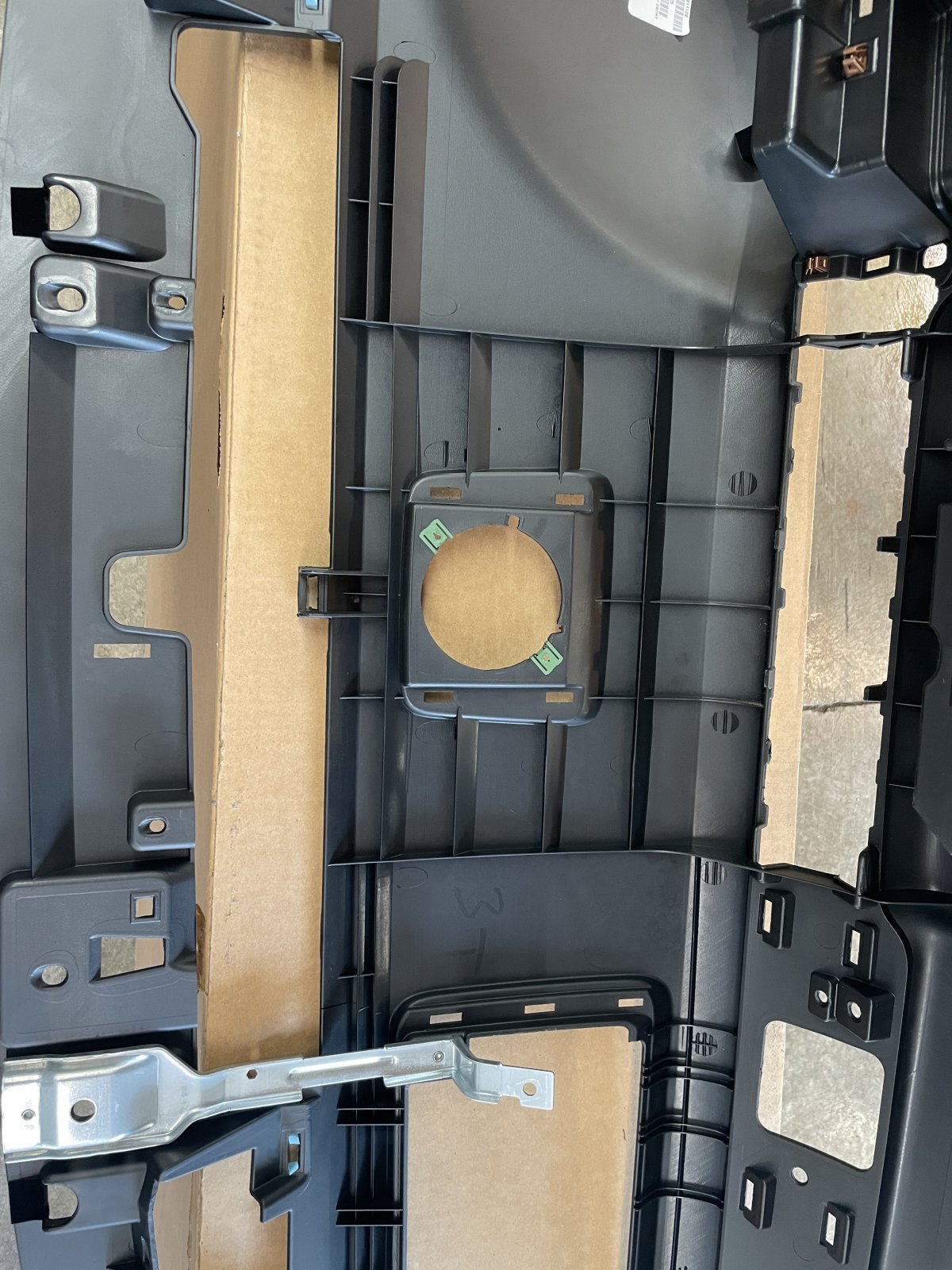

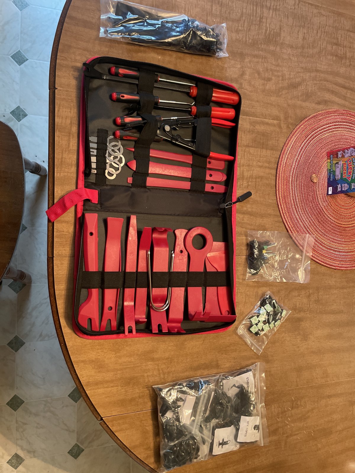

I swear not. I stood them side by side and they looked the same but with different part numbers.That’s a helluva trim tool kit. Are you sure that new dash doesn’t have extra ribs in the areas by the airbag and the instrument cluster? I’m not sure about the ones with the center speaker but the ones without that option are definitely reinforced in those 2 areas underneath.
No, it fit right between them.Did those zip ties interfere with the clip on the defroster panel that clips in there?

His is the older model without the speaker so don't look too far into it. I'm sure they added those ribs when they added the speaker and thought they should probably add those to the older style for the revised partI have been sweating this since Rocket Manasked if mine appeared to have more structure. I went back out and took out the center speaker. I reached in and felt the ribs on the back and counted the same two ribs confirming no design change. According to the quote below James found some info.

Makes sense. I was happy to find the info James shared about the material change.His is the older model without the speaker so don't look too far into it. I'm sure they added those ribs when they added the speaker and thought they should probably add those to the older style for the revised part

It's not older, it's just optioned differently. Someone said to not tighten a bracket bolt under the airbag all the way to keep that corner crack at the airbag from starting. Was it Wes or Chris? Then of course, keep the heat off it, use a dash cover of some kind. This has worked for me down here in Florida where she sits outside in the sun all day for 5 years so far and has not cracked yet and the truck is 13 years old now. Julia delayed getting the cover for the Sierra and her dash cracked at the airbag.His is the older model without the speaker so don't look too far into it. I'm sure they added those ribs when they added the speaker and thought they should probably add those to the older style for the revised part
