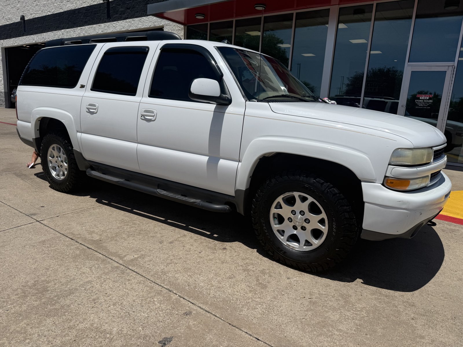

We ended up making the deal. Took it straight to the tire shop to put on some 285/70 ko3s on it & headed back to the rust belt. The seller was a great guy & took excellent care of it. I have a few things that I plan to take care of before our first trip. I’m sure I’ll have more questions for you all but here are the first 2.
1 - Does anyone have ko3s on their burb, if so what tire pressure are you running? I’ll chalk test it to get it right but it would be nice to have a starting point.
2 - I originally planned on doing about a 2” lift but I really don’t think that’s necessary. The rear wheel well it 38” high front is around 36”. I just want to level it. Do you all recommend torsion keys with shock spacers or keys with actual lift shocks to accomplish this?
We bought it in Fort Worth so my kids named it Tex

Looks great! And just recently broken in. 5.3L or 6.0L? Looks like the headlights need to be polished or updated. The cooling fan may be a clutch fan, so you may want to consider converting to electric fans if it is. Also verify that both top and bottom fan shroud halves are in place.

Thanks - 5.3
Ordered cerakote headlight & black plastic restoration products while my wife did her share of the drive. My grandfather worked at guide lamp for over 50 years hoping I can save the headlights - won’t be happy with aftermarket! I’ll check the fan.

Looks like it's in nice shape. Gratz!
If im trying to just make it a little more level a couple turns on the adjuster key does not hurt anything and i would get it aligned.
Would stock length shocks work after I do this?

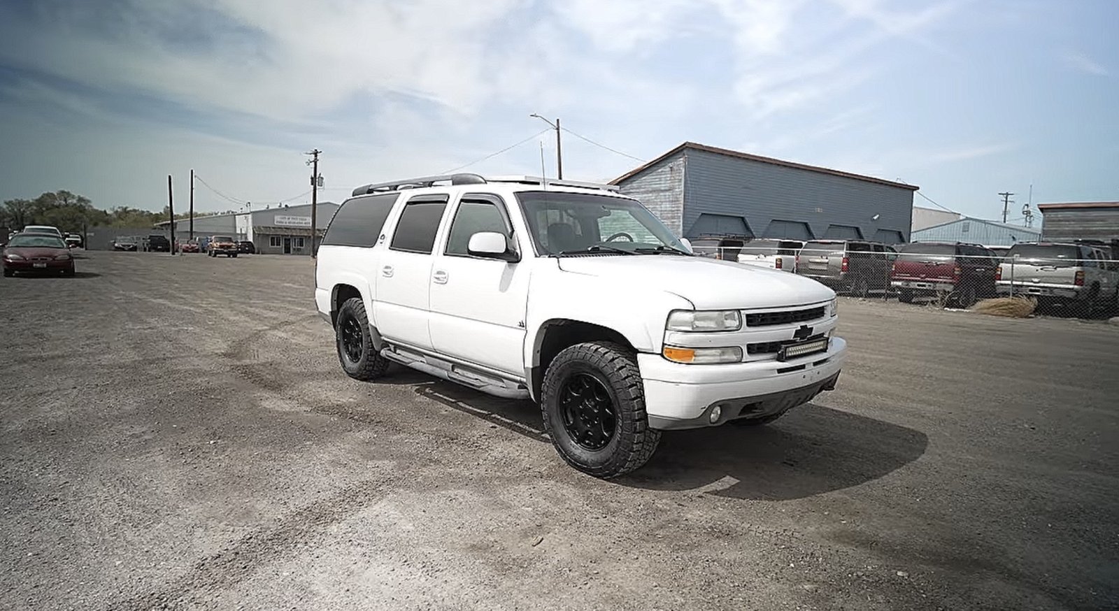

This stance is the goal. Wheels are the same just black and same size tires.

Nice looking ‘03.
On my 2002 Z71 Tahoe I did new keys and front shocks to level the front rather than shock spacers as I felt it provided the stronger option for off road use.
