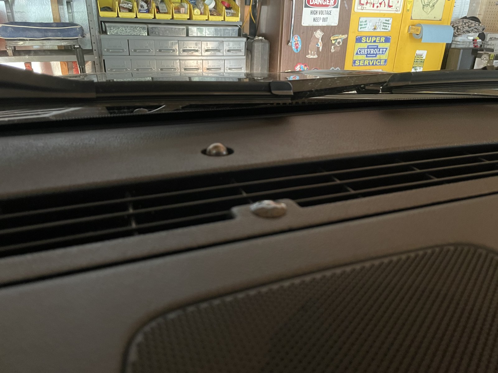

It's not older, it's just optioned differently. Someone said to not tighten a bracket bolt under the airbag all the way to keep that corner crack at the airbag from starting. Was it Wes or Chris? Then of course, keep the heat off it, use a dash cover of some kind. This has worked for me down here in Florida where she sits outside in the sun all day for 5 years so far and has not cracked yet and the truck is 13 years old now. Julia delayed getting the cover for the Sierra and her dash cracked at the airbag.

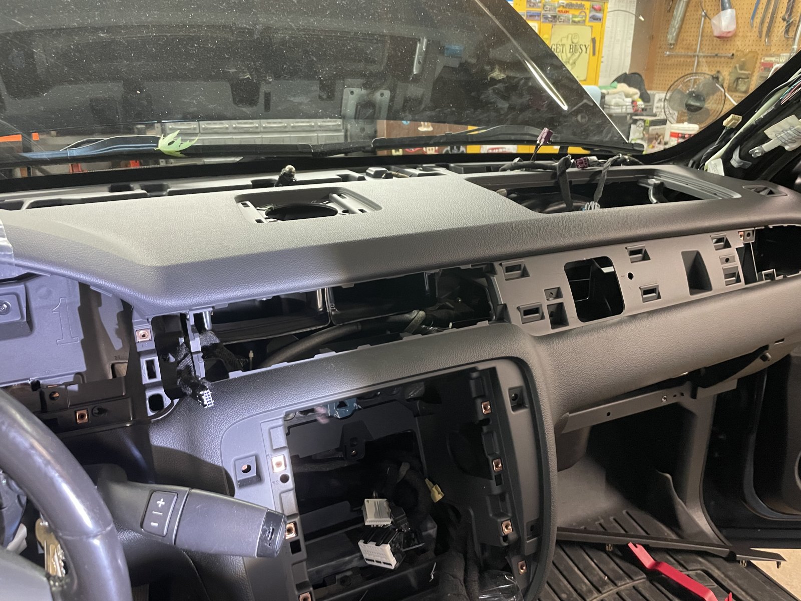

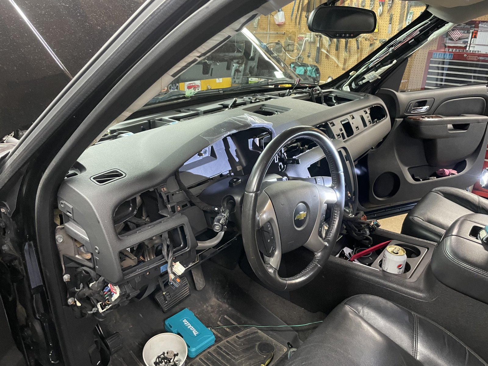

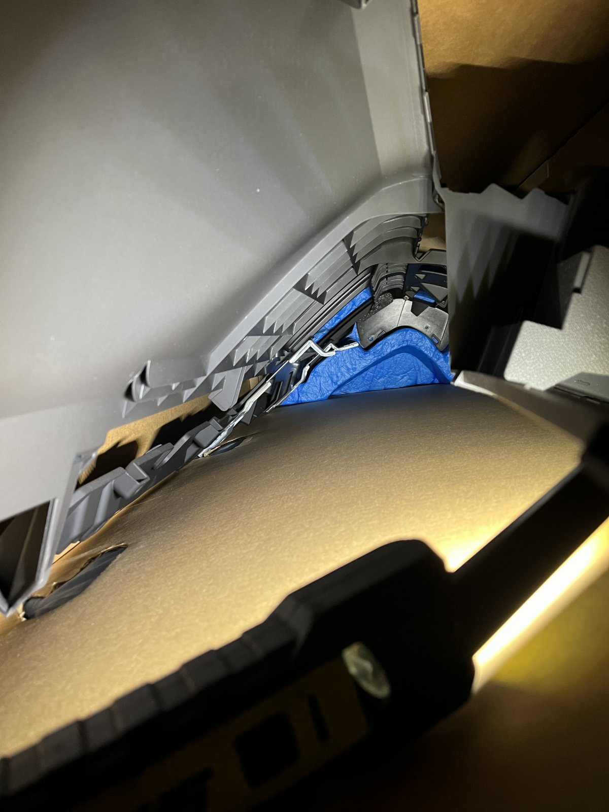

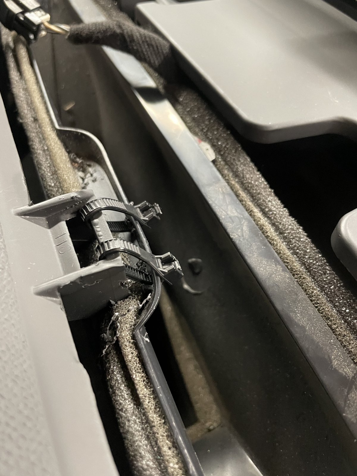

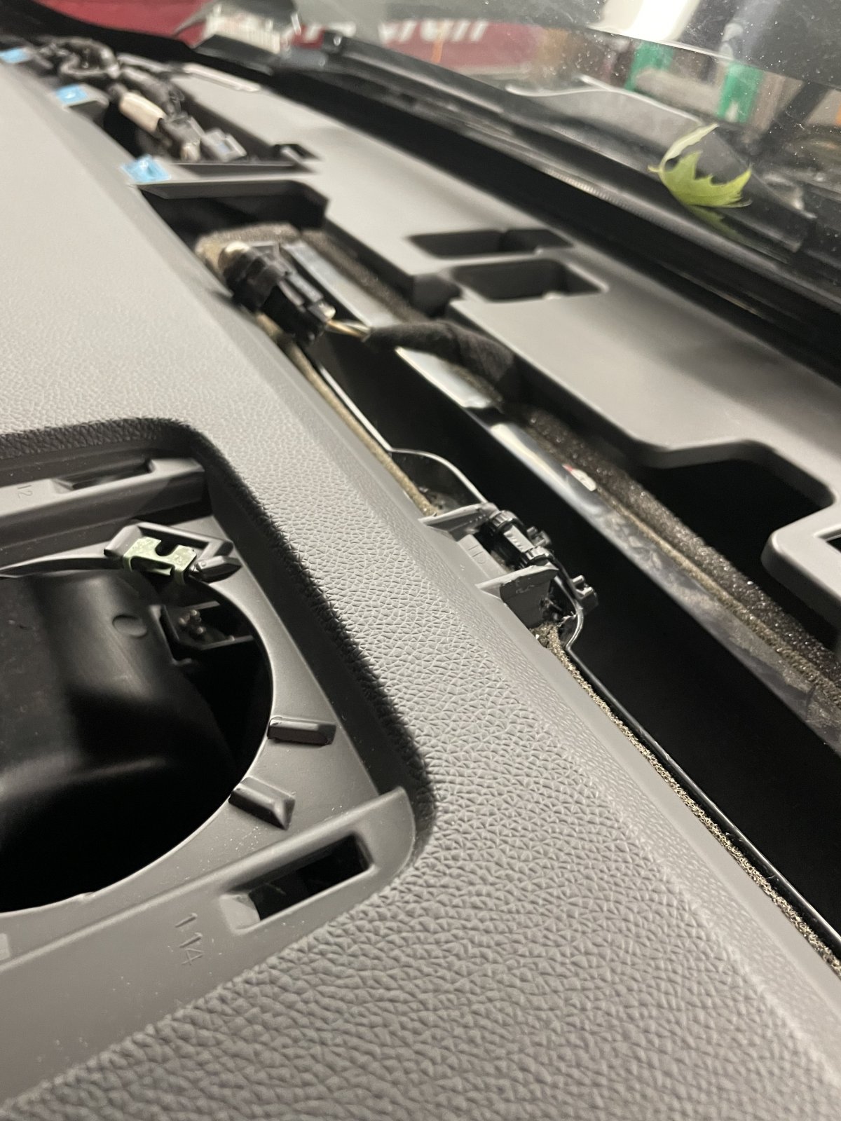

Swapped out my dash today. I was surprised to see the same support ribbing on both parts. I took a minute to confirm part nimbers and found that I did in fact have the old part number 20989625 coming off the truck and a new part number 23224742 going on. I about crapped because I almost thought I have a new design that had cracked. I decided to proceed with the install and it went pretty smooth. I tied the new dash into the vent with some zip ties as well.
The only issue I had was with the Dorman filler panel. It wanted to sit up on the left side just next to the defroster vent. It seemed the duct portion of the panel was sitting high on the duct from the heater. The clip would just pop up and not stay attached. I ended up grinding away some of the duct on the filler panel so it would sit down and clip in. Seems to be ok now. The factory one still fit fine and was whole but one tab was broken off in the center I wish I could have still used it.View attachment 372675View attachment 372676View attachment 372677View attachment 372678View attachment 372679

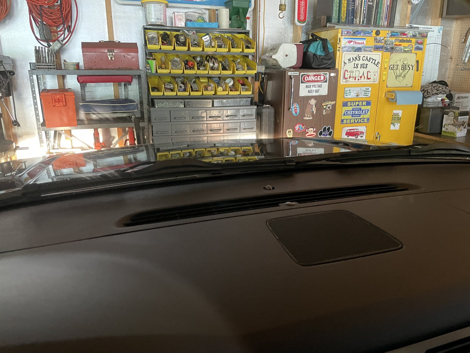

Confusing is right! I ordered from here based on info from 915tahoe.
I am confused too.
45,016
Avalanche is LTZ and I'm certain they added the speaker later. My dads 2012 has center speaker. My/yours 08 does not have it. That's why I said earlier years (earlier)
I thought it was a package deal (Bose "LUX" amp). Although, that might not have been available until the later years. Still, George and I ordered the same part number and he got the dash with the speaker hole for his and I got the dash without it for mine. I ordered mine from a local Chevrolet dealer.

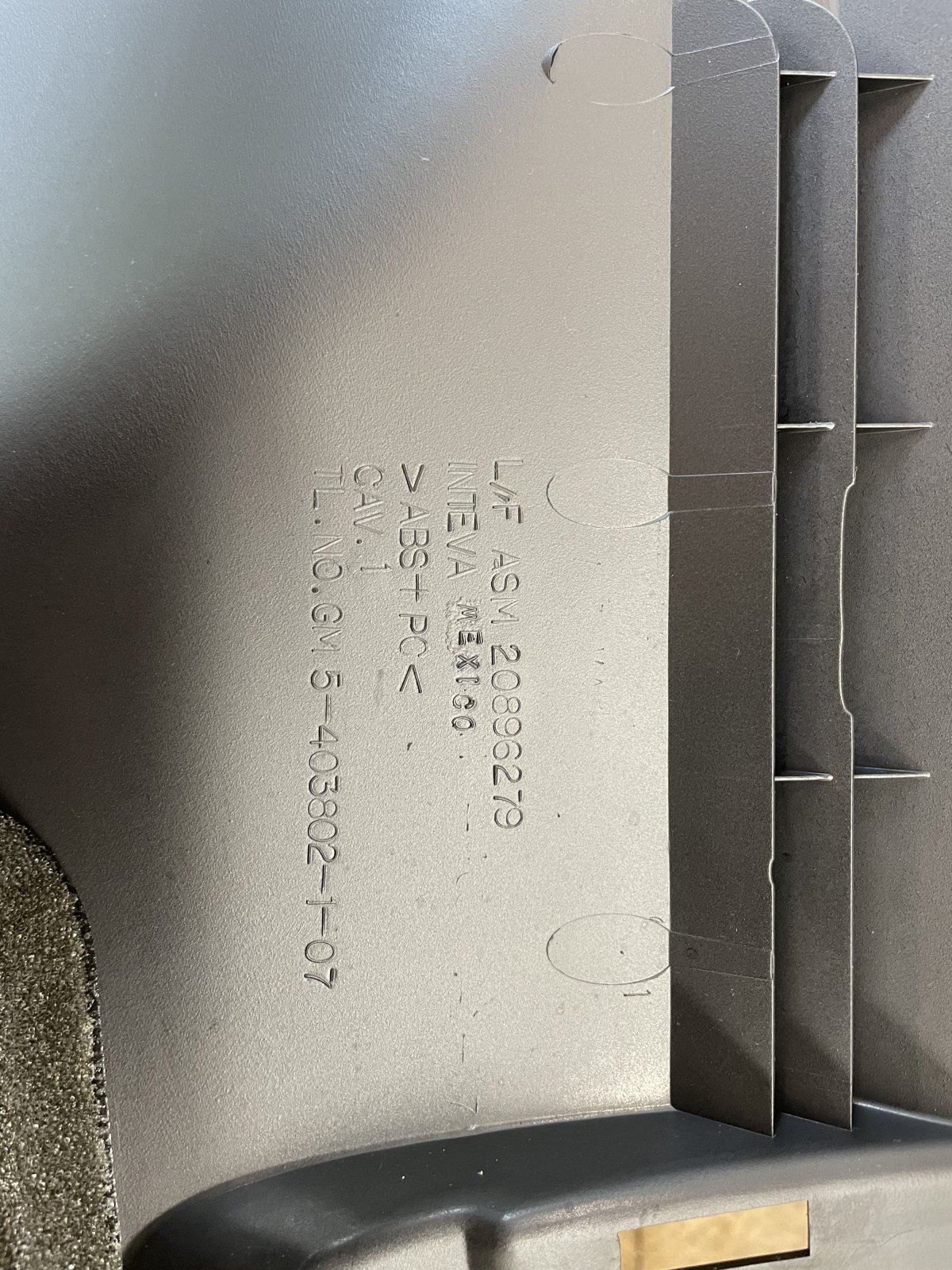

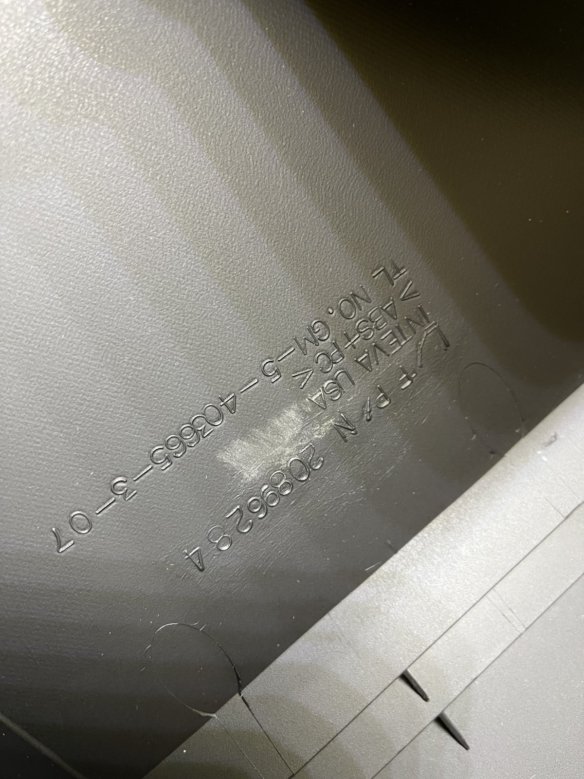

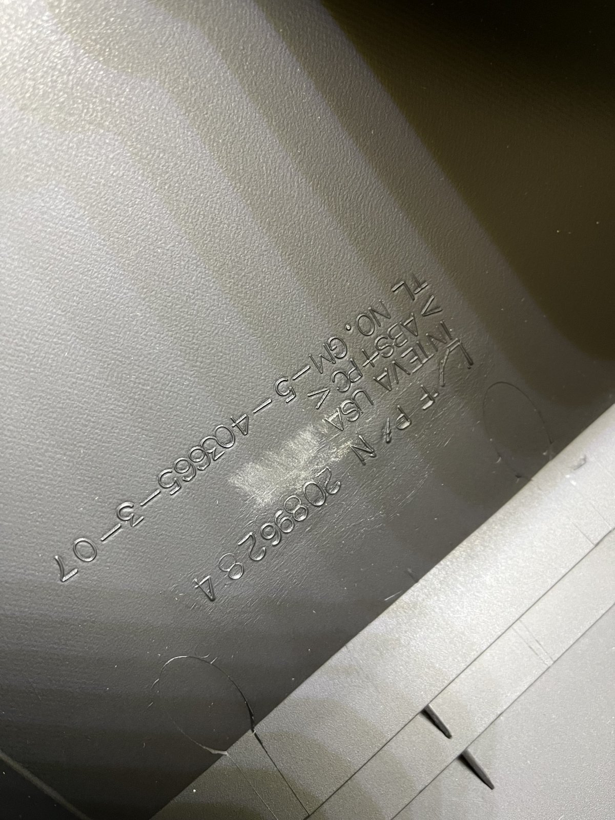

@iamdub what is the number molded into the plastic on the left side of yours?
Both mine had the same number but I assume thats a fitment number or mold number.

On another note:
Since the factory filler panel only had the one busted tab and I had nothing to lose so I drilled a clearance hole for a long tree retainer and installed it again. The retainer fits nicely in the slot for the clip and it looks ok. At least $70.00 ok so I am sending the Dorman one back for a refund.

So the tab on the underside that holds that metal clip on is broke?
Yes, it broke and I removed it a while ago. I had tossed it out and drilled a hole for a zip tie to secure it to the dash which was also broken. When I decided to go forward with replacing the dash I decided to just replace the filler panel too but I found a way to make it work with the little tree retainer. And save $70.00

Numbers as requested-
Disregard the steps in the lighting, it's from my LED worklight:
Facing center stack from LH side. I've never seen the underside of my original dash, but I believe this grid pattern is part of the updated design:

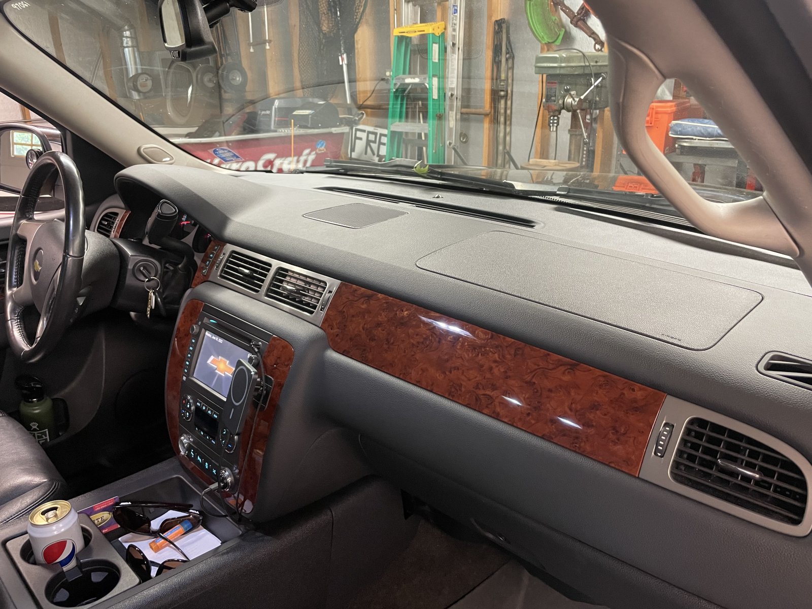

I may be worrying needlessly but, other than the part number difference the new and old dashes from my truck seem identical in every way.
Oh well; it’s installed now…
