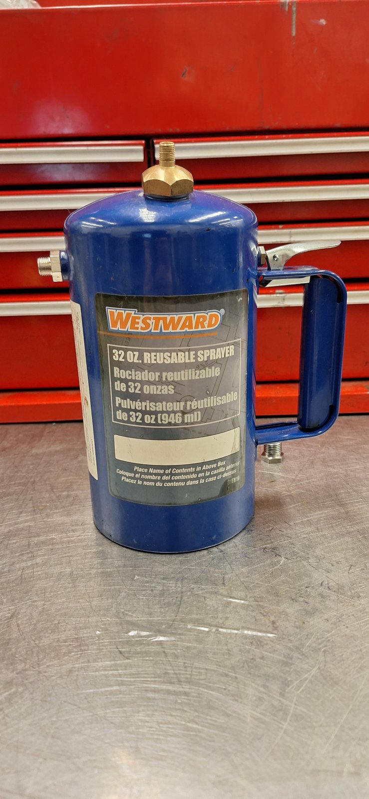

Get a nonaerosol sprayer. The output is 1/8 inch pipe thread, so you need a coupling and corresponding threaded barb fitting. A length of hose and the correct fitting to hook to the fuel supply fitting of the fuel rail. At the chevy dealer we used soft jaw vice grips to pinch the return hose shut to prevent return flow. Set your compressor to 50ish psi and charge the can. And just hold the chuck on the can to maintain "fuel pressure" till the can is empty.
Yea, in the shops I was in, every tech had one of these. Shop supplied.
I like this! Great idea... Thanks! I will pick one up next time I am at the harbor freight.
