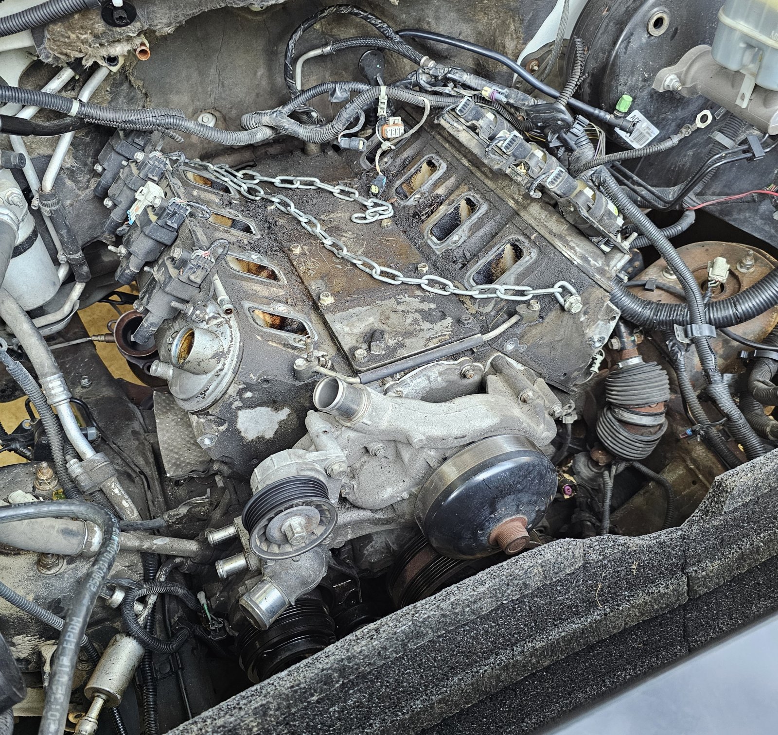

Started the engine swap on Cracker today finally. Pics don't show all the progress i made today. The intake is off it now. Intake gaskets look like they were sealing good. All wiring is out of the way and fans are removed. Nothing special.

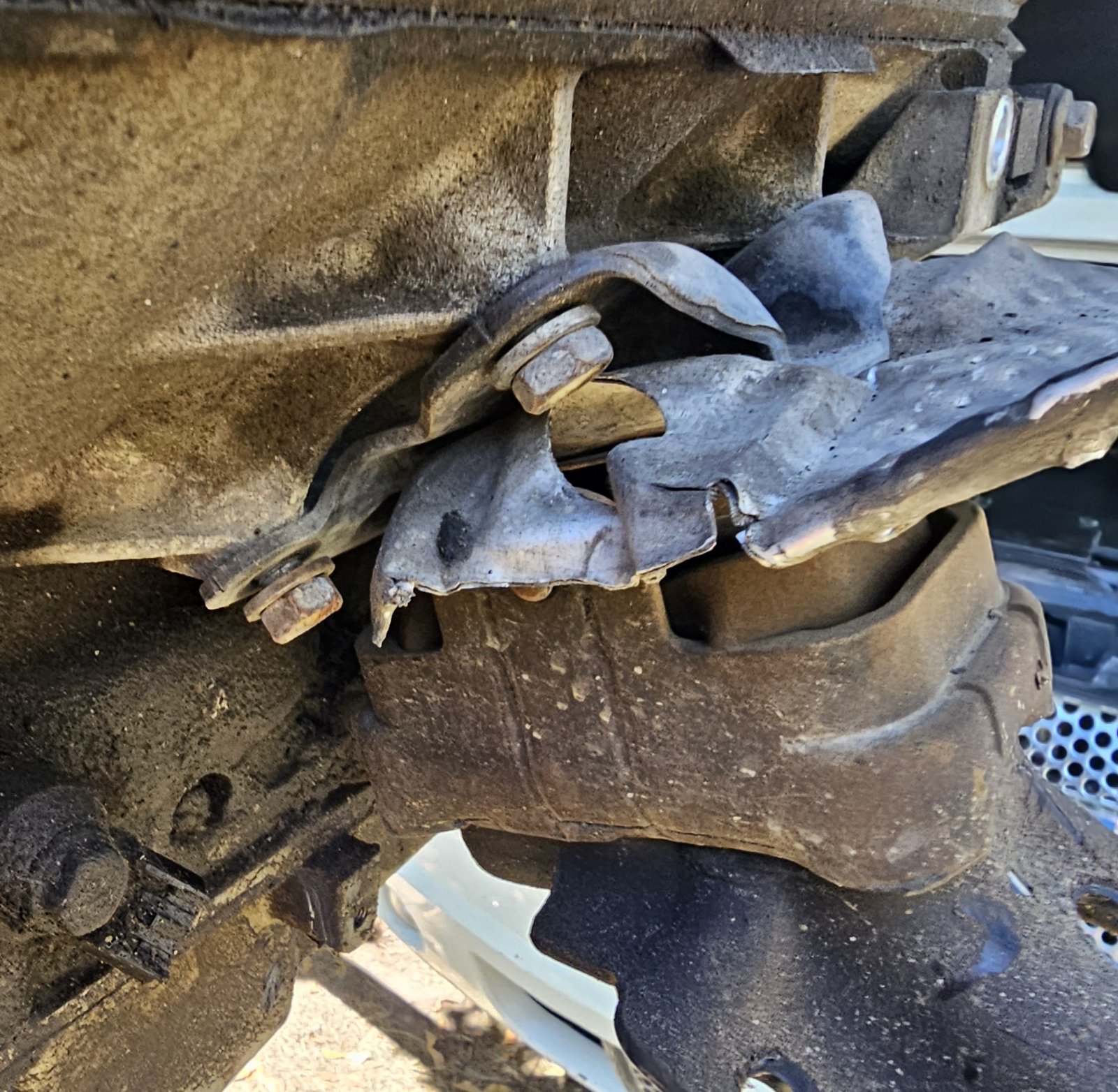

Underneath is a different story.

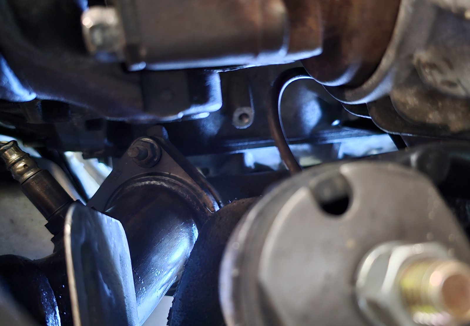

Exhaust flange nuts are the tightest i have ever seen. Had to use a 3ft breaker bar to bust em loose. One of them on the driver side got about 1/2 way off then stripped. Now the exhaust manifold is stuck to the pipe and ain't going anyplace! Ill need to cut it off after i get the engine out

The passenger side was also tighter than fk. What Gm engineer thought it was a good idea to put the o2 sensor right below the stud so you can't get a socket on it.
Had to take the inner finder off and get it off with a wrench.
Was also surprised once everything was broke loose it came apart easy. The rear exhaust manifold bolts came out and the far back one was only finger tight.

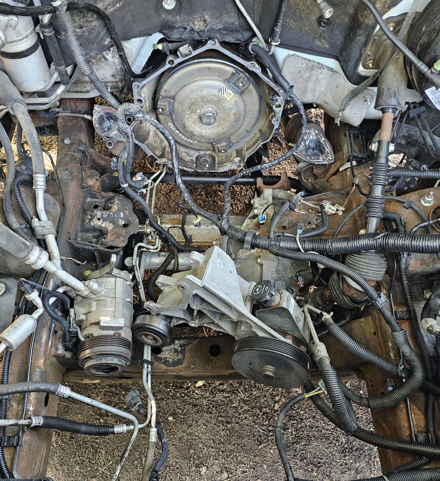

Got everything unhooked except the AC compressor. Will unbolt that after i lift it up a little. I don't wanna unhook the lines for no real reason.

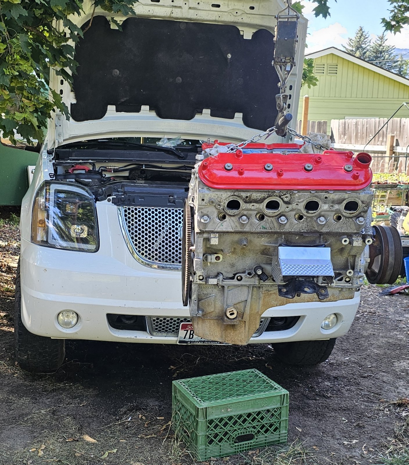

Waiting on the kid to come over and hold the engine crank so i can undo the torque convertor bolts, need to also have him help me set up the overhead. It will be out in a few more hours.

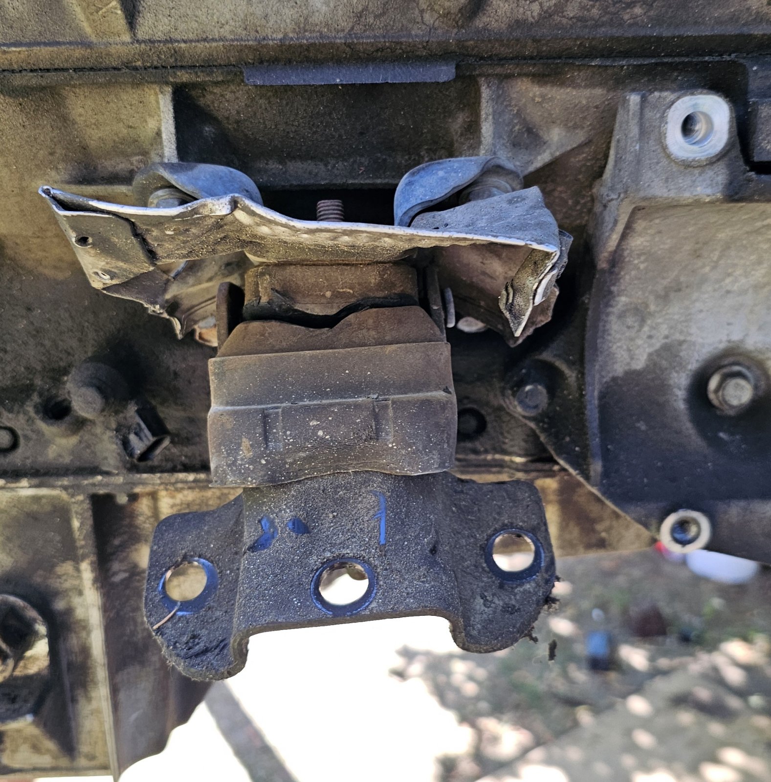

Pretty sure this is not factory.

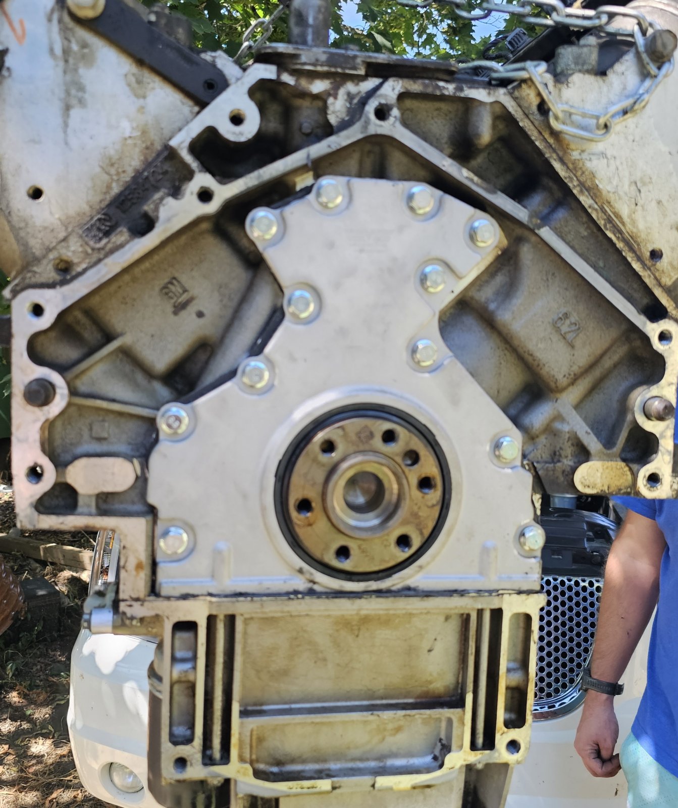

The engine has a bad cold knock but goes away when hot. When i first got the truck and changed the oil there was a bunch of cam bearing chunks in it and the oil filter.
I have been babying it along after changing the oil pump and O ring, but the damage had already been done.
It has maintained good oil pressure since i changed the pump but the 3rd oil change still had metal in it although a LOT less.
With the metal in the oil and the cold knock, it could last 100k of 5 minutes.
I don't wanna be doing this outside in the winter, so now's the time.

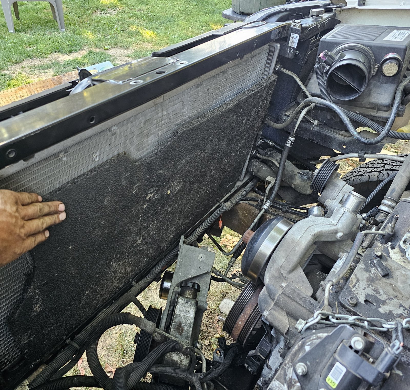

Pressure washed under the hood. Does not look like it but it is a big improvement!

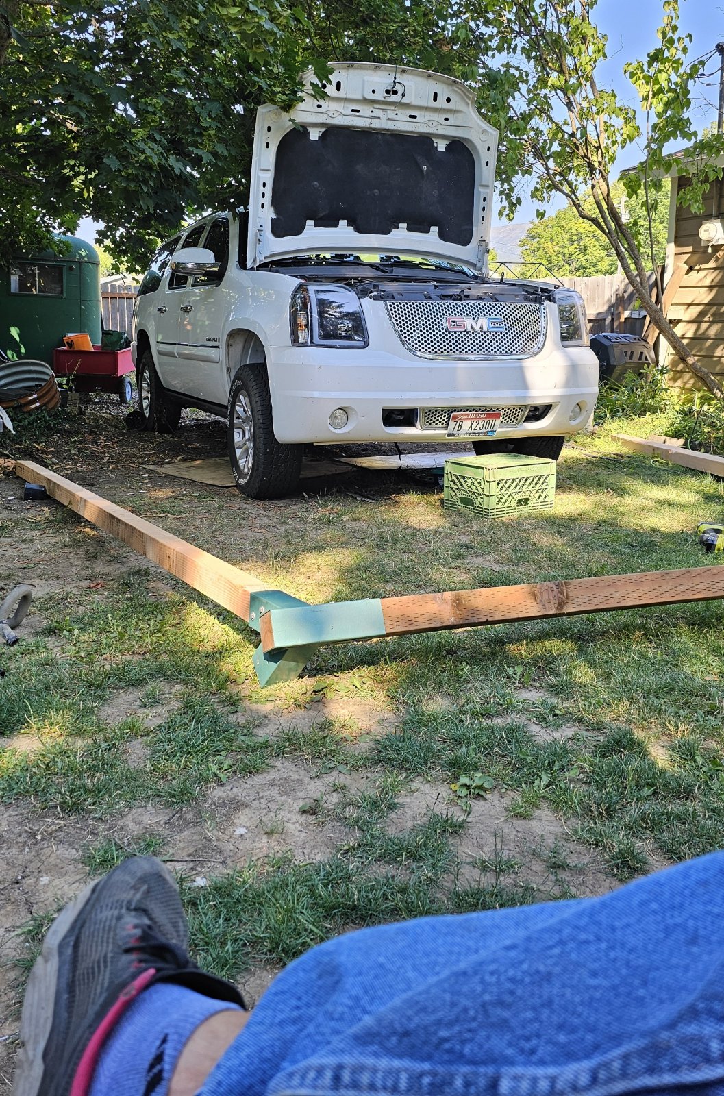

Great progress! Is that a wood frame you hoisted the engine from? Then pulled the truck into position with the ATV? That's pretty smart.
Back when I swapped the 5.3 into my 99 Silverado, I unloaded it by backup up my truck and lifting the engine with a come-along into a welded swingset frame I had made for my kids. I then drove off, used my engine hoist to lift it slightly more, removed the come-along, and finally lowered it into the engine stand. SMH
Good observation on the atv pulling the truck. I just see chains, a come along , wood post. I couldn’t figure out what to make of it
