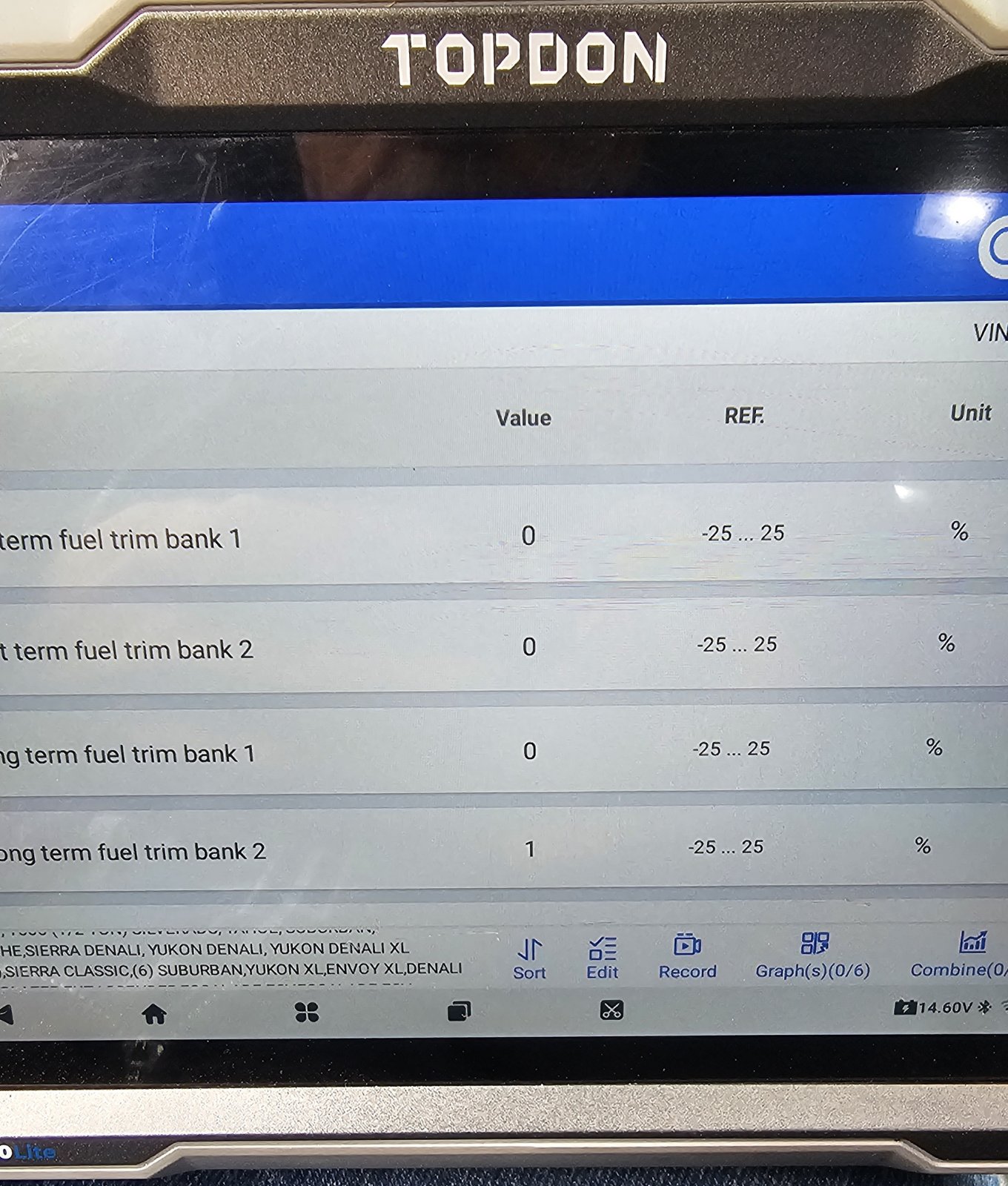

Think i figured out the rough idle when cold today. Was watching misfires at cold start up and #1 was almost a steady miss and #8 had a few. Has new plugs, so i swapped in different plug wires and everything smoothed out and no more misfires. Kinda odd though as it only missed when cold. Warmed up, it ran fine.
Changed the oil today at maybe 1k miles since i put the engine in as by now anything that is going to flush out should have by now.
There is a little flower sparkle in the bottom of the drain pan that I'm attributing it to 2 things. Did not clean it out from the old engine oil drain and the new cam bearings may be shedding a slight bit. Next oil change i assume will be clear.
Interesting though. I was using a WIX XP filter and the oil pressure was running about 25 psi (ish) hot idle. Put a PF-63 filter on and oil pressure jumped up 5 psi so now after a 10 mile drive and 1 WOT pull it is now 30 psi (ish) at hot idle. So another +.
Hot idle LTFT and STFT
