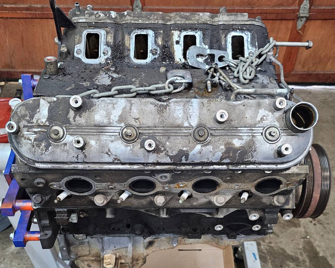

Here is my old engine. Removed at close to 240K Ran great but did have a piston slapping when cold.
Both valve covers are all gunked up.
The valley cover has probably never been off. The silicone gaskets were all hard and brittle.
All cylinders were burning good.

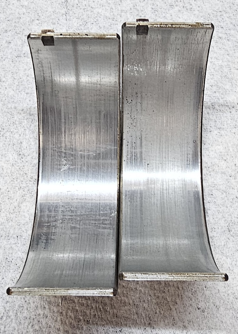

The rod bearings are not too bad, but it does look like the oil filter was bypassing for a while. This is #1 with all the rest looking better for sure.
Main bearings show the same pattern on the lower part and great on the upper half.

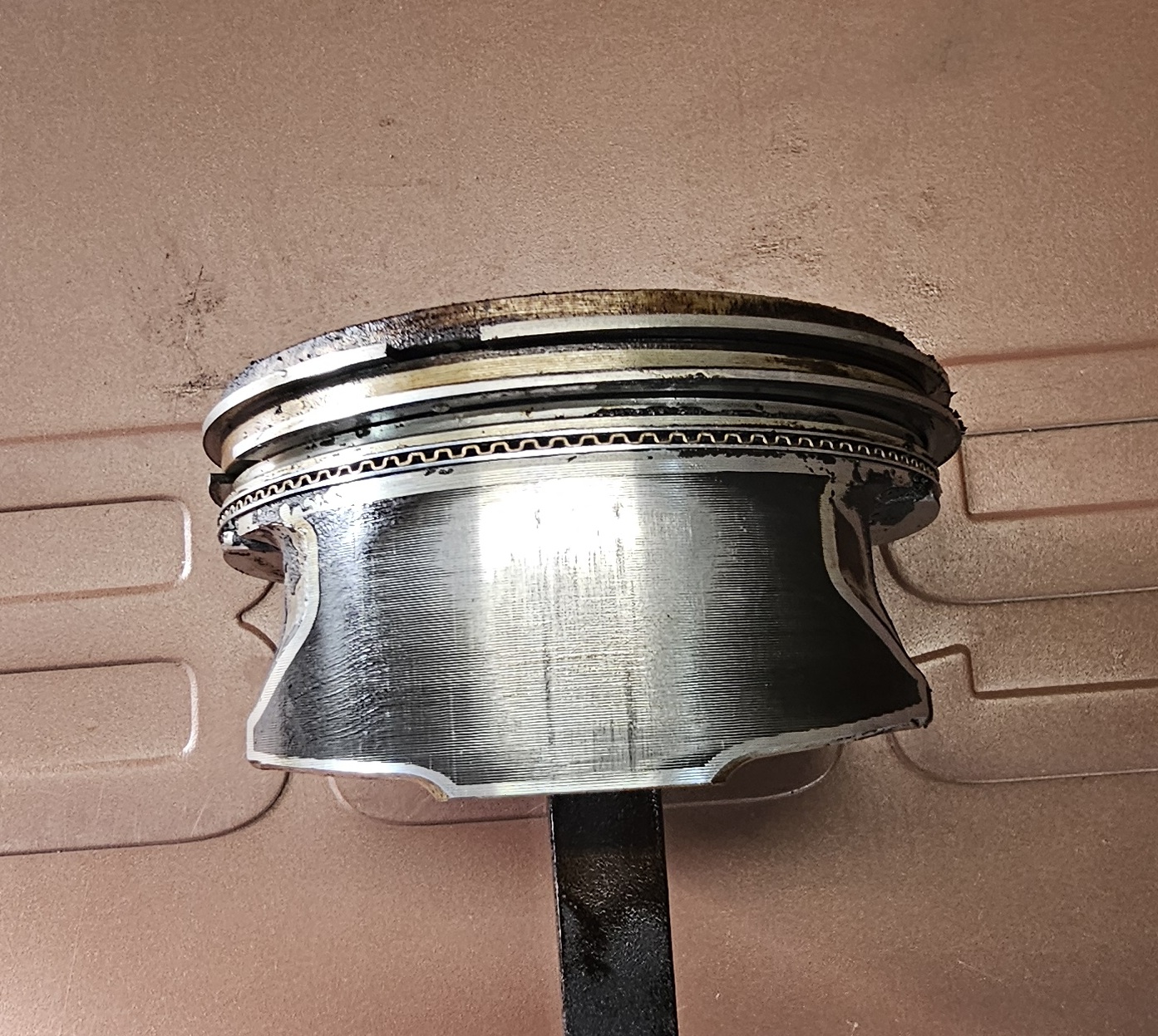

Pistons are exactly how i expected them to look. Coating worn off and scuffed. They all look very similar.

The block is actually not too bad. Pistons pushed right out with little effort and i can still see most of the factory crosshatch in all cylinders.
I remember needing to use a ridge reamer to remove pistons on 100k engines way back. Newer low tension rings FTW!
