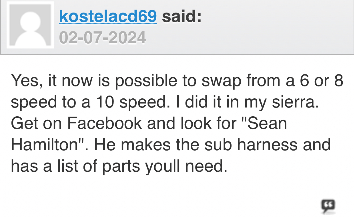

I’ll paste this here

Oh well, high hopes. At least I don’t feel bad about potentially missing the boat on a 10SP swap since I just replaced the 6SP.
As time goes by, the 6L80/90 is getting lots of aftermarket support to handle grip-loads of power. Precision Transmission is doing a 4-digit HP 6L90 build for a twin-turbo CTS-V right now. He did a video the other day of all the upgraded parts for the build.
