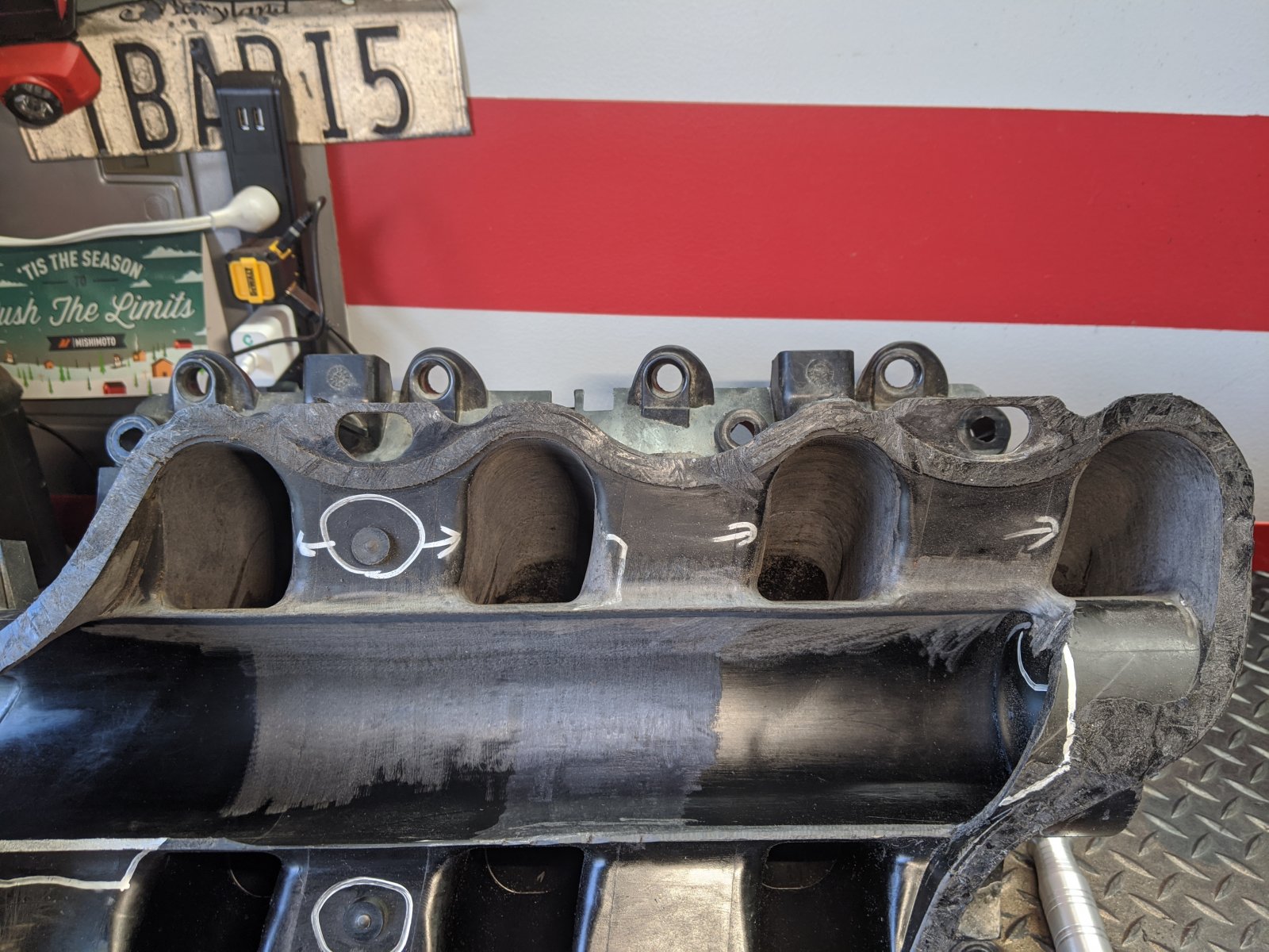

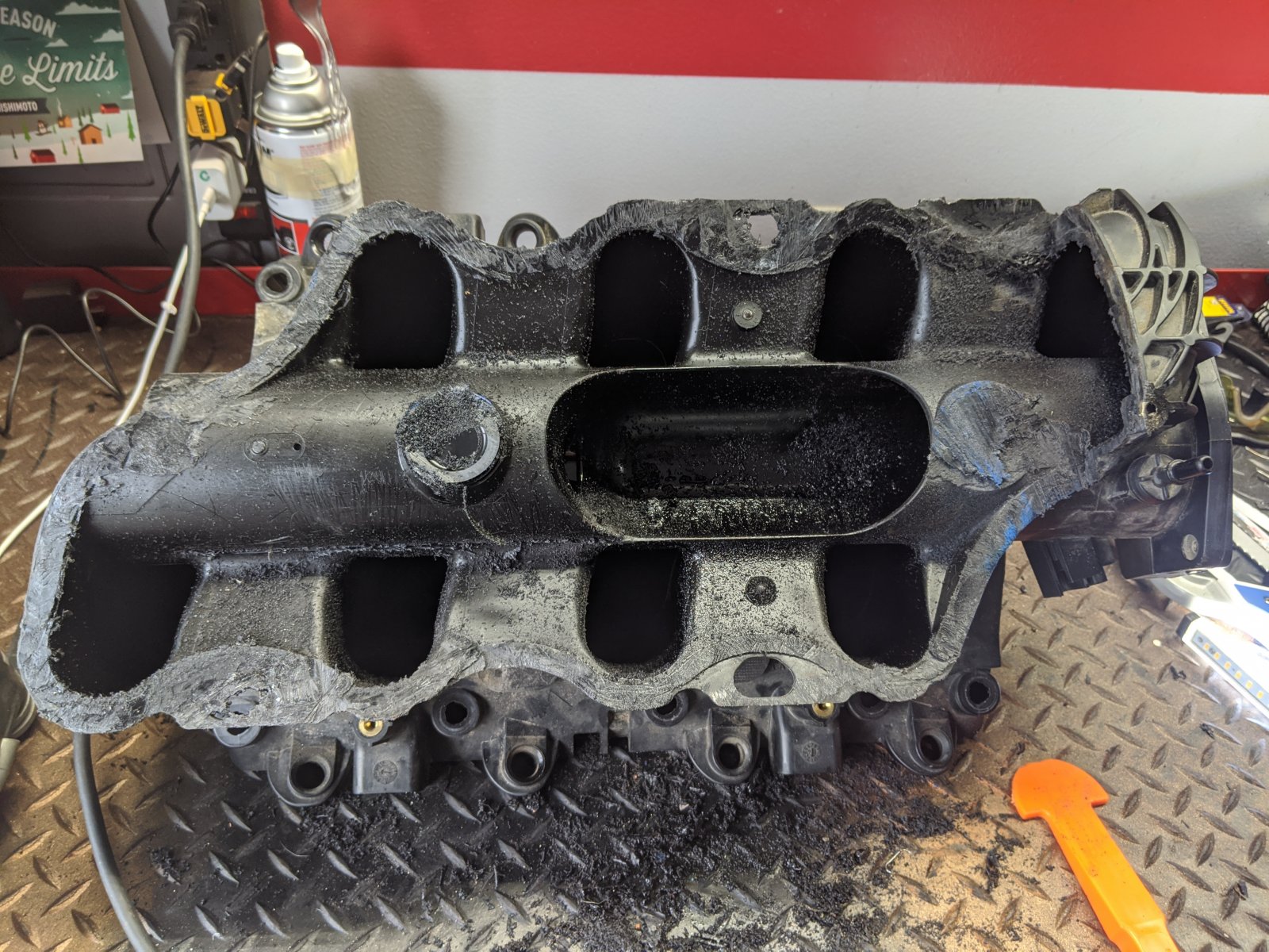

Heres what I looks like with the top cut of, pre and post baffle removal.
There are adapter to go from a 3 bolt throttle body to a 4 bolt, you can also find a pigtail adapter to make them talk too
View attachment 275966 View attachment 275967
That looks pretty scary there.
Is that what you were doing to the LSA blowers? Porting?
Is that what you're gonna to your PPV? 6.0 with LS3 heads and an LSA Blower?
