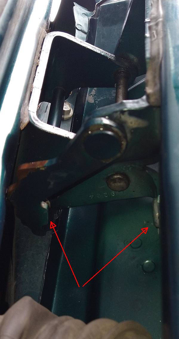

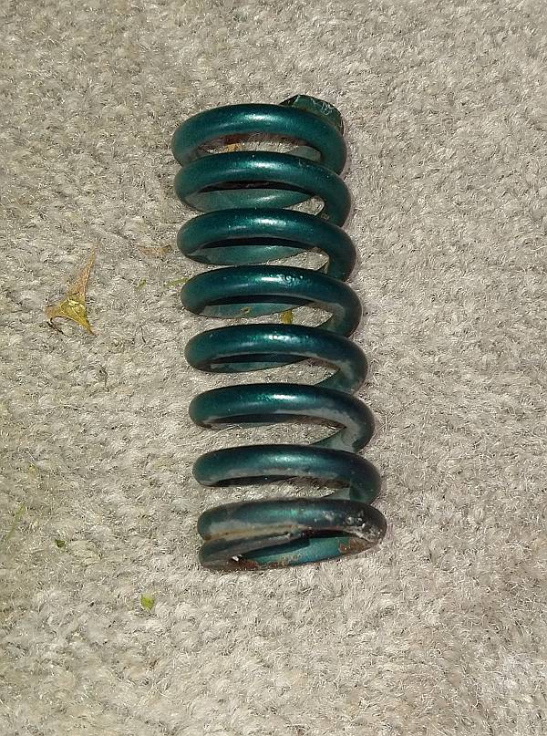

Neither front door will stand open. They both have the springs (found laying below caught by the lower fenders). I can re-locate the springs, but they just fall out again. Almost like another piece is missing.
As noted on the other thread, I need to find out how best to deal with the clear coat.

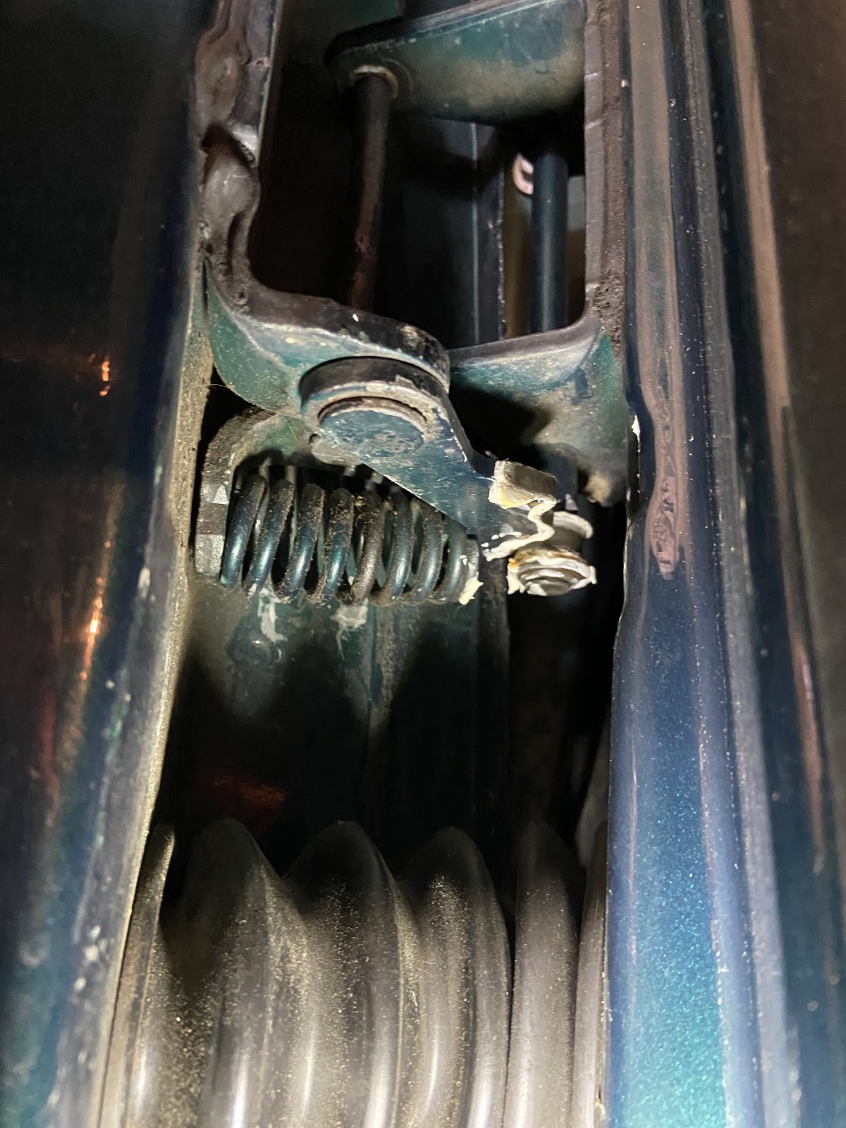

Continuing from my punch list thread. If you don't want a bunch of threads on the same things, let me know. Boards are all different.
View attachment 395082View attachment 395083
The spring fits where your two arrows are pointing. The lever rests against the roller pin.
Compress the spring, set it in place and loosen the tool.

If you look at my picture again, you'll see that roller pin is missing. Just went out to check and it's gone from both sides. Not sure why or how to replace it/them.

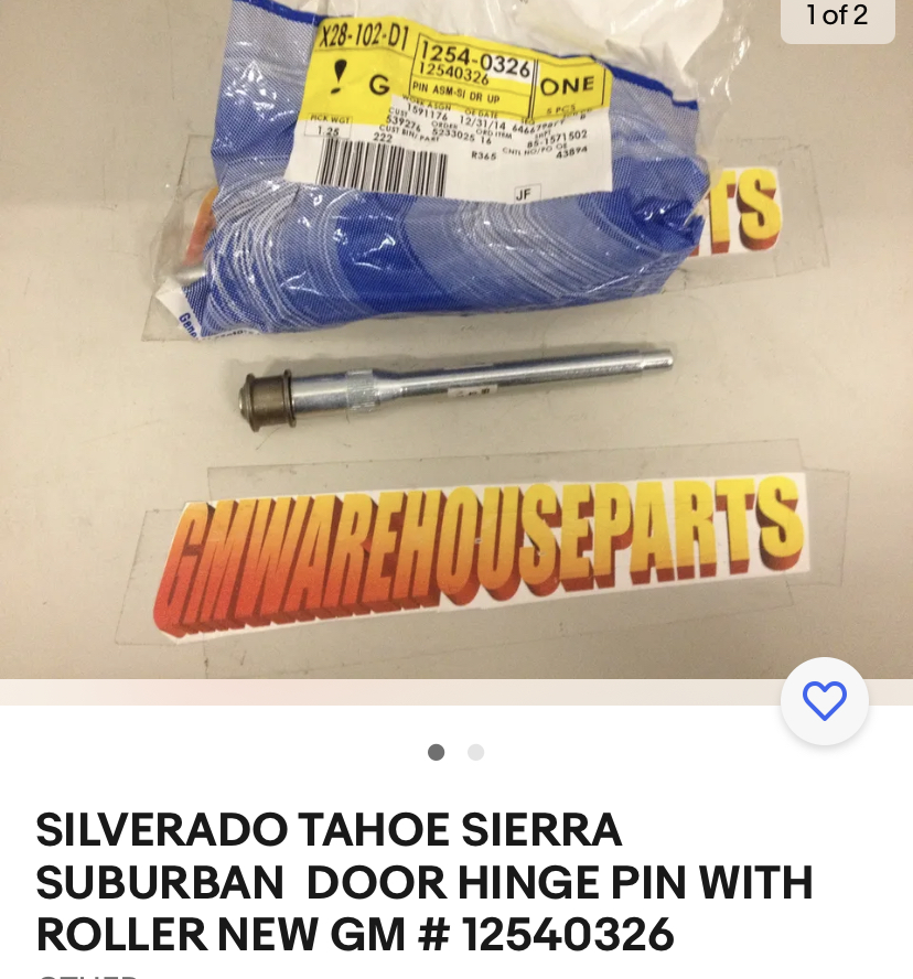

It’s GM part 12540326.
Dorman sells one that is “supposed” to fit but you have to grind down the beveled edge to make it fit. Like many dorman products, just skip the hassle and go with the GM part. It’ll fit just fine, I used one on my son’s truck not long ago. We’ve since sold that truck - else I’d grab you a picture of the new roller.
The top in peened from the factory, so the replacement will need to have a weld stitched on it to hold it in place. Otherwise, it will “walk” down over time. I didn’t try it, but you might be able to cut a thread on the top of it and put a nut on it.
