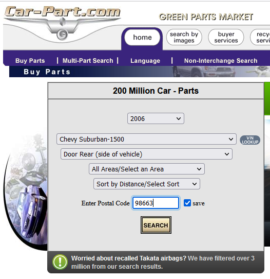

If you search car-part.com using a nearby US zip code, they will show parts at places in BC. They also show interchange choices, so you could see what other models and years use the same door. It would probably be good to verify compatibility somehow with another source, though.

Thanks for the tip ... I tried and it seems to offer interchange choices limited to each brand ... like only other Cadillac options ... if I enter the Escalade EXT, it shows options for an ESV. I'll keep searching though

I searched with this criteria:
After that it asks what tint, etc. I selected a random type and it came up with GMC, Chevy:
Farther down the list:
