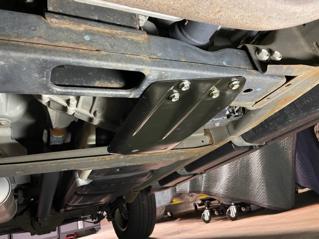

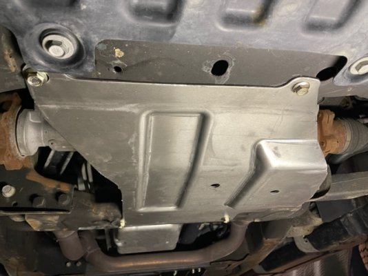

And so the acquisition phase of the project continues. I ordered the 2 skid plates (Amazon of all places) for the front differential (p/n: 20944322) and the transfer case (p/n: 20922755). I'm holding off on purchasing the OEM screws (p/n: 11518341) as I intend to thread the holes with another factory bolt and the acquire the right size/thread pitch bolts from the local hardware rather than overpay on the OEMs.

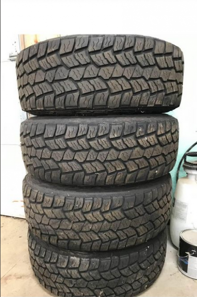

I also picked-up a set of Chevy wheels (with TPMS sensors) and 265/65/18 Mastercraft Courser AXT's for $660 off FB Marketplace. Things are in great shape and while they might 80-90% as capable as the BFGs or similar, I'm OK with paying 25% of the cost of a set of tires alone. I'll take that trade-off any day of the week.

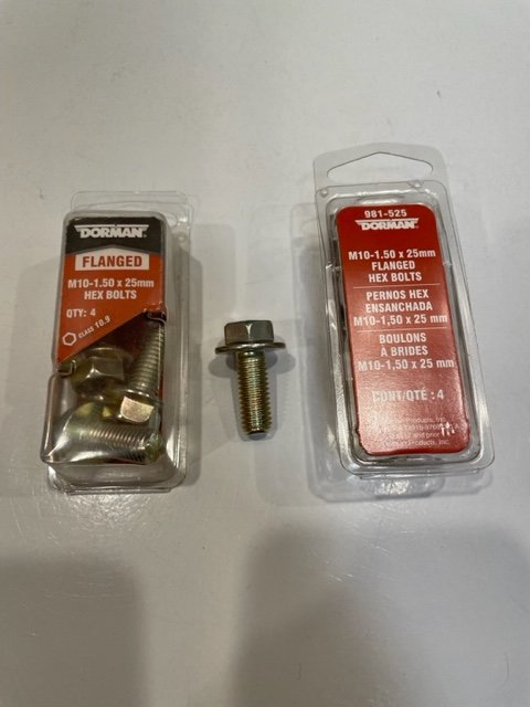

I installed the front differential skid plate (p/n: 20944322) and the transfer case skid plate (p/n: 20922755) this evening. Used one of the OEM fasteners that attached the plastic splash shield which protects the accessory belts (immediately behind the front bumper) to thread the bolt holes (8 in total) for the skid plates. I simply went to my local auto parts store (O'Reilly in my case but I'm sure any of the parts stores would have the same) and picked up two 4-packs of the Dorman M10-1.50 x 25mm Hex Bolts (p/n: 981-525) which cost me less than $10 out the door. Worked like a charm.

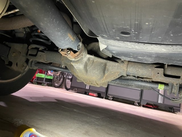

Now that I've installed the two OEM shields I'm wondering if there are any additional skid plate options to protect the following areas:
1) Oil pan & Y-pipe (seems rather exposed)?
2) Replacement for the plastic accessory belt splash shield (honestly the mechanical bits are so high up I'm not sure how much good it would do but if there is such a thing available I'd likely be down for it)?
3) The rear differential? With all the articulation this thing does possibly there is no way to protect it but I thought I'd ask just the same.
