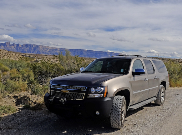

Here is my Tahoe. It has about 3 inches of lift achieved with a combination of Moog HD Springs and 2.5 inch Aluminum spacers front and rear. About 32 inch tires. At 3 inches of lift you'll need to address the front upper ball joint angle, I used a lift style upper control arm and in the pictures you can that my tie rod and lower ball joint are at a bit of an angle but the upper ball joint is pretty straight up and down thanks to the new upper control arm. In the rear for 3 inches of lift the rear axle will come off center so you'll need to address the rear panhard/track bar to center the rear axle. Since my rear shocks I used a shock extender from Rough Country to allow my shocks to articulate freely at 3 inches of lift. Also using extended rear sway bar links to keep the rear sway bar functional. If I were you I would swap to a more traditional spring and shock style suspension to be able to do what you want.

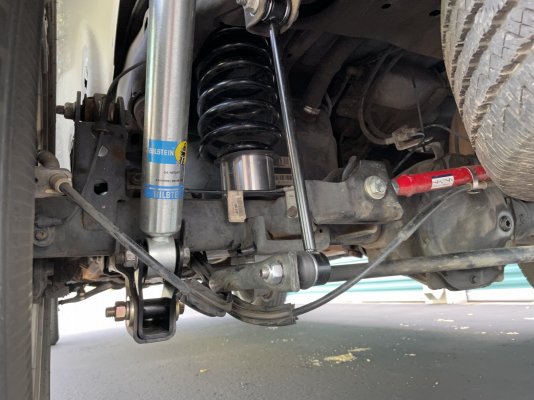

Hi OY. My 2011 Suburban setup is pretty close to Dustin's but there is a difference. I found I didn't need the lift kit with the Bilstein 5100s all around and the Moog 81069 Rear springs as that setup alone gave me a couple of inches of lift front and rear. The 81069s are 2" longer than your stock springs so they should get your rear height about where you want it. The front Bilsteins have adjustable spring perches; I set mine on one notch above the bottom and got a level ride that was 2" taller than stock. Easy peasy and we did not need to worry about the upper ball joint.
I'm guessing the 81069 Moogs are essentially Z71 springs and with the adjustable perches up front, I found no need for a levelling kit. Speaking of Z71, I just ordered the Z71 skid plates and installed them myself. FWIW, I'm running 275/65-18 General Grabber A-TXs (32"-ish) with no clearance issues whatever. Those are 2018 Silverado wheels, btw.
Hope this - and the reference photo - helps.

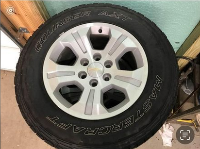

And so the acquisition phase of the project continues. I ordered the 2 skid plates (Amazon of all places) for the front differential (p/n: 20944322) and the transfer case (p/n: 20922755). I'm holding off on purchasing the OEM screws (p/n: 11518341) as I intend to thread the holes with another factory bolt and the acquire the right size/thread pitch bolts from the local hardware rather than overpay on the OEMs.
I also picked-up a set of Chevy wheels (with TPMS sensors) and 265/65/18 Mastercraft Courser AXT's for $660 off FB Marketplace. Things are in great shape and while they might 80-90% as capable as the BFGs or similar, I'm OK with paying 25% of the cost of a set of tires alone. I'll take that trade-off any day of the week.
