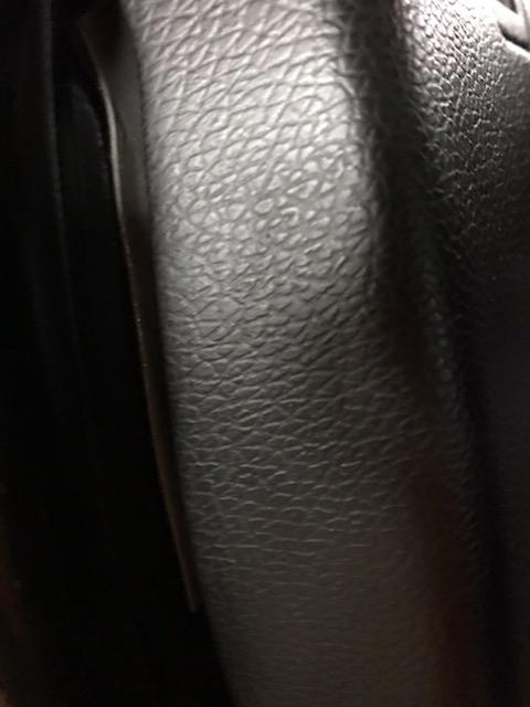

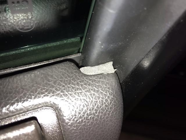

To get started, move across the top of each door trim panel. This belt line door trim panel area was fully reinforced on the GMT 800 trim panels, but due to cost cutting is made flimsy and cheap on the 900's. If your truck is like mine you will likely have 1/4 to 1/2" mouse holes at the front and rear edges where the trim panel meets with the door sheet metal / window. Not good for Squeaks and Rattles. Remove a High density foam square, compress it and push it into each of the mouse holes, adhesive side to the metal. Installing this foam in the mouse holes on both ends of the panel gently pushes the trim panel away from the metal and prevents any itching or resonating of the door panel against the sheet metal.

Next move down around the perimeter of the door trim panel; tapping gently every couple inches to detect any gaps or looseness that manifests in rattles. For small gaps, less than 1 mm use the adhesive felt flocking squares and slide it between the trim panel and the sheet metal. I used a leather-man knife to pull the panel out to fit in the felt. For larger gaps use the 1mm 3M tape, its tricky to do with it being double sided, but the knife blade helps. Press the trim firmly against the tape. Rattle stopped.

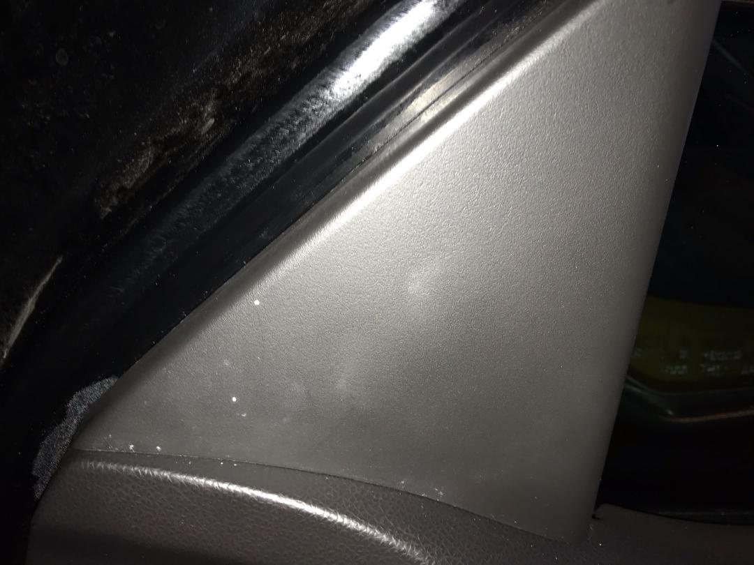

Dont forget to tap around the "shark fins" on both front doors, which was a huge source of a rattle on my passenger door. One of the plastic attachment points for the spring clip had cracked off, so I used some JB weld to repair it and pushed it back on, and put some felt at the corners
