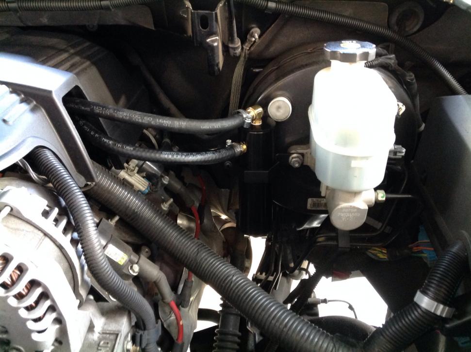

After just replacing my intake gaskets & valve cover gaskets, along with cleaning the TB out I decided to do this too...
Catch can from catchcansdotcom, 3ft 3/8 pcv line from napa, some clamps, & high temp thread sealant...
Just did a full tune up & oil change so we'll see what I collect by next oil change.

What's that can attached to the vacuum booster with the electrical connector? I've never seen that before.
Sent from my iPad using Tapatalk HD
Physh1
Jul 29, 2010
773
27
Vacuum canister for the brakes...some have it some don't.
