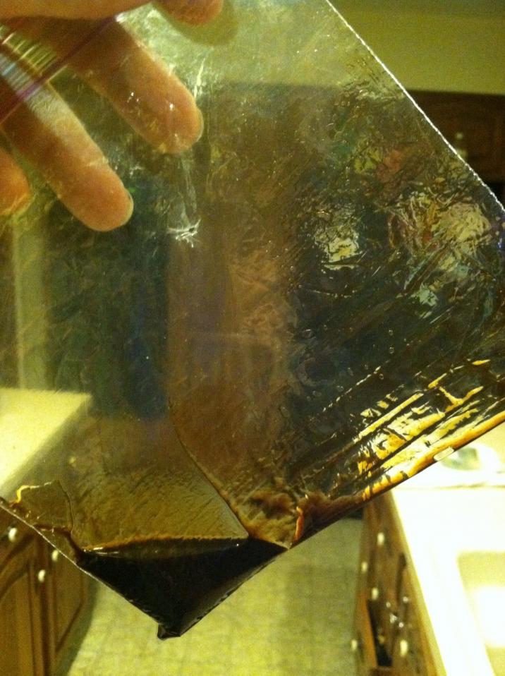

Just drained he can for the first time after an oil change, probably was about 4000miles since installed. Looks like its right around 1 ounce of oil was trapped, well see again in another 6000
Money well spent

One ounce ain't bad after 4K, but when the miles rack up and you have more blow-by then having a CC would be something everyone IMO should consider installing.
Might as well install one sooner than later.
