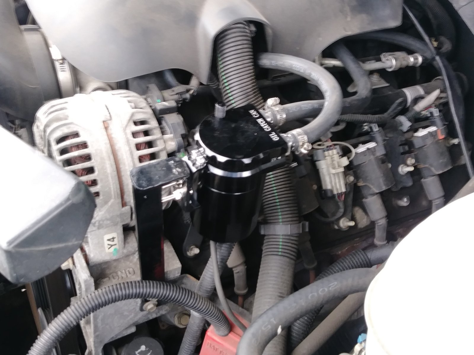

Stock routing is drivers side to intake plenum on top of the plenum, passenger side from throttle body to valve cover
My opinion on your smoke is standing oil accumulated in the intake plenum due to the vacuum pulling on the PCV valve exceeding the valves ability to deflect the oil mist in the blowby efficiently; a common issue on LM7 engines
The fix is to remove the upper plenum & poor the standing oil out it, then reinstall the plenum. Replace the valve cover if your PCV valve is not replaceable and install a sealed catch can inline between the PCV valve and the upper plenum vacuum port
At first the catch can will trap lots of oil so check it & dump it often.
Over time the cylinders will begin to burn off the oil coking that happened before the catch can and your oil control rings will begin to do a better job at regulating cylinder lubrication as your compression rings will begin to seal better which will reduce the blowby some
The amount the catch can traps will reduce over time as the blowby decreases so it won't require dumping as often.
Do not buy a catch can with a vent/filter to atmosphere, you want to retain the "Closed PCV System" that came on the LM7, a sealed catch is nothing but a much larger & more effective PCV valve, these engines need more volume in the PCV valve than the stock valves can handle; especially at higher mileage when the blowby is increasing the oil content in the crankcase vapor/blowby
Good luck!

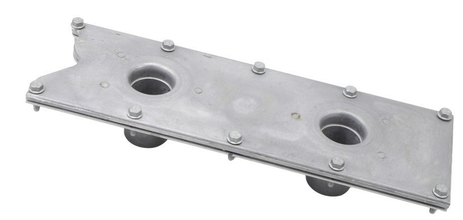

Can anyone provide a link to the updated drivers side valve cover?
My searches have taken me all over the map with wild swings in pricing. $350 USD for one valve cover? Yikes!
