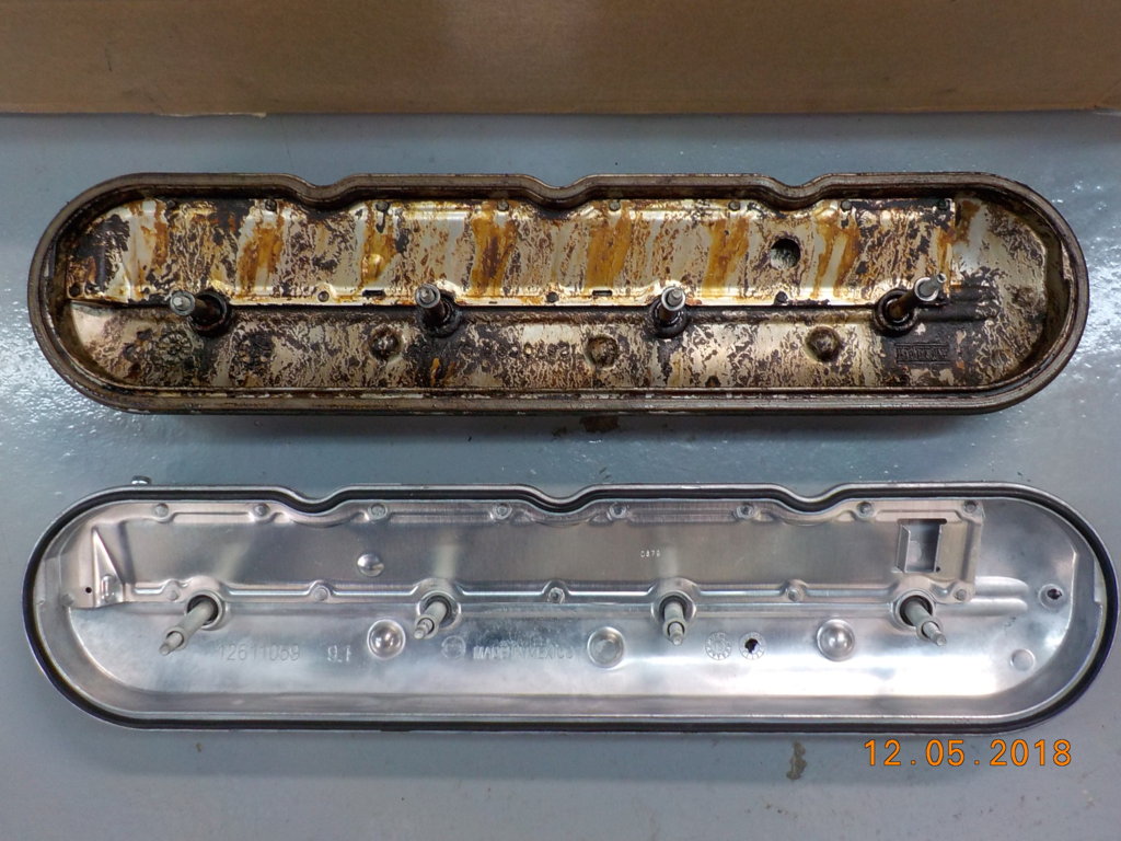

Remove the poorly designed vc, install the improved design vc, NO MATTER WHAT.
There is NO serviceable PCV.
The original poorly designed vc on the inside has a ROUND port located between 2 hold down bolts. The improved vc on the inside has a SQUARE port located above the last hold down bolt.
