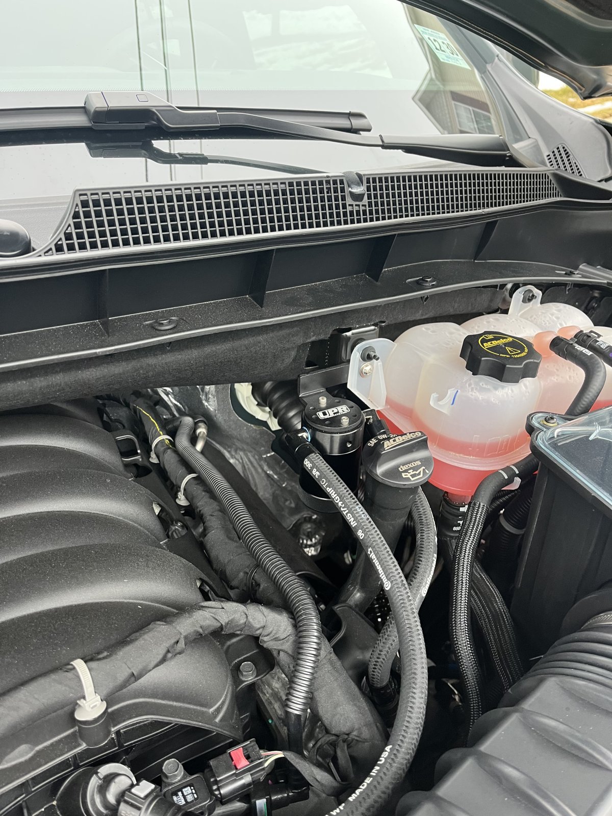

Can you please share a picture of the connection to the motor?. Not sure where the hoses need to go.

I use a J&L (formerly JLT) oil catch can, and it comes with the correct length hoses, plus a great set of instructions for installation.

No noises, I cut the lines as short as possible. I don’t have any pictures of it installed right now.
Really simple to install comes with directions.

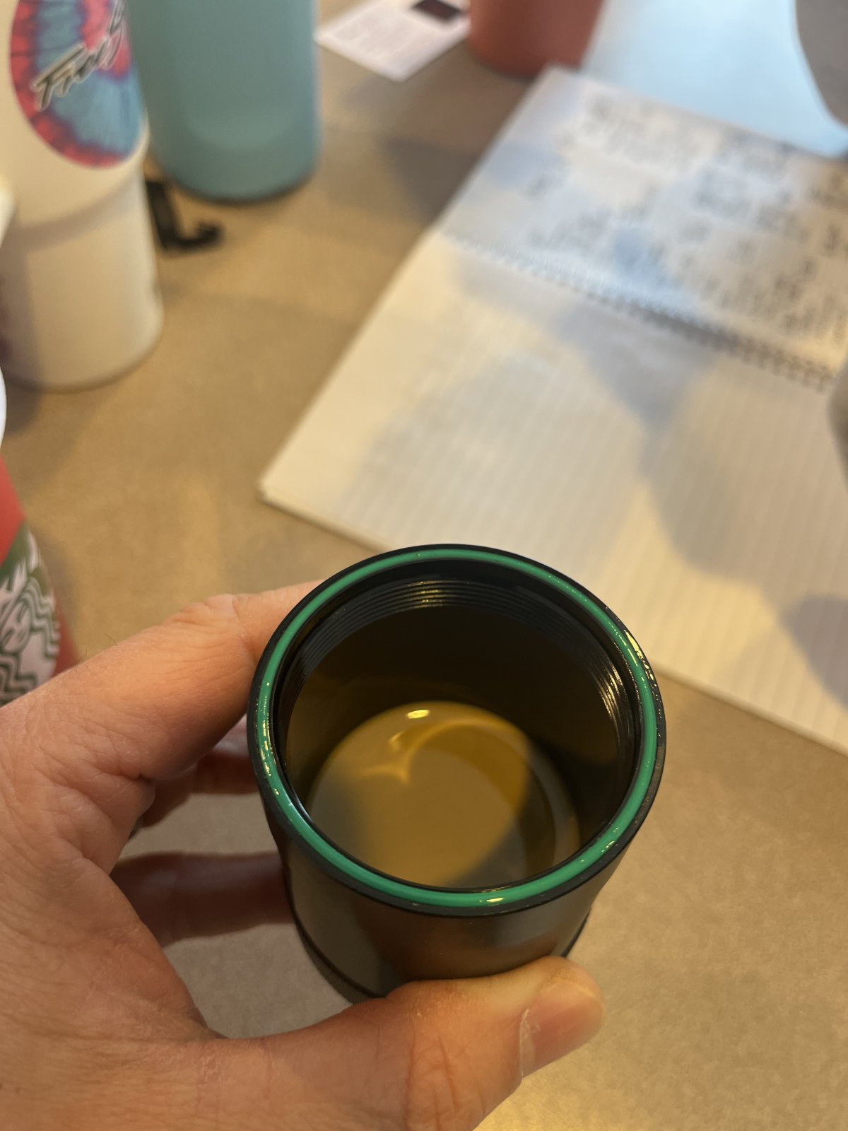

I just emptied mine after 1000 miles on a 2026 6.2L. It caught good amount. I’d say it would be full to the brim at 4-5k miles.
Since there is nothing between the oil and the outlet port, I was always thinkinh that if it is possible for oil to reach the outlet when the vehicle hits bumps and the oil sloshes around violently while the outlet is also pulling?
That would be one hell of a bump, don’t over think it.
Bottom line is if there is any oil in the can it’s oil that didn’t make it into the intake.
If for some crazy reason you hit a speed bump at 60mph and it slosh’s around and a teaspoon of oil gets sucked in who cares. You still captures 16 ounces still left in the can!

No, no. My concern wasn't about not capturing everybit of oil. My concern was that a teaspoon of oil spread over hundreds of miles is ok as vapor without a catch can. But how good is it for the motor/cylinders and intake to take in a whole teaspoon of liquid oil in one or few strokes?
I don’t see that happening. You should be emptying the can before it’s to the brim.
Even if a teaspoon got sucked it at one time it would just be splattered all over the intake and get vaporized into each cylinder. It’s not like you will hydro lock the motor lol
