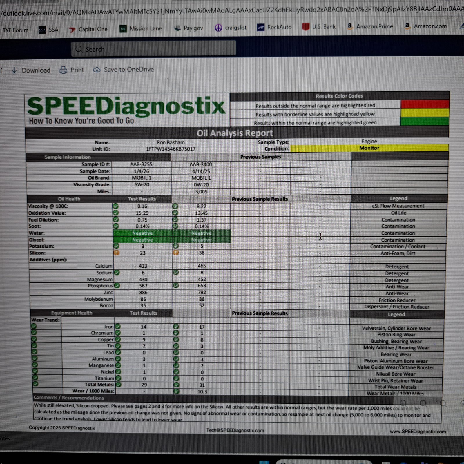

Here is the report on my engine that just came back from Blackstone. Looks ok to me.
  • jan2026blackstonereport.pdf

This is the report you get at Speediagnostix for $50

I believe the Speediagnostix report is now $65. It was $50 at the time of the one I posted here. I could also be wrong about the $65 and you should do your own research. Still a very detailed and concise report for $65, though.
