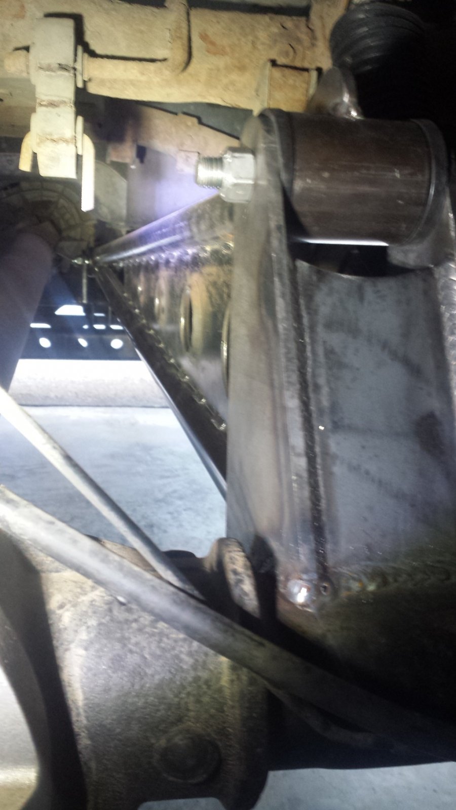

-Off road design shackle style traction bar (Absolutely no axle wrap)
-Modified Atomic coil-over swap with 6in travel FOX 2.0 coil-overs with resis on 600lb springs.

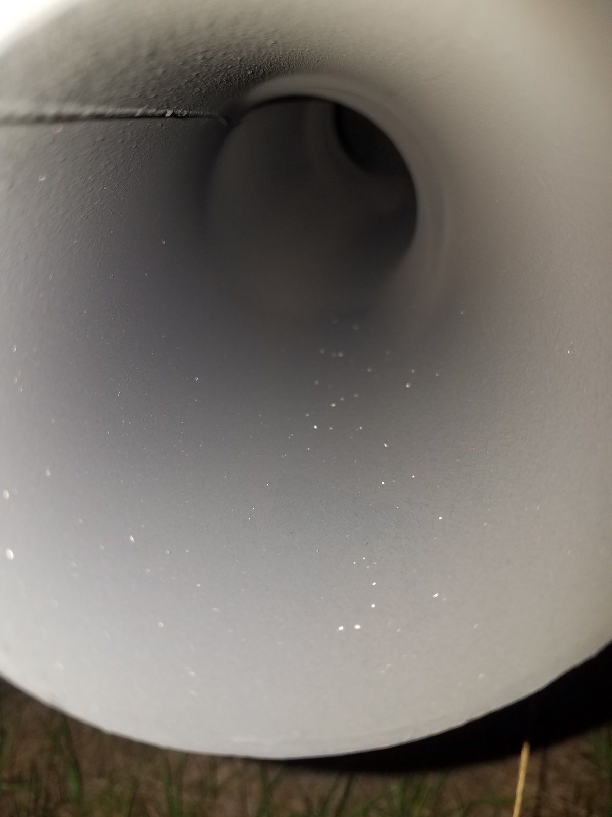

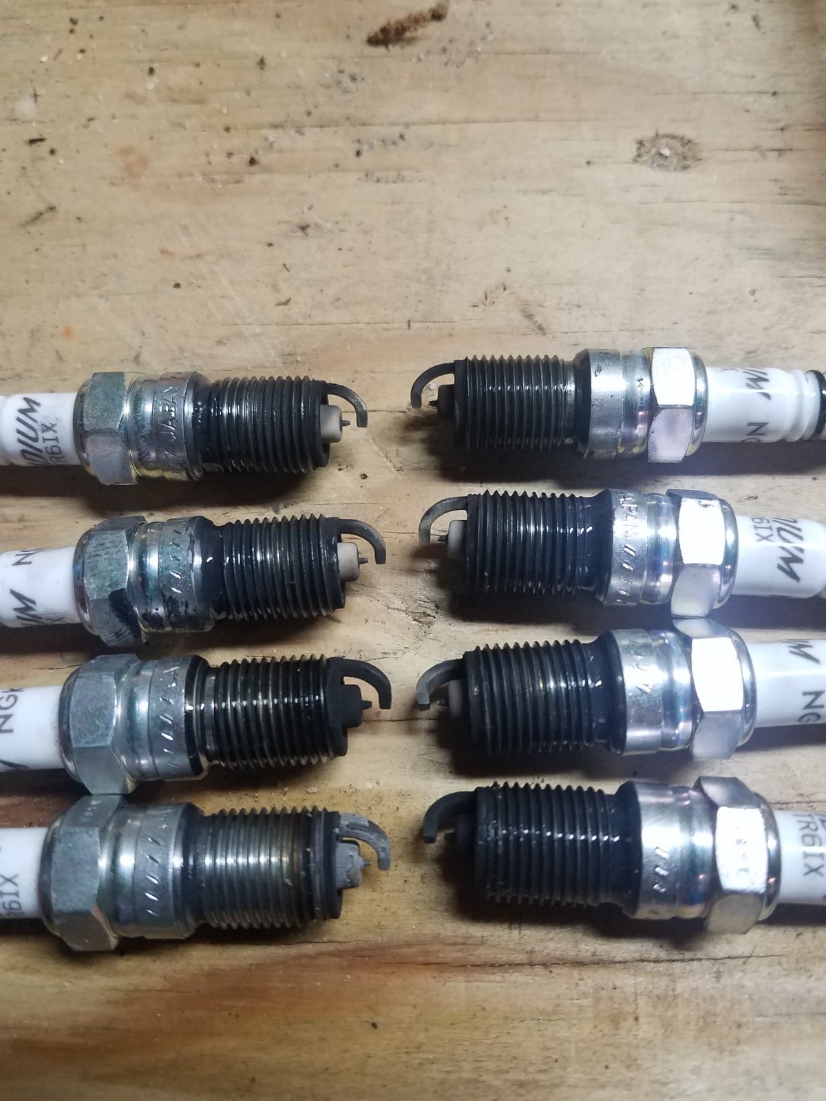

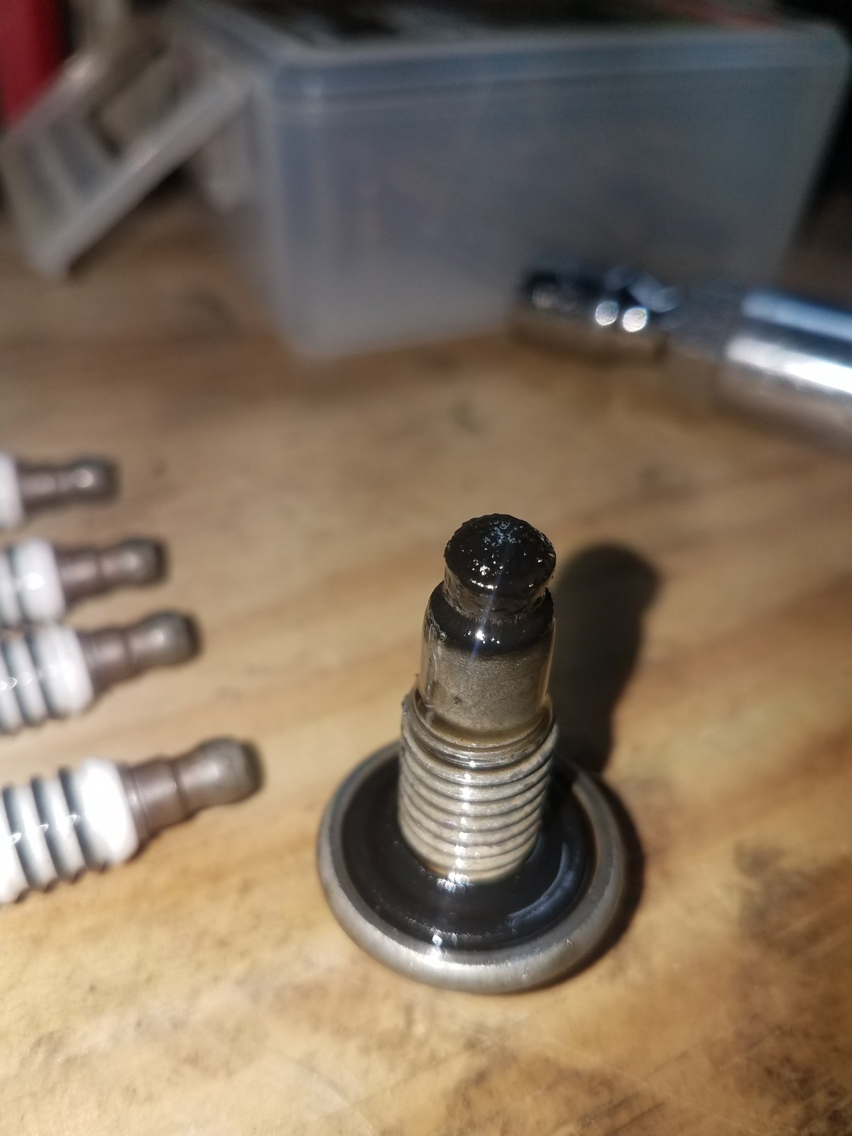

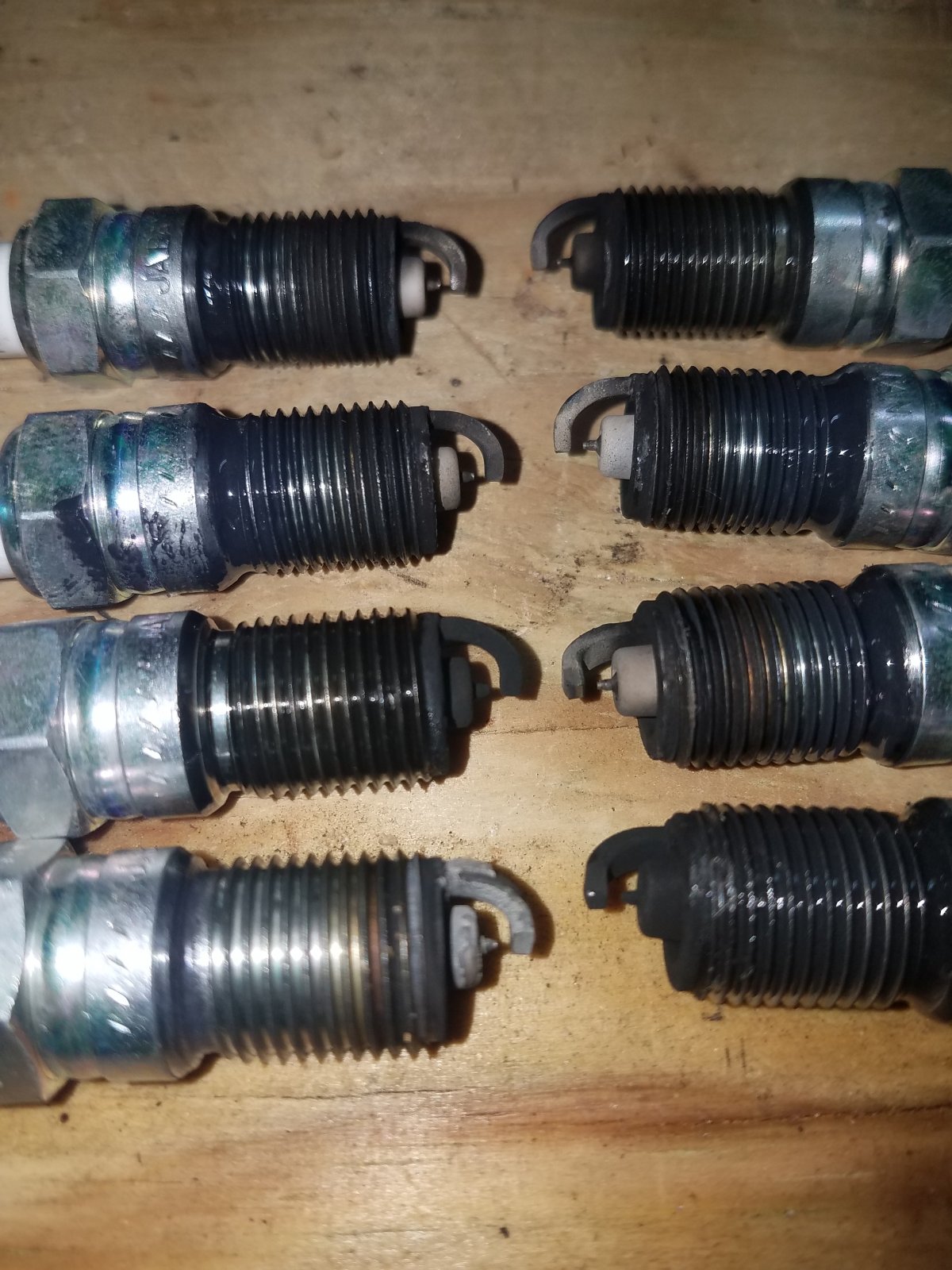

Reason for the leak down was I'm still seeing some minor smoke out the exhaust during throttle. Mostly seen with the cutout closed which leads me to think the giant OEM muffler mounted under the bed is chuck full of oil from when the head gasket failed and I drove it home 20 miles. However when I pulled the plugs #7 plug had a little bit of oil on it and the top of the piston had a little oil. I wonder if the valve guide seal wore out prematurely.
First picture is what the majority of the plugs looked like.
Second and third picture are from the wet #7
Also the threads are wet looking from anti seize.

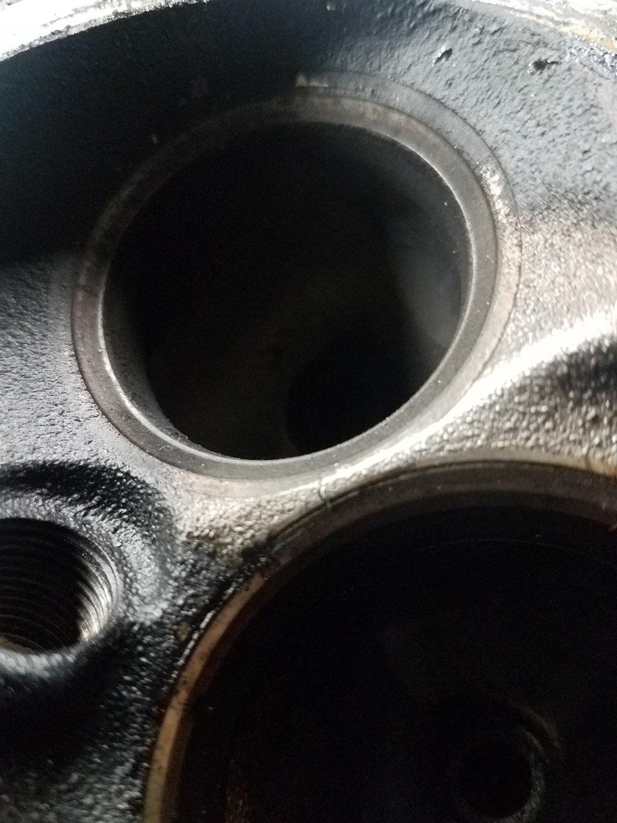

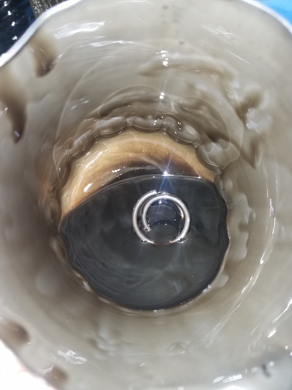

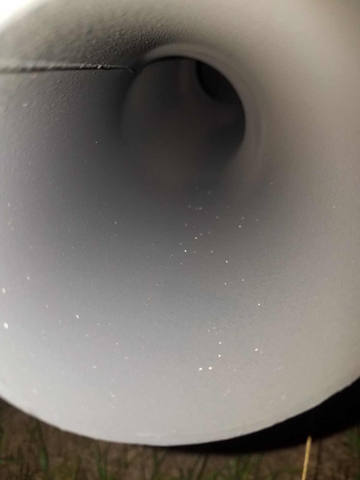

So pulled spark plugs, drained oil and borescoped the cylinders. Good news is there's no catastrophic damage and I believe the heads are completely unharmed (Thank you sweet baby southern born alligator riding Jesus!). Pistons looked totally normal during the scope and plugs weren't blown in half like I sorta assumed. Oil even looked okay. No crazy unicorn blood, no chunks and the drain plug had a weak afro. I'm leaning towards a bearing went or maybe timing chain also there's no signs of metal damage in any cylinders so maybe the previous picture of sparkle in the exhaust pipe was sand and not metal. Or possibly pieces of the muffler as its pretty old.
33,344
51,833
Thank you! I wish I wasn't limited to 5 pictures per post but I did my best. I find a build thread is a good way to keep track of things you did and lessons learned.
View attachment 245218 View attachment 245219 View attachment 245220 View attachment 245221
Few cylinders burning rich?
AFRs have been good but it's been burning oil since first put together. Strange that last week when I did the leak down test #7 was visibly wet and today its dry. Several cylinders have substantially more carbon deposits on the top of the piston which is likely due to burning oil but the question is WHERE IS THE GOSH DERN OIL COMING FROOMMMMM!!!!!!

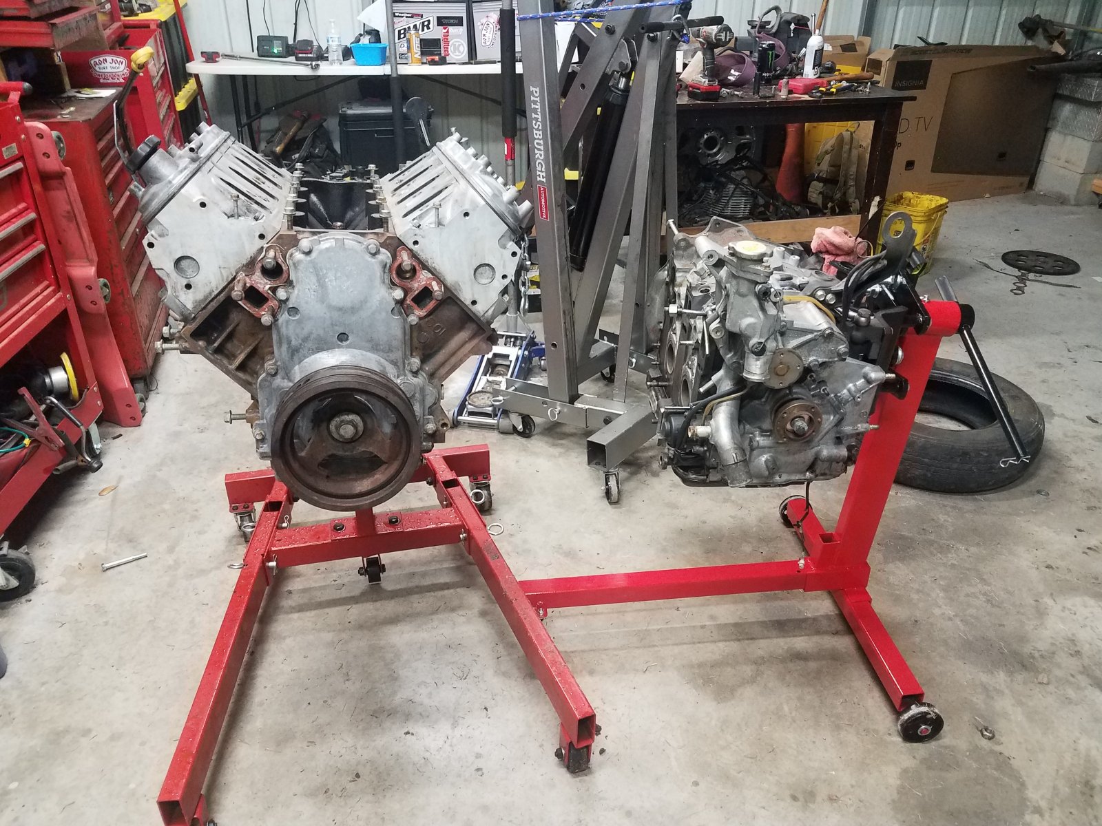

Seriously considering sending both thos motor and the 4.8 to TSP and telling them to build me something with a warranty lol.

One thing for sure- something’s up! Waiting to see what you find. Could be a number of thing obviously. Best to keep that sense of humor, it comes in handy in times like this.
Hopefully this week I can get the blower and heads off to see more.
One thing that's bothered me since before I installed the motor is this.
When I bought the motor it had a spun cam bearing and on both heads on every cylinder between the 2 valves was a crack indicating the motor got nuclear hot. I had the block "fully machined" but just a few weeks after I paid and picked up my parts the shop closed indefinitely and the owner moved out of state. He seemed like a great guy and I'm not blaming him for anything especially since I don't know the true cause yet. However I can't help but think maybe the one particular cam bearing needed to be oversized and wasn't or a cylinder or 2 was never honed correctly and is out of round at one point causing oil consumption.
More than likely I assembled something wrong and when I get to the bottom of it I will learn from my mistake. Wish education wasn't so expensive.
