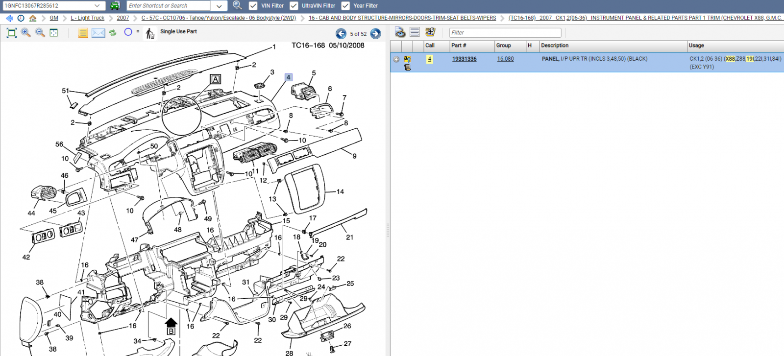

Question for those that might be able to help. Esp other 2007 Tahoe owners though year model may not be that significant.
BLUF: I've ordered a new dash and now its on back order. Has been since Aug 12th.
Ordered from a GM Dealer in Florida (https://www.gmpartsnow.com) as they had a 50% off shipping deal that cut the cost of the dash, shipped to me, down to about $530. My question is around Part Numbers. Usually anytime I want to find a PN for something on the truck I goto gmpartsdirect.com. Maybe that's part of the problem so let me know but according to them the PN for the dash in my truck is 23224747. As recommended here, I did a search on that PN, found the best deal and ordered it.
The same day I ordered it, a person from gmpartsnow.com contacted me asking to confirm the VIN of my truck. I sent it to him and emails me back saying that part number is incorrect for my VIN and says I need to order PN:19331336. He also sent me a copy of the exploded parts diagram he was looking at just to confirm the part I was trying to order was the full replacement dash (attached). I confirmed it with him and told him to go ahead and so that is now the PN that is on back order.
What's weird to me is that when I called my local Chevy dealership here in San Antonio they told me the same thing. I gave them PN:23224747 and the told me their computer system told them PN:19331336 was correct. And of course while they had two in stock for PN:23224747 they had none on hand for PN:19331336. I had asked them to price PN:23224747 for me anyway and they quoted me about $750 or so which was almost double what I was seeing elsewhere for that same part number. Most dealerships were quoting that part number at ~$430 without shipping so I passed.
So my question is, why are these dealerships finding a different part number for my VIN than the PN I got from GMPartsdirect.com. When I originally looked up the part there, I used both the make/model search AND the VIN search and both led me to PN:23224747. Is it possible that PN:19331336 is the original Part Number for the original "Bad design" and PN:23224747 is the newer version with corrected reinforcements? It seems odd to me that PN:23224747 seems to be readily available whereas no one has PN:19331336 in stock (I say that with the caveat that I have not really tried to call around yet to see if anyone has that PN, I just know that my local dealer did not have it nor does the one in Florida, and they're being told by GM its on backorder).
Thoughts?

Looking at GMpartsdirect.com currently has P/N:23224747 for $398 however shows as not fitting SSV/PPV models. I used my Tahoe and it said it does not fit but if I change to a 2013 LS-fits. If you look at the fitment for that part-says it will fit 2007-2014 Hybrid, LS, LT, LTZ models. I would be interested in replacing my SSV's dash as well-anyone know what the significant difference is BTW the SSV and LS/LT/LTZ???
No difference, the PPV doesn't have a special dash. There's only a few parts differences for the PPV's (brakes, suspension etc} and the dash isn't one of them AFAIK. I've never seen a special dash part number.

I think the difference is the LTZ have a center speaker, while all others do not have one. Even the LTZ Silverado does not have a center speaker.
52,954
I had Rene @915_Tahoe look up both those p/n's and neither have the center speaker. I looked and all trim levels use the same dash. I believe it's Yukon's that have the center speaker but I'm not sure. Any of you guys have a NNBS Tahoe with center speaker?
My 09 LTZ Tahoe has a center speaker, and I have dash cracks by the air bag.
52,954
I just looked at the dash for yours and GMpartsnow let’s me choose the LTZ trim but when I look at the parts list, it only shows 23224747 in ebony and states “except LTZ” and one of my other parts lookup sites, gmpartsgiant, doesn’t let you choose trim levels but it shows 2 different part numbers in black not Ebony even though the black interior IS Ebony and guess what? It’s 19331336 but also 19331331 depending on RPO’s. The 19331331 must be center speaker. Confusing. And we all know the 19331336 isn’t available. Nothing on that website about 23224747.
Well I don't think that's right (about the center speaker). My 07 LTZ does not have a center speaker and if you look at the exploded parts diagram I posted above, the same on gmpartsnow used, it doesn't show a center speaker either.
Hope your new dash shows up today because if its correct for an ebony LTZ Tahoe I will change my order today. I'm going on 4 weeks of waiting for my dash and of course they charged my cc the day I ordered it. Post a pic or two if you wouldn't mind. It would be great to get verified pics of both dashes so we can figure out why there are two different PNs.
