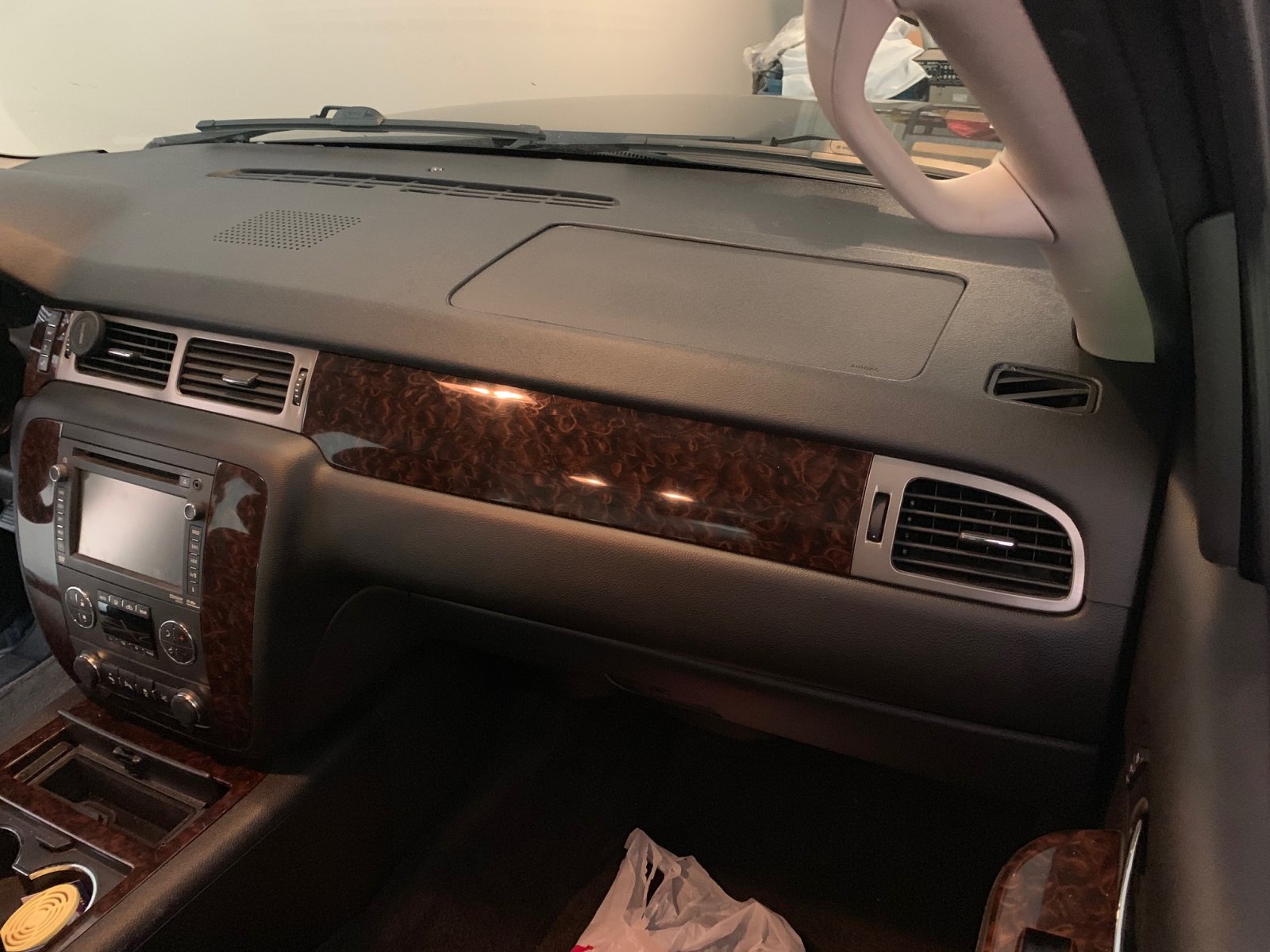

I recently purchased 2010 Tahoe LST with badly cracked dash. I replaced both the dash and front panel myself, and I have moderate skills in these things. There is a great video on YouTube that can get you through it. Just take your time and it will look so much better than the overlay.

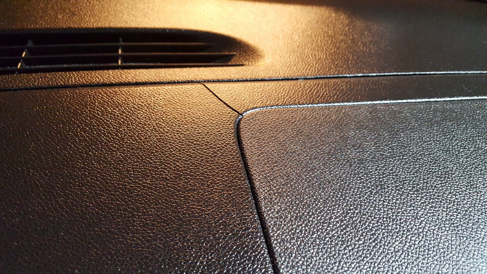

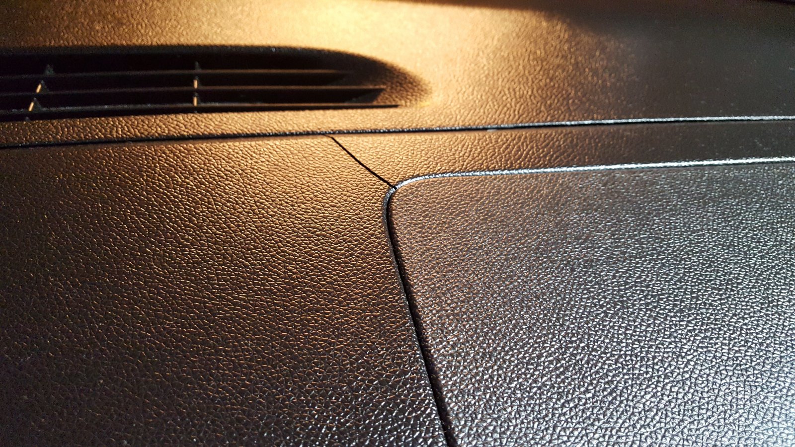

I started out with the crack you described on the passenger side by the air bag, that was 3 years ago. I decided to live with it and here we are today , it has grown a bit. I am still not inclined to do anything about it. I know one thing, I am not going to take it in for the air bag recall. Hell no. I am hoping a good alternative comes along pretty soon, because I love my **.
