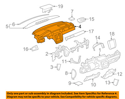

I recently purchased 2010 Tahoe LST with badly cracked dash. I replaced both the dash and front panel myself, and I have moderate skills in these things. There is a great video on YouTube that can get you through it. Just take your time and it will look so much better than the overlay.

I might be in a situation where I have no choice but to buy a new dash even though I already have a dash skin cap. My dash is so badly damaged due to both the cracking and multiple instrument cluster swaps (long story) that the mounting points for the Cluster Bezel (two mounting posts + clips for the two screws that go through the bezel) are basically destroyed. If I cap it as-is the cluster bezel will just be mounted loose though I may be able to glue it to the cap as well (not sure).
Who sells the "new reinforced dashes" and how much do they cost on average? I found an OEM New Ebony Black dash panel on ebay from a seller up around Dallas that wants $880 (shipping included).
Then I found that gmpartsdirect has them for $400 (shipping not included). Are these what you'd consider the updated, reinforced version?

Yes, the new parts from GM are the updated design. I just took the part number and did a Google search to find the cheapest price shipping figured in. It ended up being a GM dealer on EBay. The dealer sites are a PIA because you need to add it to your cart and enter your address before you get a shipping cost. Most of those same dealers advertise on Ebay where they're forced to show shipping charges. The box the dash comes in is huge- like 6' long, 2' wide and 4' tall. It's not the weight that costs a lot to ship, it's the size.
Thanks!! I'm prob just going to order the new dash then. This ebay seller has a used one out of an 07-8 Avalanche for $475 (flat rate shipping included) but GMPARTSDIRECT wants $248 shipping so I'm looking at $650 for a brand new dash.
VERY glad to hear they updated the design. I remember when I looked at this years ago (before my dash was in such bad shape - back then it just had a couple of sizeable cracks - should have capped it then) I got a lot of feedback from other owners not to bother because the new dash would just crack again eventually. I think one poster said he did install a brand new dash and it cracked again only 3 days later.

Good point. Old design, might crack. Yeah definitely just going to get a new one. I shopped it around as you recommended. Cheapest so far with shipping is $539. Weird, its a dealer in Florida. A Dallas GM dealer has one and their a lot closer to me but they wanted $575 with shipping. Might be worth the $35 for a shorter overall shipping route. Less opportunity for it to get damaged in transit.
